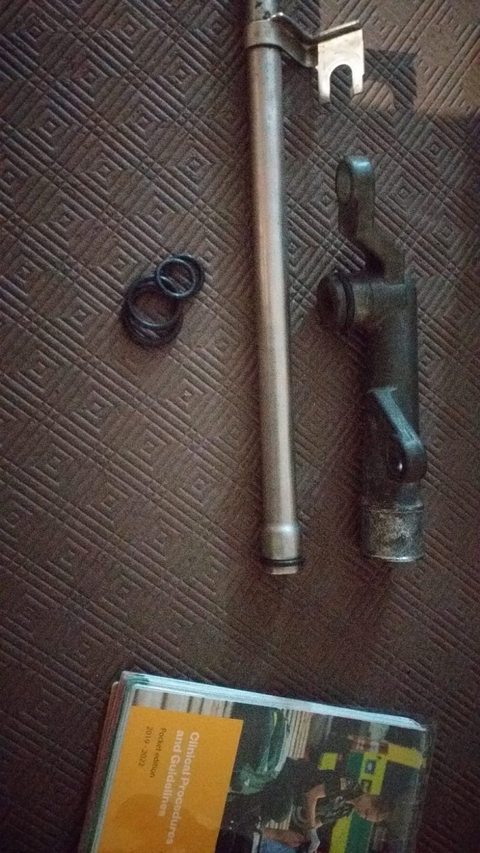

Sorted the O rings for the cooling system fittings today whilst I had a bit of down time at work with a few spares.
The plan is to sort through all our old imperial cap screw stocks and see if we have enough to make up a new set of head bolts.- psyolent
