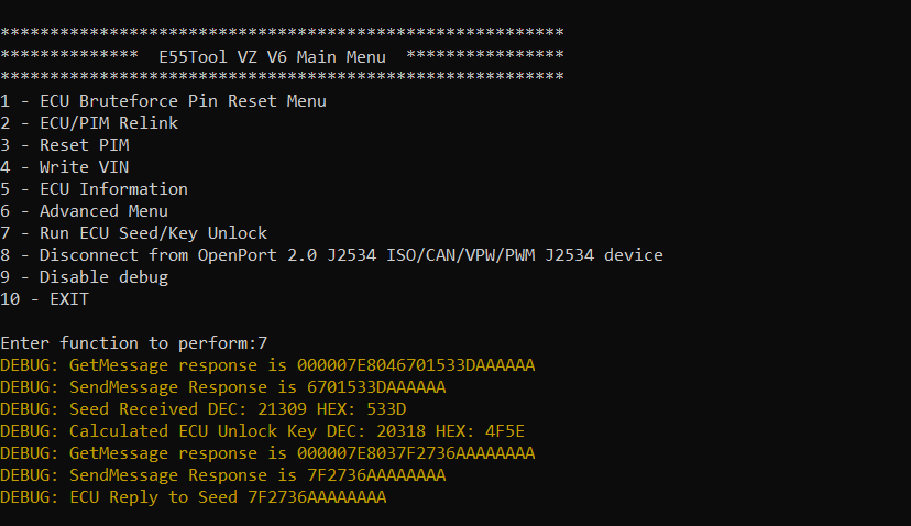

I have another screenshot from the E55 tool. Here I get a response from the ECU.
2021-05-22 10_58_55-C__Users_marco_OneDrive_Desktop_E55Tool-VZ.exe.png (23.95 KiB) Viewed 7550 times

Marcohdh, I saw that you used the E55 tool and it worked for you, which bugs the crap out of me since I helped very slightly with that program with connecting to the J2534 devices and he used some of my code.. My program should work, but it doesn't.. :comp:
The E55 code does connect slightly differently so i changed my code to connect the same way, I added more debug(again) and I also moved the getting Vin to a separate command, that's a multiline reponse and maybe I am not handling ti correctly and screwing everything up after that?
I also noticed he is sending all 12 bytes even of the last 6 are empty, I haven't been doing that, haven't had a problem except for when I am writing calibraiton files to the ecu, well until now anyways.. I resolved that as well..
Hopefully you get something of a response now, have not tested this version on a vehicle yet, the other versions bench tested fine for me on an E38 and E78 and E92, your working with an E67, should be the same as an E38(I think) a far as talking to it??
anyways, thanks for being the guniea pig, good luck..
