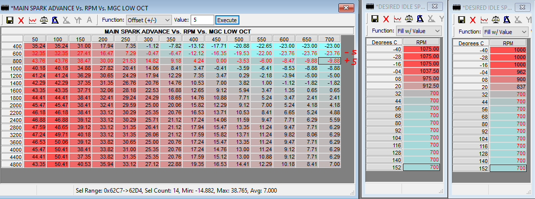

I've had a US bloke explains his lump tune, I haven't been learning much about spark advance and hoping someone could look over the image for me?
"You need to change the idle target around the operating temp. Easier to do with a 180 thermostat like I have because that falls between targets. So you set them 75rpms apart. Idk how well it will work if you don’t have a 180. Then you have to log your idle and find the cylinder mass it’s sitting in. Then adjust the spark tables to jump between 10 degrees. I took 5 out on one load section and added 5 on the one next to it. Also you will need to 0 out the knock retard which is why I actually didn’t keep this tune. The KR readjusts the idle spark to keep it normal when jumping between cylinder mass. It’s great for show, but I wouldn’t run with it."

Re: Help Creating My Very Own Lump Tune
Whilst I have never had the need to do this, I do believe that it is done via ignition timing error, you look to be on the right track :thumbup:
