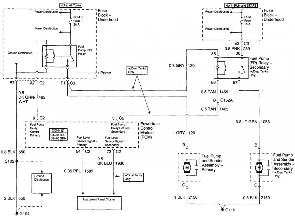

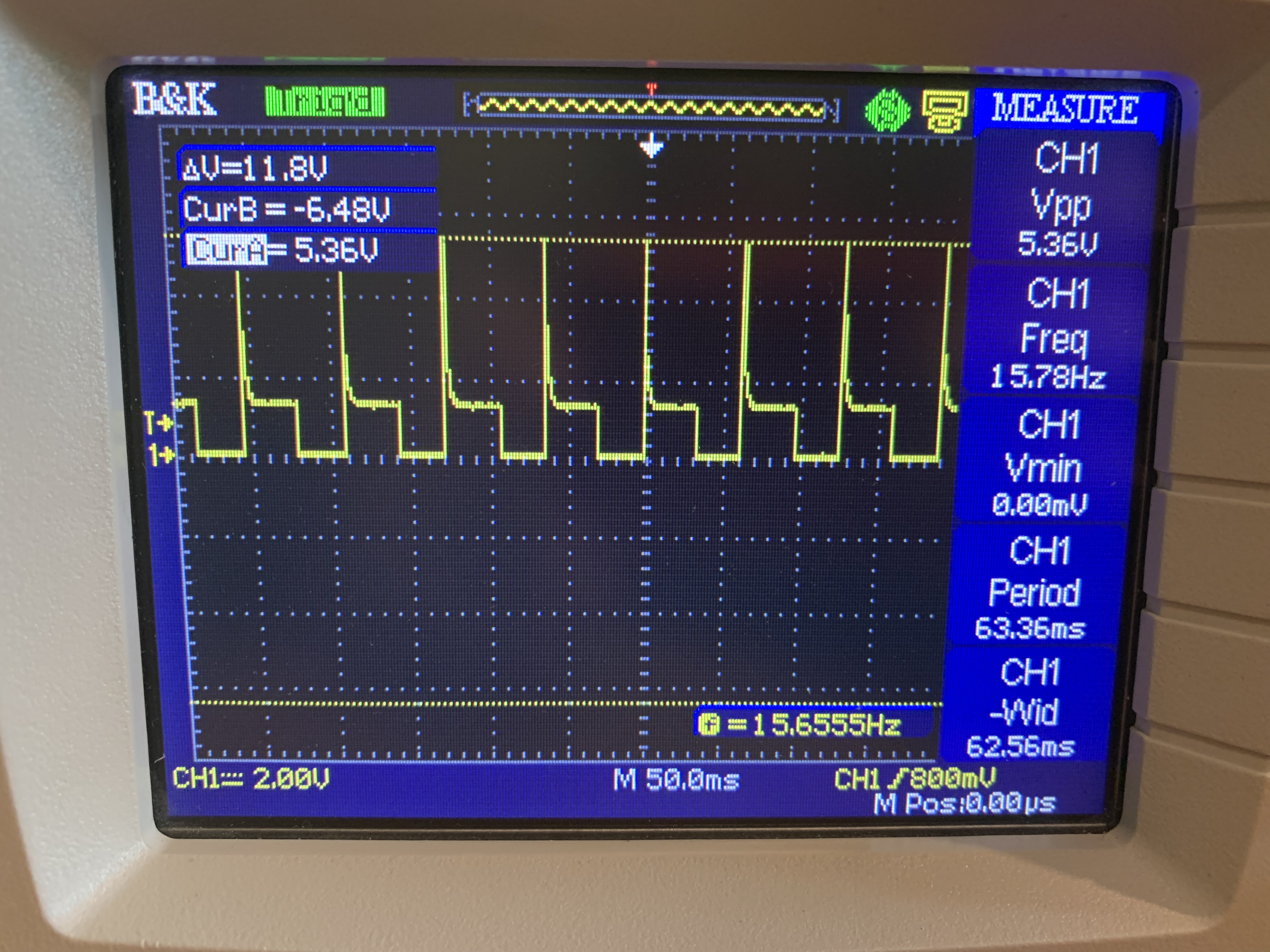

I got back into it today and I think it's working.
The part I'm not sure about is the circuit/wiring. I wired one side of an evap solenoid to my power supply (~13.0 Volts) and the other side to C2 - Pin 3 which based on the wiring diagram below it should ground the solenoid. The EVAP solenoid was pulsing like I would expect, but I've never created a circuit like this before. I'm hoping that it looks like a good signal as I don't really know what I'm looking for. I modified the OS to control the fuel pump output in place of the EGR output. So I was able to command an EGR position to turn on the solenoid. Attached is a picture of my scope screen showing a 15 Hz signal, but I also tested 50 Hz and it looked similar so anything in-between should work. I connected the scope probe to the PCM side of the solenoid and the low reference to the power supply negative. A quick google shows me that for Part# 35A-AAA-DDBA-1BA its 5.4 Watts @ 12 Volts therefore:
I = P / V
5.4 Watts / 12 Volts = 0.450 Amps
R = V / I
12 Volts / 0.450 Amps = 26.67Ω
So having a 22 Ohm Evap solenoid on the bench should be a fairly close stand in.
I = P / V
R = V / I
Re: LS1 Boost OS - Development
I'm not sure I follow... You tweaked the EGR code so that it ends up toggling the fuel pump relay control line instead of the EGR line - is that right?
Does the duty cycle vary with the commanded EGR position?
It looks like there's a PID loop (or at least a PI loop) in the existing EGR code. If so, then it might be possible to leverage that for boost control. You "just" have to get it to look at current MAP and desired MAP instead of current EGR valve position and desired EGR valve position. Not sure how hard/easy that would be, but it's worth investigating. If it's just a matter of pointing the existing code at two different locations in RAM, that would be amazing.

Yes, that's exactly what I did.NSFW wrote:I'm not sure I follow... You tweaked the EGR code so that it ends up toggling the fuel pump relay control line instead of the EGR line - is that right?
Yes there is a loop. I was just adjusting EGR position to get the duty cycle to vary. This was all just for bench testing so I didn't have to write code to see if it worked. I have thought about reusing the PID loop code from the EGR, but that would be a ton of work and maybe more than writing one from scratch. I may take a deeper look at it before deciding.NSFW wrote: Does the duty cycle vary with the commanded EGR position?
