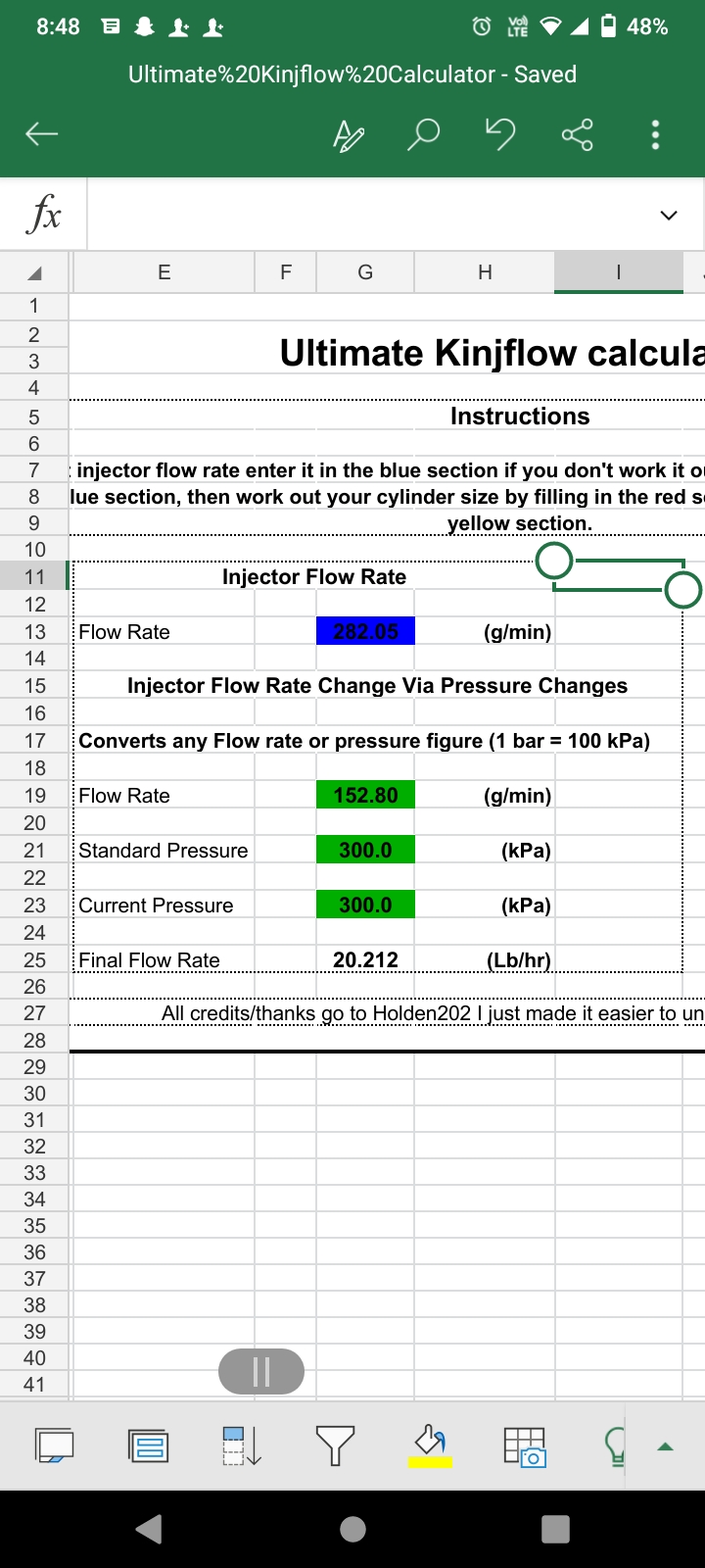

Hey everyone, I've got a VY Ecotec and I've just installed a set of L67 S/C injectors on my my stock L36. Just wondering what changes would need to be made on the1's enhanced tune for them to run smoothly. Would it be easier running the VY s/C tune? Thought I might better mention I'm running a turbo setup aswell with around 5-6 pounds boost at the moment.

Okay so unfortunately I did try to flash the vy SC bin at first which did brick the pcm. I wish I posted to this group before I did that.
Also how would I put these numbers into my tune? Bit of noob I apologize but any help is muchly appreciated

open up any L67 bin and xdf and copy out the base injector rate and battery offset tables and put them in your tune.
