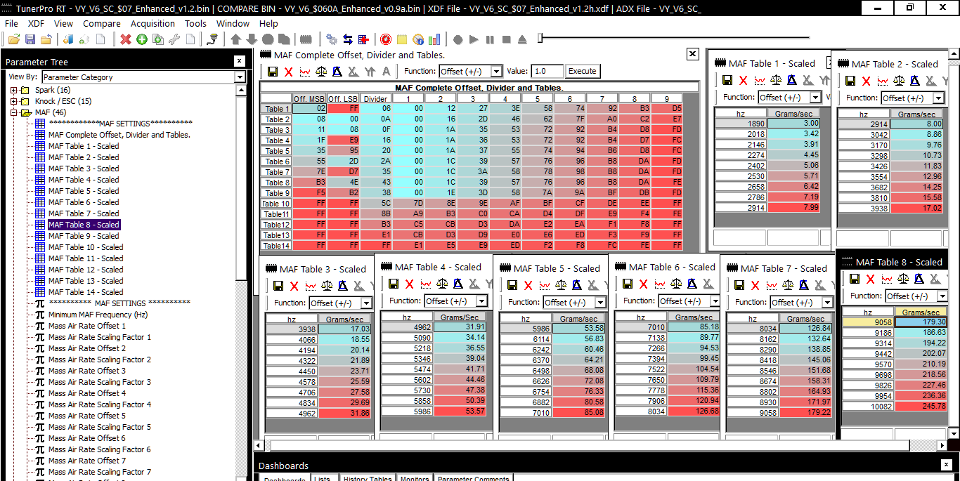

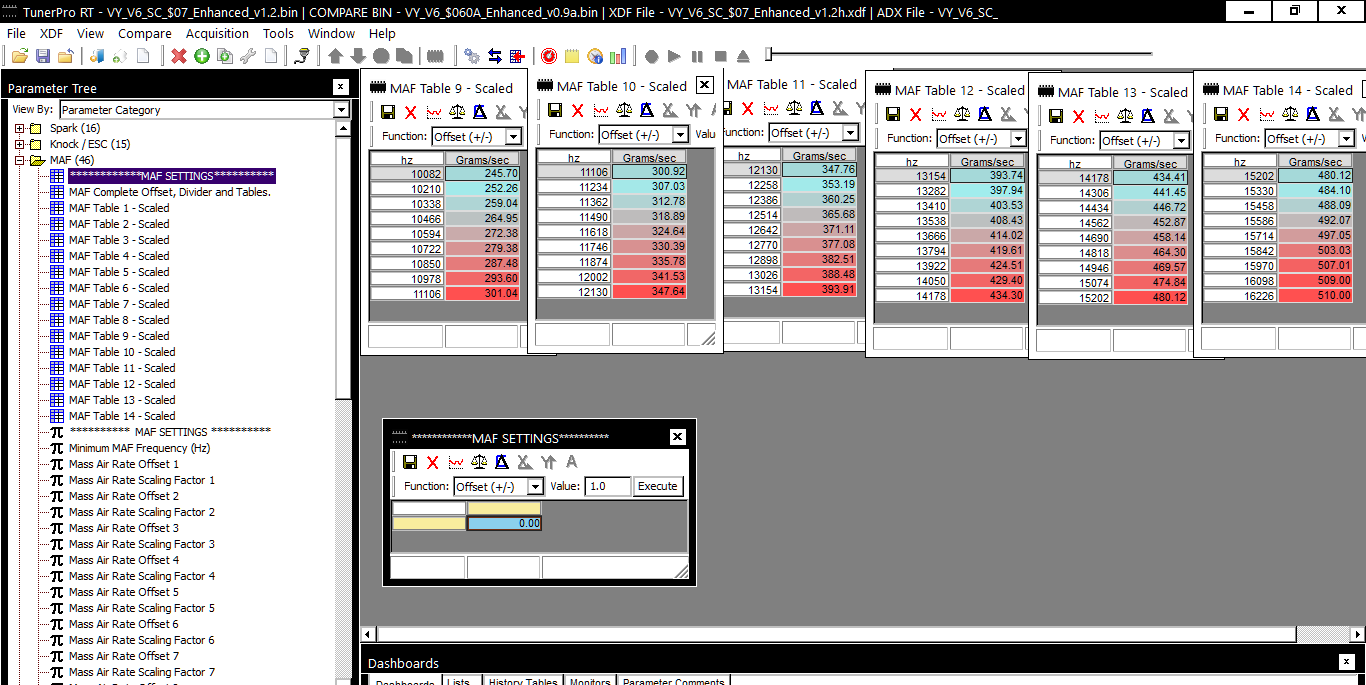

Hey everyone I've recently fitted a turbo to my VY Ecotec and Ive been told that you can use the VY S/C tune. Im running the S/C injectors aswell and I'm only running 5psi of boost currently. My question is that do I need to copy to my VY tune from the S/C tune? I've already copied the injector settings needed but I'm a bit confused about the MAF settings mainly.
Do I just copy these MAF settings along with the scalars aswell from the S/C tune?
TunerPro RT - VY_V6_SC_$07_Enhanced_v1.2.bin _ COMPARE BIN - VY_V6_$060A_Enhanced_v0.9a.bin _ XDF File - VY_V6_SC_$07_Enhanced_v1.2h.xdf _ ADX File - VY_V6_SC_ 7_21_2021 5_46_33 PM.png
TunerPro RT - VY_V6_SC_$07_Enhanced_v1.2.bin _ COMPARE BIN - VY_V6_$060A_Enhanced_v0.9a.bin _ XDF File - VY_V6_SC_$07_Enhanced_v1.2h.xdf _ ADX File - VY_V6_SC_ 7_21_2021 5_42_28 PM.png

The ecotec and L67 use the same MAF so there are should be no changes to the MAF tables. The1's enhanced tunes have different MAF tables because he re-scaled everything to allow for double the airflow capacity and the use of larger MAF's.

Okay then, I wasn't sure because I'm now running boost into a N/A engine and I thought the L67 S/C MAF sensor setting might of been a bit higher due to the L67 using the supercharger.

Taylorkane wrote:Okay then, I wasn't sure because I'm now running boost into a N/A engine and I thought the L67 S/C MAF sensor setting might of been a bit higher due to the L67 using the supercharger.
Nah all the same. We use flash pcms all the time with just SC cars. MAFs are the same, and the gram vs hz is the same.
Just copy over the injector data, the power enrichment tables, timing tables and you should have a base. There's a few more that need copying over but I would just do a SC vs NA compare and change over the fuelling stuff.
It will get you started.

Absolute legend! I'll get started on the sc compare.
