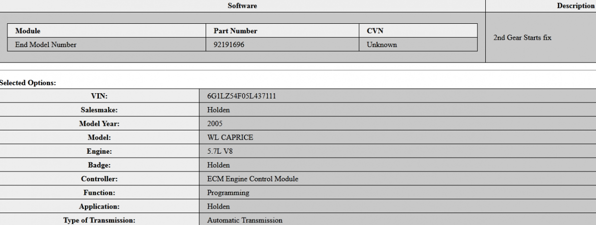

So today I attempted to use my 2 vin slots on tds, it ported me over to the new system. It wouldn’t allow me to SPS as the VIN wasn’t recognized, after much stuffing about I noticed that my region was set to North America, not Australia. Go to my profile settings to change it and it tells me that I need to be logged out, log out and that menu disappeared :evil:
Can anyone help with a stock file for a particular Vin?
Posts: 2971
Re: GM You done f*cked UP with programming
Post by VX L67 Getrag »
whats the vin?
Posts: 2681
6G1LZ54F05L437111
Posts: 2971
According to TIS this is what it should be...
Posts: 2681
Yep, that’s the car
Posts: 2971
I don't seem to have any files with that software calibration
