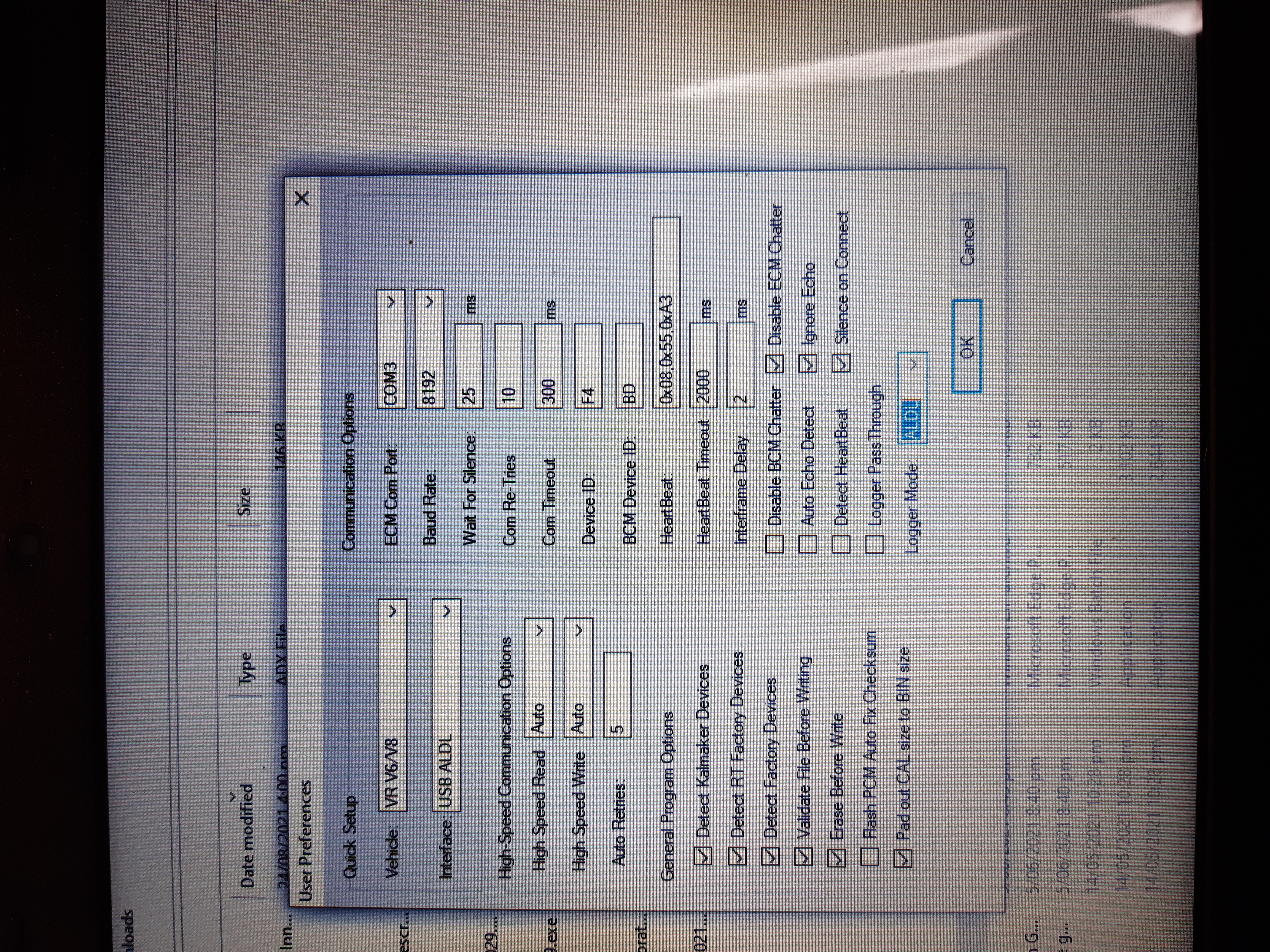

Hi,
Yes once i can get it to download, i will name and save it.
The photos in the last message was as fas as i could get. And it was taking about 5 minutes or more to get to each retry stage.
How long does it usually take to download the Bin?
There must be some thing I'm not doing 100% correct.
Any ideas?

Under user preferences I have to following settings
High speed coms read and write set to AUTO
Auto retries 5
General program options all ticked except for Flash PCM
ECM com port empty
Baud rate 8192
Wait for silence 50
Com retries 10
Com timeout 300
Device ID F4
BCM device BD
Heart beat 0x08.0x55.0xA3
Heartbeat timeout 2000
Tick disable chatter, ignore echo, silence on connect
Logger Mode ALDL
Auto retries 5
ECM com port empty
Baud rate 8192
Wait for silence 50
Com retries 10
Com timeout 300
Device ID F4
BCM device BD
Logger Mode ALDL

Edit: photo attached of the setting I had the other day.
