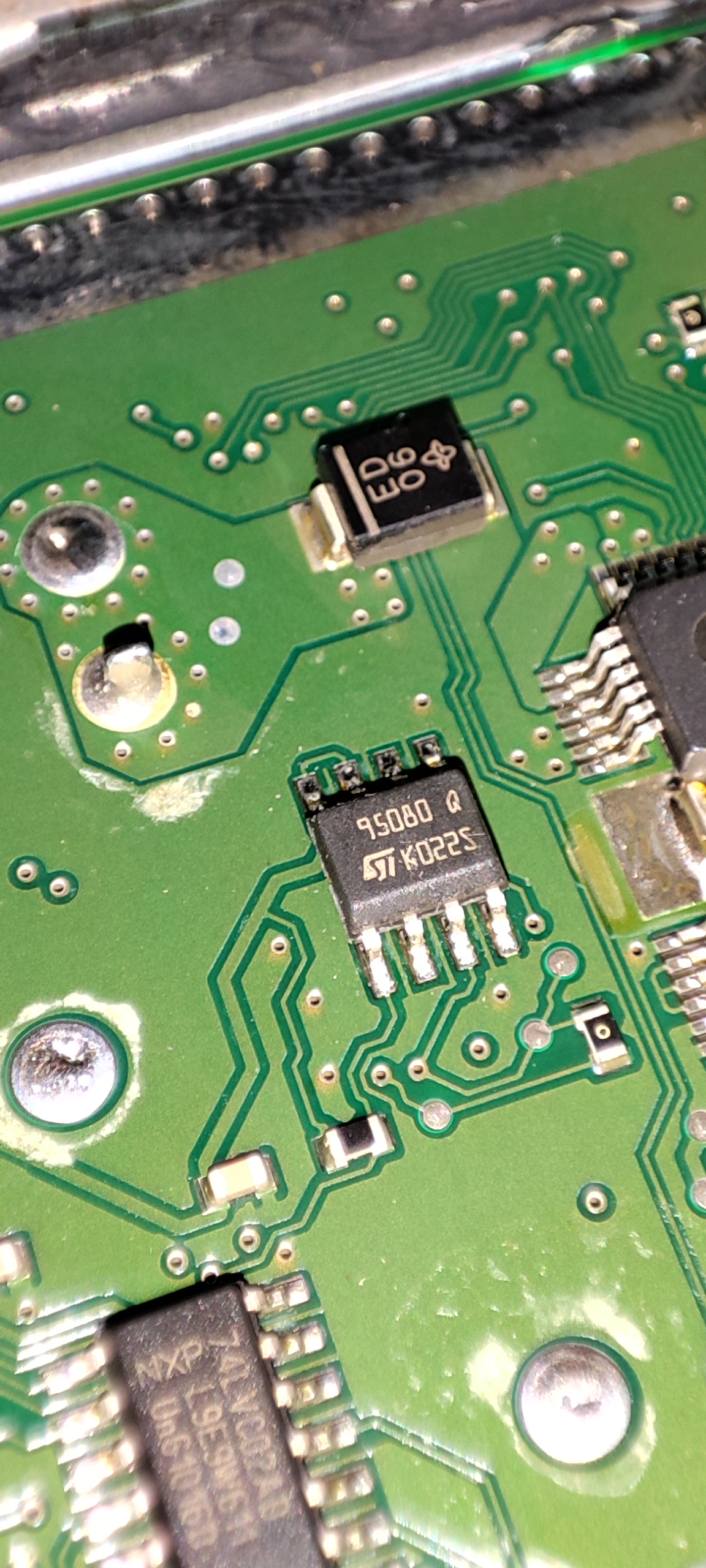

E69 VE V6 ECU, pin read
Posts: 4853
More a FYI then anything but once open you can read security pin from EEPROM ST95080, I had a dead ecu and didn't know the cars security pin.
Pin on attached file is 2881
Posts: 2971
Re: E69 VE V6 ECU, pin read
Post by VX L67 Getrag »
Nice & Handy to know, is that just the standard 3m SOIC plug.... it's hard to find a descent 1 that makes good connections!
Posts: 4853
yes it is, mine works but i have to hold pressure on it.
