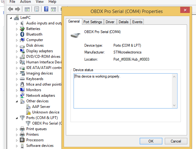

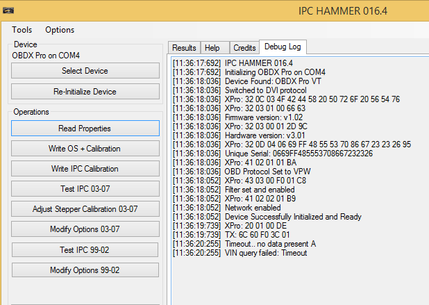

I use IPCHammer on an old HP laptop running 8.1. I use a OBDXPro VT v3 via a USB cable to communicate. It has been working flawlesly until last night. Reworked a Cluster and turned on Trans temp. All went fine. Then went to read another cluster and it started flaking out. It read the cluster but wouldn't test it (but said it did). Then it wouldn't read the cluster . Gave me failure to get the VIN.
Today I tried it with a good cluster and got the same thing. When I test the IPCHammer and port it says it good, but it will not read the cluster (Won't read the VIN.) Thoughts?
- OBDXPro VT 1.PNG (32.5 KiB) Viewed 25040 times
- OBDXPro VT.PNG (40.48 KiB) Viewed 25040 times
Re: IPC Hammer
I really want to give a shout out for The guys at OBDPro. I had messaged them before posting here. I expected it to be a while so thought I'd hit y'all up, Jason got back with me quick and spotted that my voltage is 9.6. So it's time for a new power supply. The OBDPro works great and I highly recommend it to anyone wanting a fast reliable connection.

Just a note for anyone reading at home, OBDX did not connect above due to the "Device Type" was not set to OBDX Pro either.

The low voltage AND the Device Type were the first things I noticed.Tazzi wrote:Glad to have helped!!
