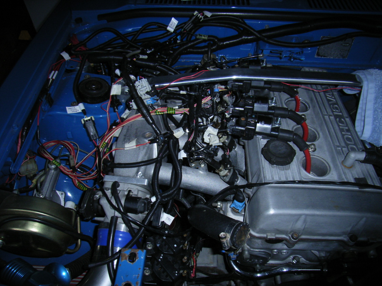

PO1 4cyl testing

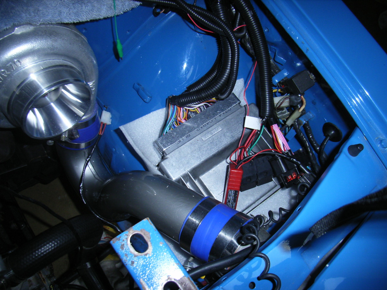

Yortt wrote:PO1 4cyl testing
That looks like it'll be fun.
Tell me about your setup/programming.
Bad things happen FAST!!!
Yortt
Posts: 133
Joined: Mon Apr 13, 2009 10:11 am
Re: Am I crazy or could this work?
Post by Yortt »
My setup/programing was initiated after Dick at Dick's Electronics was progressing his conversion project on a 4 cylinder turbo Toyota we both have the cars running and drivable now but still require work sorting out fine tuning. Dick is using his RTLS1 hardware/software and operating system which is different to me. I am using HP Tuners with the 1290005 operating system on my turbo 4 cylinder engine. The start tune was sourced from my son's LS1 turbo running a developed E85 tune the PCM thinks it is running a V8 engine with appropriately connected coils and injectors to the 4 cylinder engine. So does it work YES, can the fine tuning be sorted out, time will tell.
