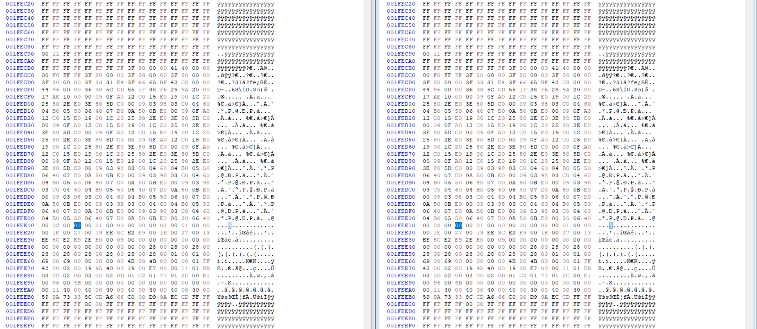

It might be possible to get you close. Have you got the hpt file you can attach? There is some unused data blocks above and below that might help nail down the offset in your file from the info that I've got.
Screen shot shows the switch to flick it from TOT to EOT for OS12609099

I looked for that bit at 001FEE13 in 12607218 and unfortunately the whole area is empty from 001FD520 to 001FEECF. I was able to match up 001FEED0 from 1260718 to 001FEF58 on 12609099 and check with the offset also.

Which exact sensor did you install? Did you install the combined level and oil sensor in the pan or is there another sensor with the same resistance?
I have played around with this on the bench for 12639270. The switch there seems to be at 0x1FEDEC. That enabled the custom PID mentioned by kidturbo from the other forums. It also disabled the trans temperature reading, so I assume it worked. With the trans temp sensor you could see the temperature on the HS CAN bus, but with this switch enabled there is no change. I had to query it via OBD2 like described in the threads.
