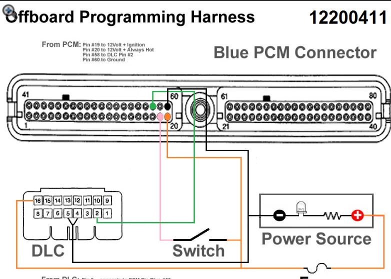

I had ground to PIN 1 on blue main PCM connector, swapped it to 60 for PCM Hammer an voila, it's reading like a champ now.
For EFI Live and HP Tuners:
JN crnt bnch hrns PCM connections.JPG (31.4 KiB) Viewed 2932 times
For PCM Hammer and j2534 (duh read bench harness set up)
PCMHammer correct wiring to main blue connector for p01 p59.JPG (81.12 KiB) Viewed 2932 times

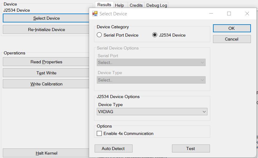

Tazzi wrote:When the VX nano switches to 4x speed, this requires a good strong connection with the engine computer without any noise/interruptions.
My guess is the communication line is noisy, resulting in either the ECU or VX nano to drop back into 1x VPW mode, meaning loss of communication.
Try untick the 4x mode in pcmhammer and see how it goes :thumbup:
I could not find this, but upon further looking, it's in the Select Device screen near the bottom. Unchecked it and got a successful read on a p59 immediately. Pic for future readers how to uncheck 4x in PCM Hammer inside the choose device window:
PCMHammer Select Device window.JPG (55.92 KiB) Viewed 2934 times
Then after that I was able to take my initial v8 p01 read and over a v6 p01.
