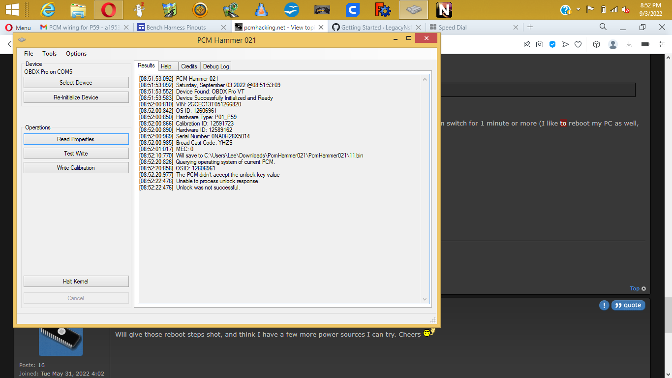

Gampy & Antus, I changed from the 9381344 and performed a Write Entire op using 12202088 OS and all seems well. Still finishing the tune but the 'Hammer reads and writes the PCM now. I did forget that I have a Nano GM and it, along with my other professional tool, works fine for all operations. 9381344 seems to be at least one of the problem child operating systems. I also tried using v18,19,20 along with 21 and none would read the 9381344 so it seems to be coincidental that my issues began while using v21. Thanks for letting me hijack the thread though. :-)
Bill

Gampy, to add, yes I always confirm it is not a hardware issue(power supply, wiring, etc) on my end before ranting on the internet. :-)
Bill

Trouble getting started. I am trying to read a P59. I have a HP laptop on Win8. I am using an OBDX Pro VT v3 with a usb cable . Com5. I can do a read properties and seems fine, try to do a read entire and It says is unable to unlock. What am I not doing. I followed Gampys order of initializing on this thread about Jun 24 after I rebooted my laptop. I followed the suggest wiring for a bench harness, except my blue PCM plug did not have a wire in 60 for ground on the PCM so I used pin 1, also listed as a ground. I am using a benchtop power supply at 14V.
PcmHammer_debugLog_20220903@205335.txt
(3.17 KiB) Downloaded 74 times

the xpro doesnt show what came back from the pcm in the debug log, but we can trust that the pcm rejected the key. its probably a locked tune. Try this to hack around the lock. viewtopic.php?f=4&t=5828&p=86776&hilit= ... ock#p86776

I had wondered. PCM from the junkyard. I'll try the hack later today. Thank you
