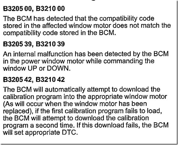

so these window motors are basically little slave modules. the BCM is the master module and communicates with all the window motor slave modules and switches over the LIN bus. are you using the motors and switches from 2014 as well?

Thanks for the info and questions; I'll incorporate the above into my final decision. The BCM is from the 2014 Camaro. I have an alternative to using the OEM 2014 motors/controllers, more on that in a minute. But right now, what I have is new classic regulators with wire wound motors with the now removed OEM motors being step motors. I have cut the controllers away from the OEM step motors and rewired the controller outputs to the new wire wound motors. The specific answer to the question about the motors and switches is that the switches and the controller (bus interface) part of the motors are incorporated, but the motors are new and different and that difference is apparently the cause of the issue. I have posted a pic of service manual that applies below.antus wrote:I had read of the thread, disclaimer i'm not familiar with the car, or window hardware, or the relearn procedure you are talking about but I can give you some general advice. The MDI2 mentioned in the third thread is expensive OEM. You can get the same aftermarket for 10% or less of that price and the MDI is fine too. You can also use a different J2534 device, eg the vcx-nano gm. You can buy access to GDS2 for a couple of days for your vin via https://www.acdelcotds.com/subscriptions . You said you changed the wiper engine type to a different style, electrically. This might be a show stopper, these things tend to be tied closely to factory hardware spec. The aftermarket module the other guys are talking sounds more likely to get you a working solution easily. Tech2 is for older cars up to about 2009, GDS2 is for newer models, so MDI/MDI2/J2534 interface plus GDS2 would be the hardware and software. J2534 interfaces are not created equal, so you need to get one with reports of it working with GM tools and vehicles. MDI and MDI2 are GM branded factory Bosch J2534 tools. Having said all that, at the end of the day I cant confirm if there is a wiper relearn in GDS2, and if there is that your hardware is compatible with the new wiper motors.
The BCM reacts oddly by moving the windows erratically; sometime up and sometimes down. I do not have the codes because most cheap scanners don't read the BCM and I have not come to a conclusion as to how to proceed so I am waiting before I buy a new scanner/programmer.

might be a better option to wire the motors without the BCM involved. the BCM will set LIN bus codes but I don't think it will care otherwise...

After checking this issue out from every angle, including wiring the OEM motors in parallel with the new motor, I'm biting the bullet and installing the aftermarket switches. The good news is the B+ source for the window is standing hot at all times (un-keyed) in both doors and after removing the OEM controllers and switches, the remote alarm locking and manual doors locks still function, but I haven't determined if the alarm itself still works. I mention this bc as I recall, the alarm circuit goes though the window switches.gmtech825 wrote:might be a better option to wire the motors without the BCM involved. the BCM will set LIN bus codes but I don't think it will care otherwise...

Stepper motor controllers energize different poles of the stepper motor to initiate and maintain rotation, they will not operate a standard wound motor with brushes. I believe there are converters from stepper motor controller output to brush type motors.
