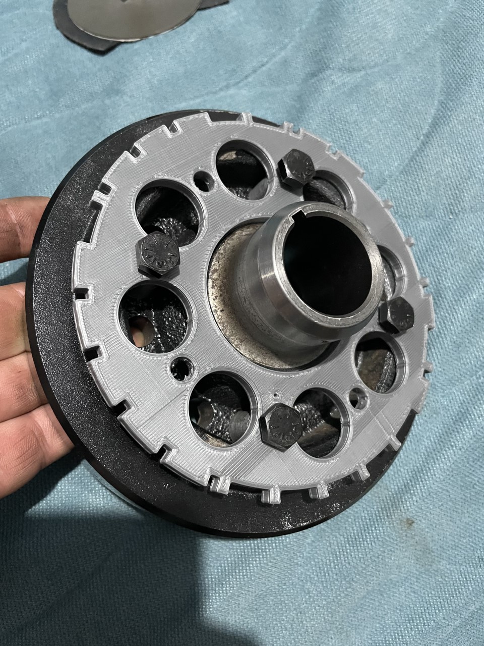

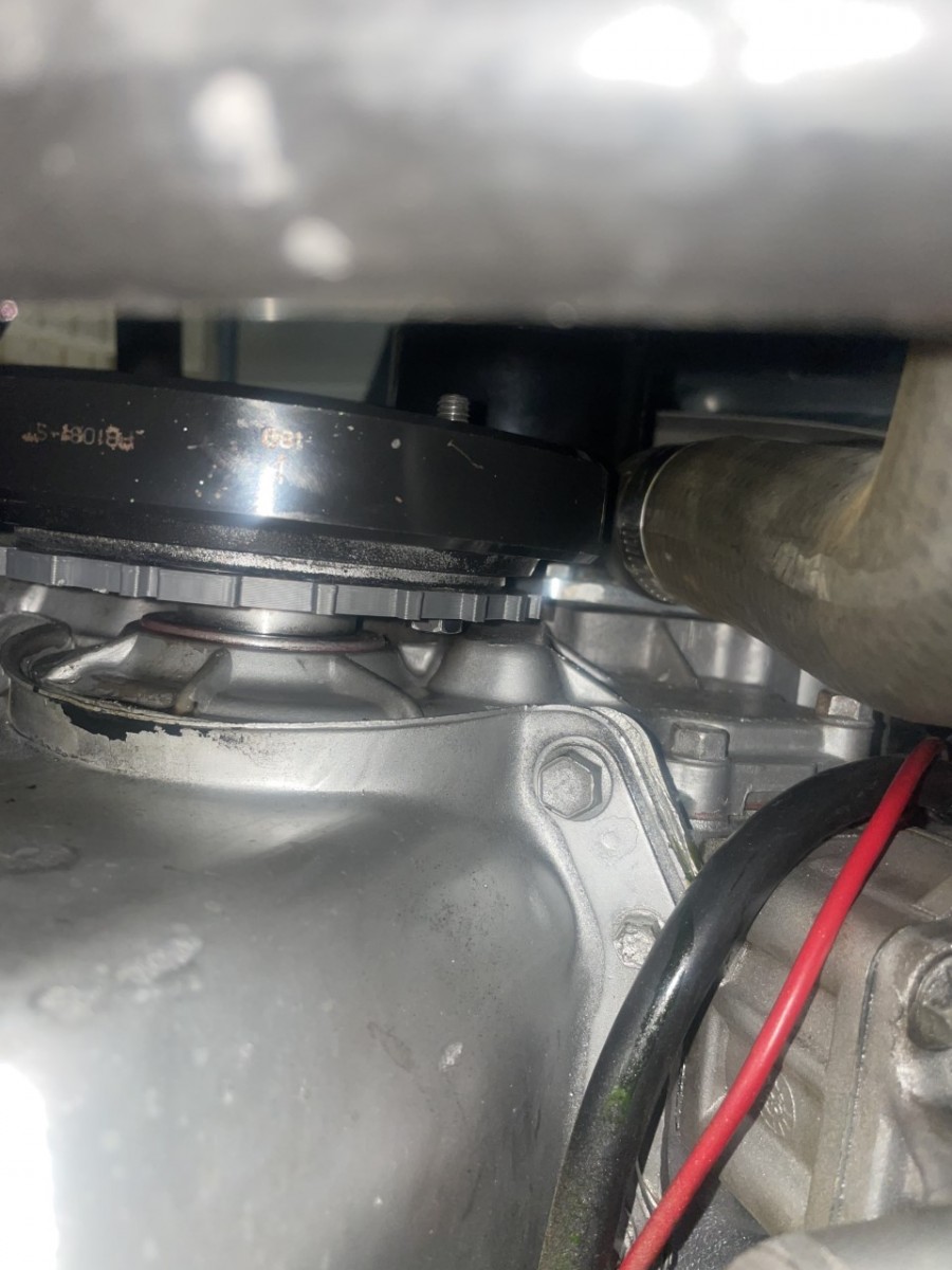

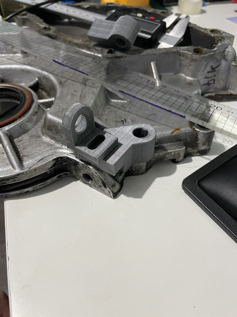

also is there any option to change the base reference spark angle that could be added to the xdf as im planning on using this pcm on my 304. ive drawn up a crank trigger to sit behind the harmonic balancer and a bracket to suit
but would be a hell of a lot easier to set it up if you could change it in the tune but if it cant be the sensor bracket is able to be adjusted about 4 degrees either way hoping thats enough to get it right.

But do you have a drawing for the reluctor? Is that thing 3D printed?
I ended up finding the pattern for the x24 trigger angles off of the Haltech website drew it up in Fusion 360 and 3d printed it for mock up before sending it off to get quotes on being machined up

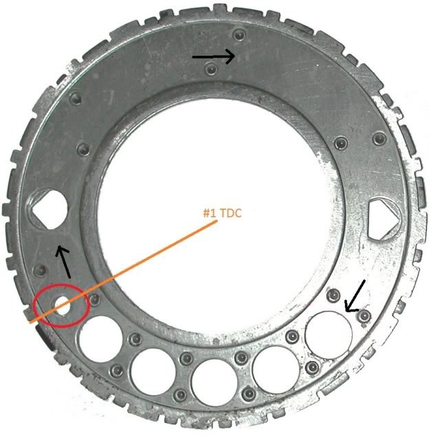

Thank everyone have added a notation mark on my trigger wheel if you look near one of the bolt heads there’s a small what looks like a pin hole but is actually tdc mark it will be pretty close with just bolting the sensor and trigger wheel up but may always need a little adjusting for tolerances
