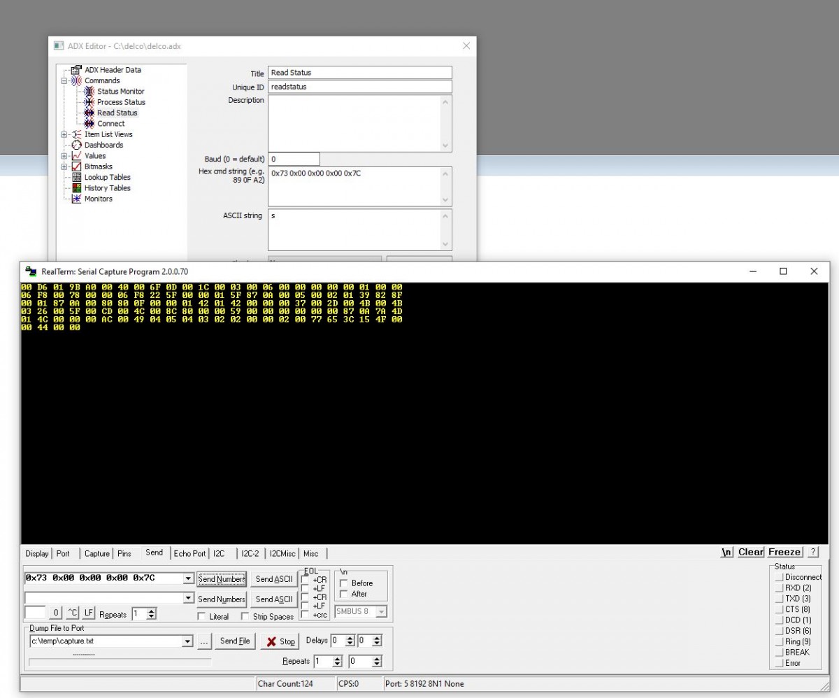

I can feed the Status string to the PIS code through a terminal and we get back exactly what we expect, but tunerpro doesn't seem to get a response at all. Perhaps the typerate is too high for this code. Is there a way to slow it down? Or is tunerpro expecting some other kind of handshaking before it'll 'connect'

your process status needs to accept the right amount of bytes and define which of them are the payload, then you need a macro to run the setup and init stuff, then call the read status, process status, then you need to configure the tables to do something with the data. look at a working xdf to see how the macros and command, monitors etc work together.
