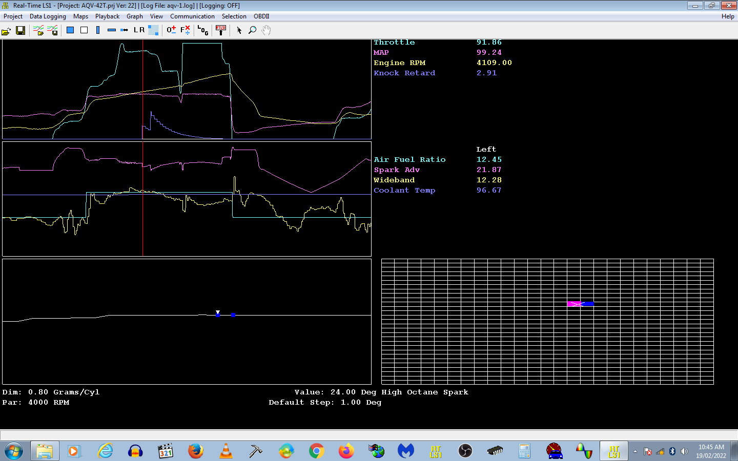

One of the outstanding features of the RTLS1 is to know the exact time the knock sensor is triggered due to the fast logging rate.
This takes away the guess work to know how to shape Spark timing table or fuel in the VE table.
Logging knock at 100 fps displays a vertical leading edge which is the start of knock control.
With slower logging rates you will not see this vertical leading edge as clearly.

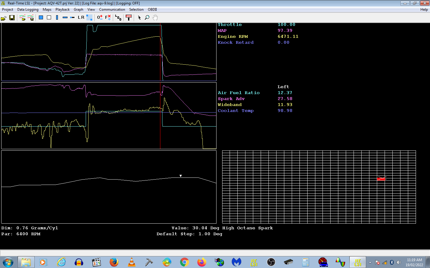

Knock gone.
