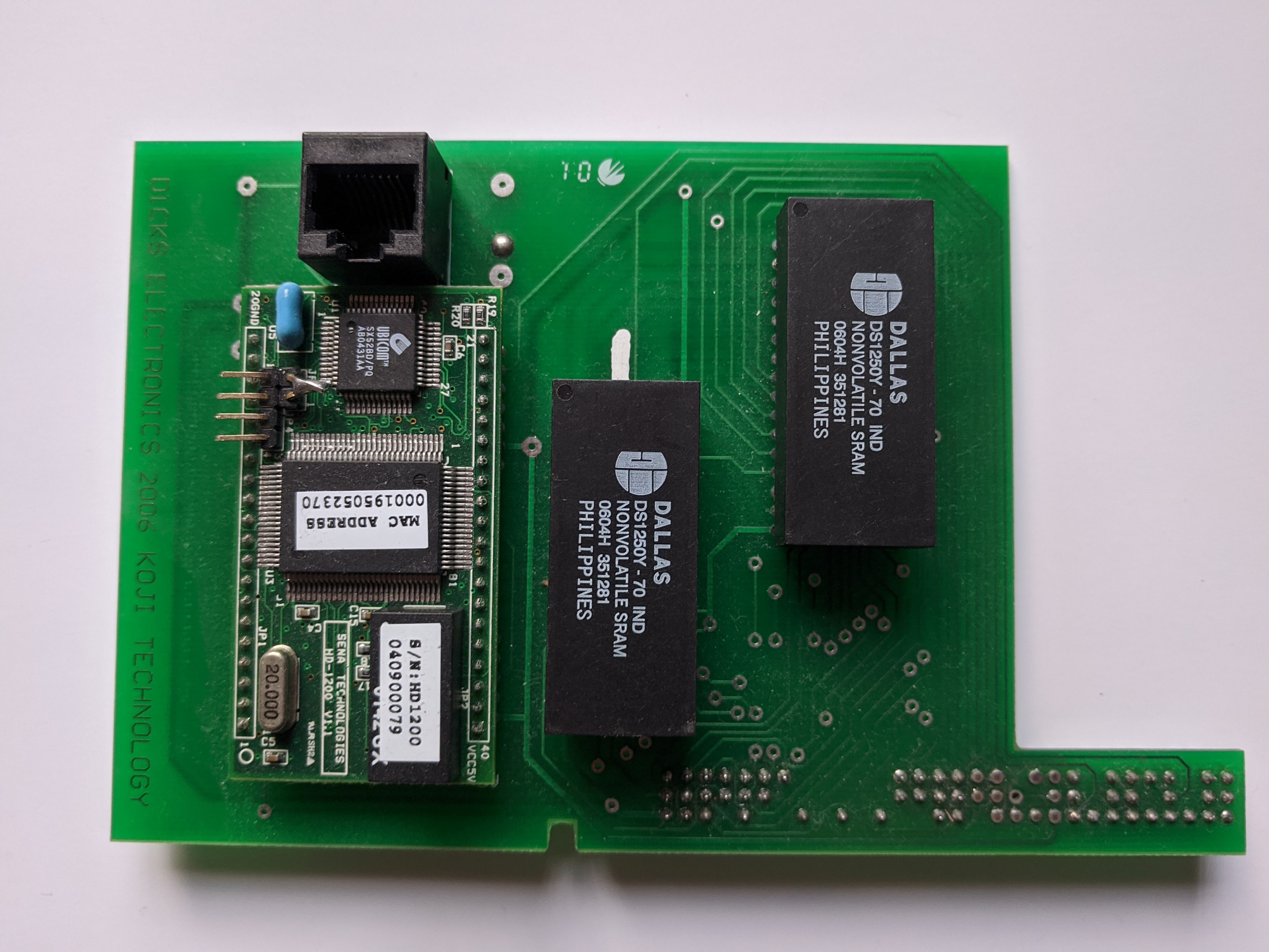

Picture of RTLS1 daughter PCB which has all components necessary for Real Time tuning and 100+ fps logging speed.
This daughter board is what would be supplied fully assembled if one wanted to build there own RTLS1 PCM.
Communication to the RTLS1 Daughter PCB is RG45 protocol. A square hole must be made in the PCM's aluminum case to accommodate the RG45 socket.

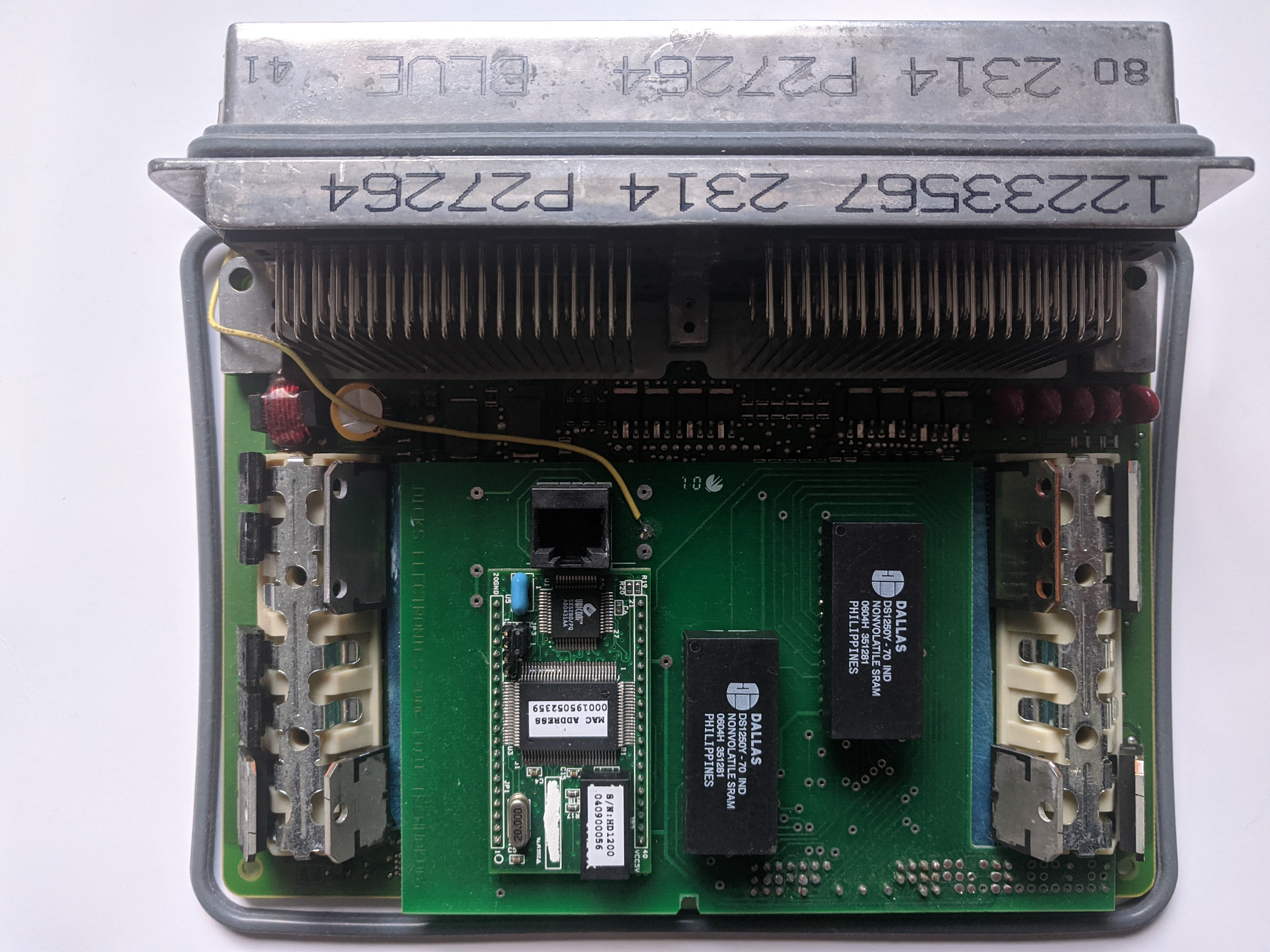

RTLS1 daughter PCB installed

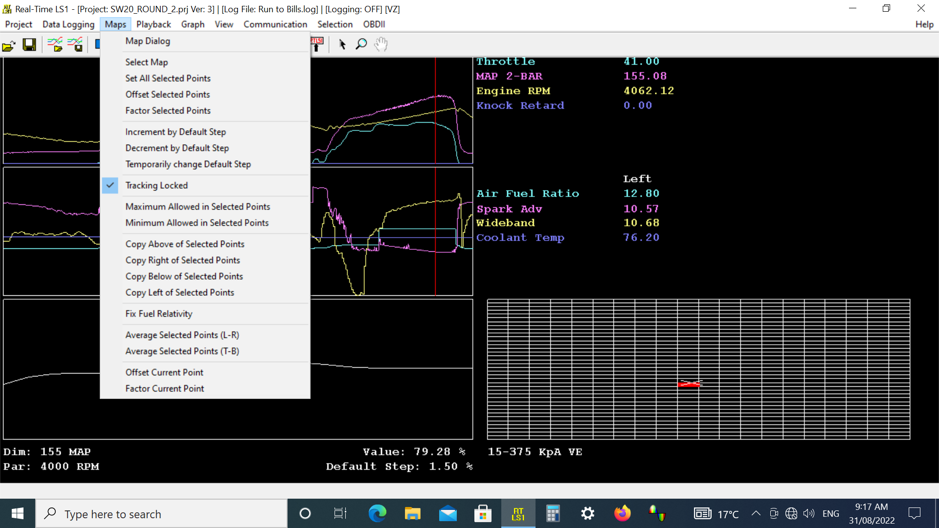

what/how does the GUI side of the RTLS1 look like/work?
I assume you have your own tuning package for editing and scanning? what definitions are available or does it use XDFs? what about DMA pids? EFI sure has a bunch that are helpful..
I'm very comfortable using EFI and use tunerpro as necessary. My current hesitation is learning yet again another GUI and getting up to speed on it within my workflow.
kojab
Posts: 445
Location: Sydney
Re: RTLS1 with LS1 Boost OS
Post by kojab »
Correct the RTLS1 caters for editing and scanning.
Current definitions for the US market are for 12587603 and variants including Bubba's "LS1 Boost OS". and Australian VX VY VZ LS1 P01 and P59 PCM's
Can accommodate any GM LS1 mask using the P01 and P59 PCM's. RTLS1 does not use XDFs.
RTLS1 does not use DMA pids it uses memory locations within the bin file.
Communications protocol for the RTLS1 is High speed RJ45 Ethernet. This is how the RTLS1 can log at speeds up to 165 fps.
We can use EFILive's or HPTuners cable and its Bunch of Pids at the same time we are logging with RTLS1.
Me too
You will get up to Speed with the RTLS1.
