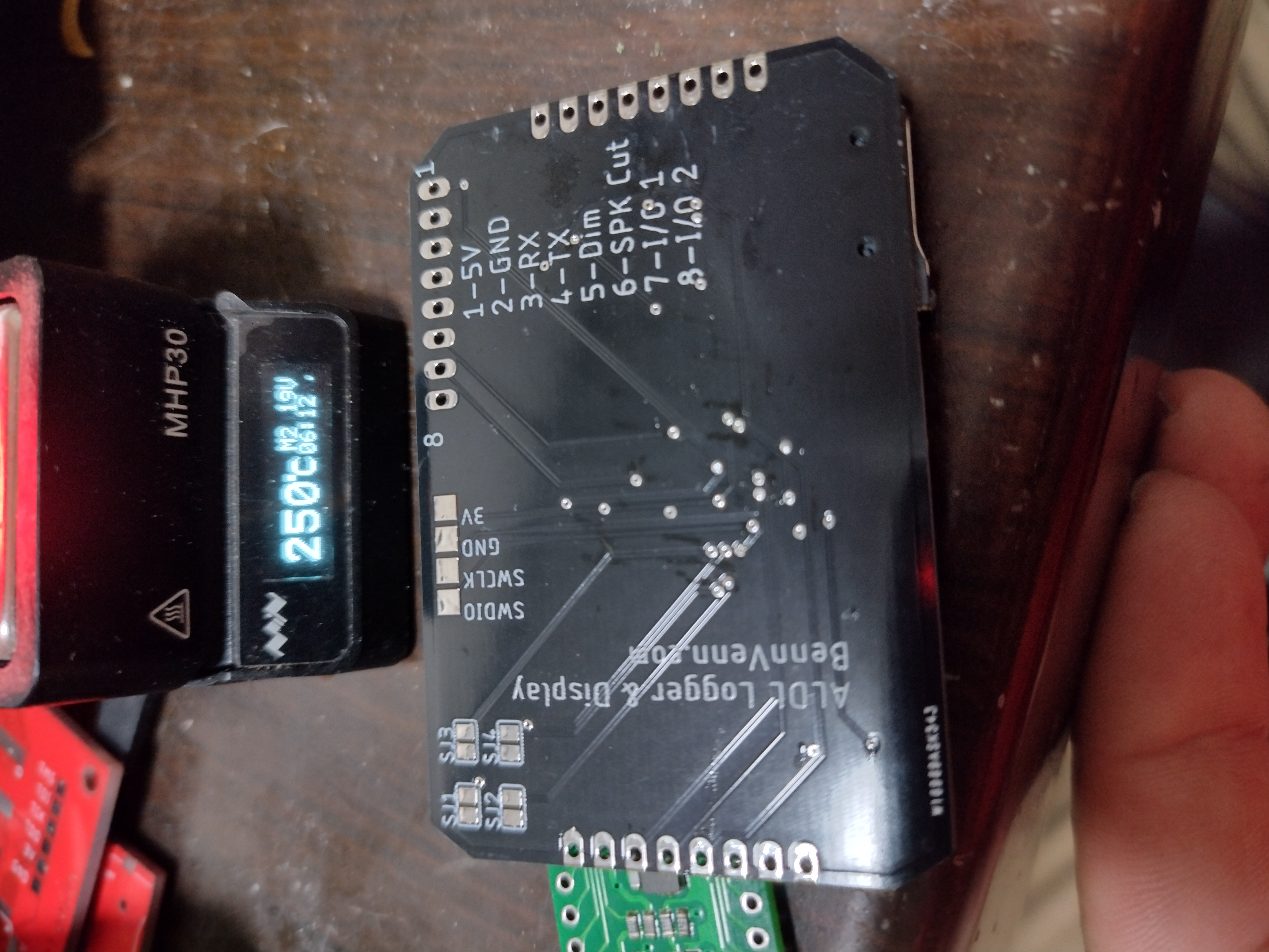

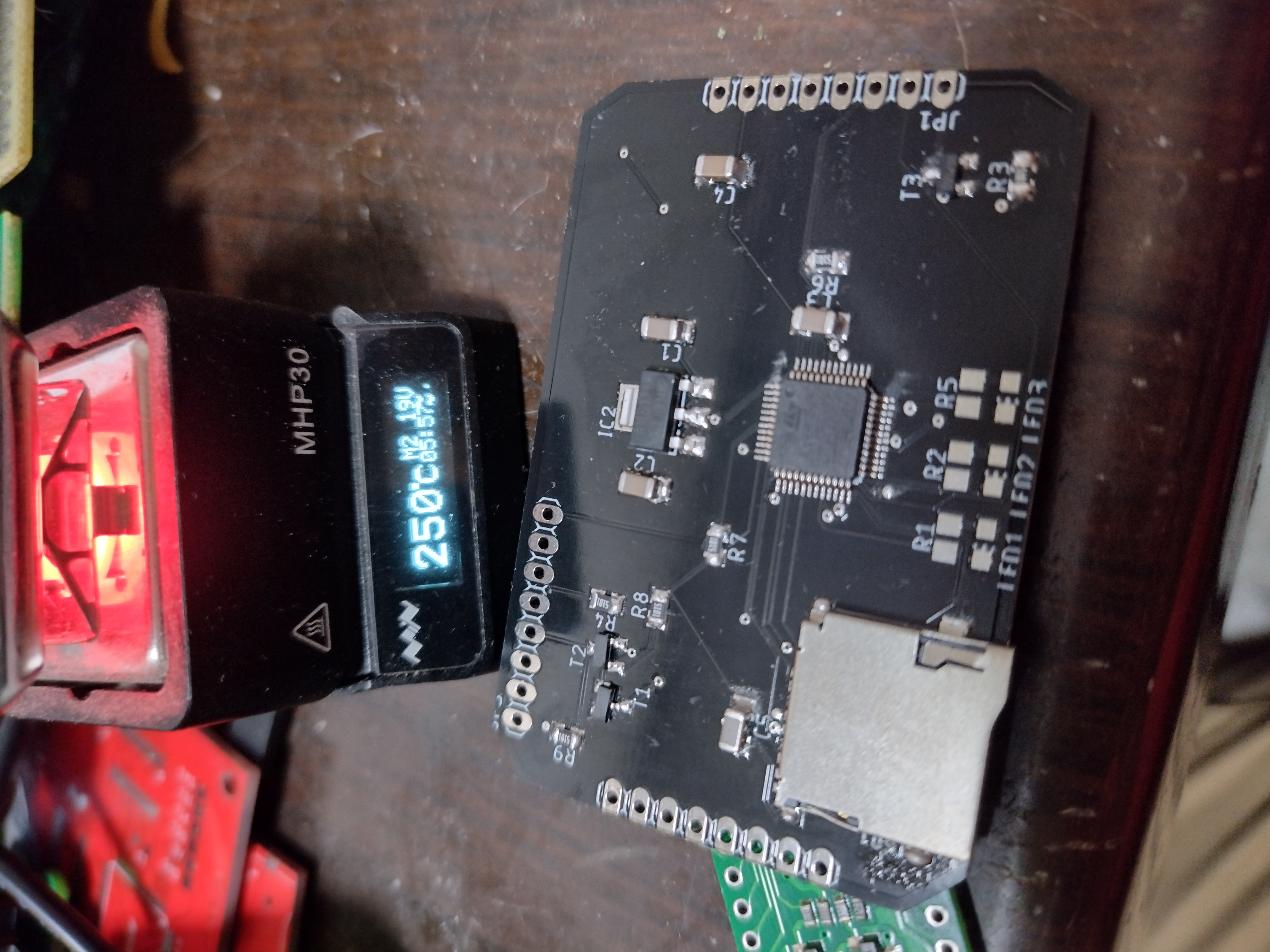

PCB's arrived at a friends place up in QLD, he's express posted them here, should get them tomorrow.
DHL charges an extra $35 as we're in a 'remote' region so its cheaper to ship to a capital city and forward on.

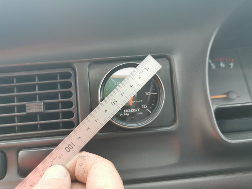

got rough dimensions on the 2 inch screen hoping for it to replace my mechanical boost gauge as seen below. Never know maybe able to go larger than 2 inch screen

I'll need to grab the Vernier's to confirm though it looks a little wide for a 52mm pod. Would fit in that space you have behind it beautifully with a 3d printed frame
