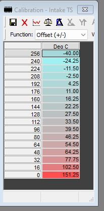

Posts: 4810
Re: VS-VY Enhanced Factory Bins
if it's 0-5volt then it should be ok.
here's the factory sensor calibration table in the out of cal area.
