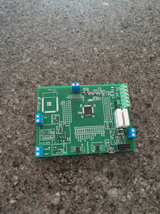

New prototype in. We will now be testing out:
1) Inbuilt triple can (No relays needed!) so support HSCAN,MSCAN, GMLAN and FD CAN (On HS and MS pins)
2) Kline/L-Line
3) PWM
4) FEPs for Fords programming (simply bridges battery to pin13)
With those added, we should be covering basically all common OBD2 protocols plus more
I know I probably shouldn't be this excited to have more work.. but this is basically the last 10years of everything I have learnt being rolled into a tool
2) Kline/L-Line
3) PWM

Oh nice
. It might be a bit early at the moment, but do you have an approximate pricing on this interface?
It’s hard to say as we have no idea if we can fit this into our current case design, or if cost of the processor is going to get better or worse ect. Fitting it all into a small case means using more complex pcba options and techniques, along with more layers, which has serious impact on price as well.vs ss wrote:Oh nice. It might be a bit early at the moment, but do you have an approximate pricing on this interface?
It’s more important to get working firmware at the moment, then we will work on finding the most viable production methods, and whether a custom case needs to be made ect.
