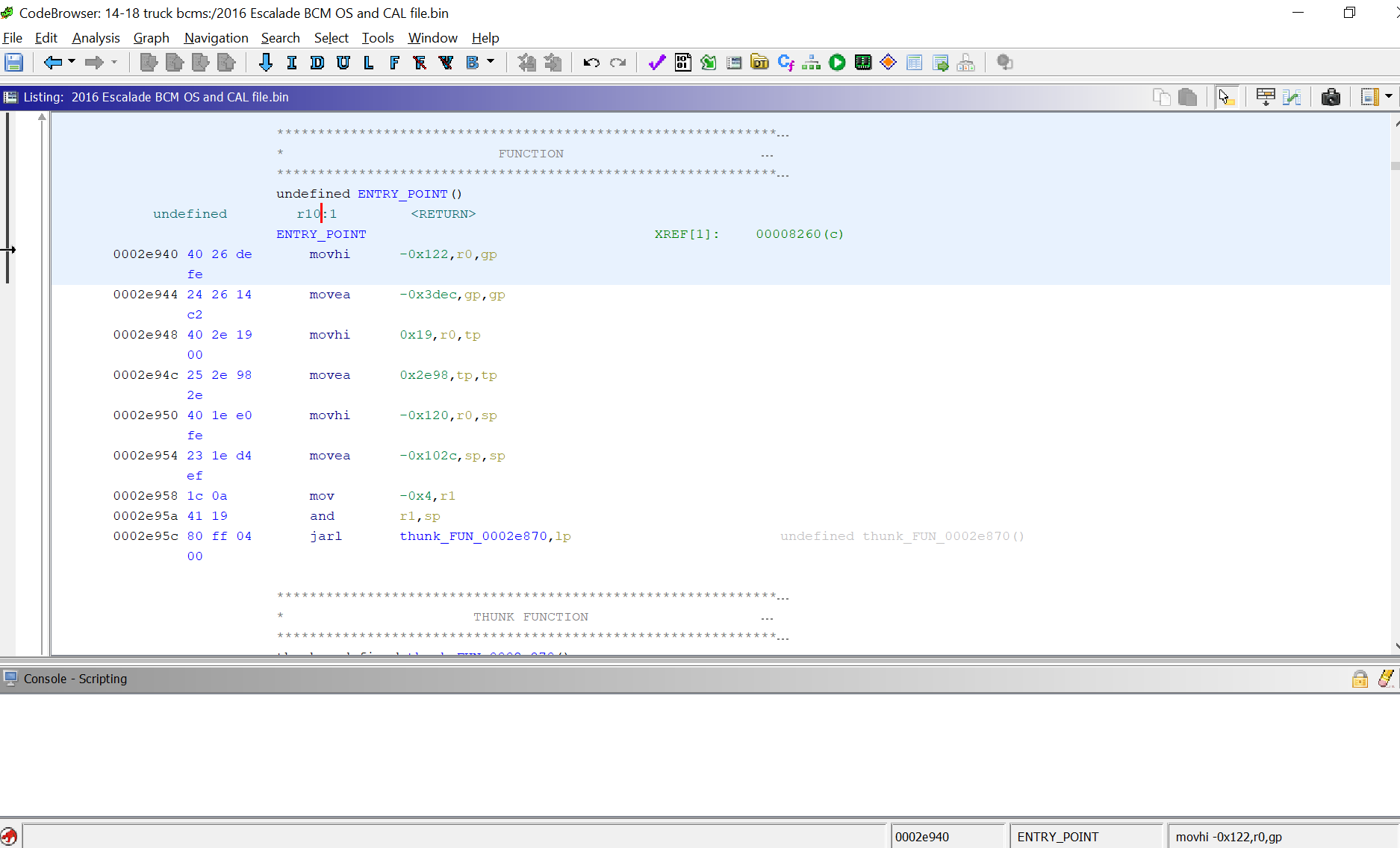

working on the remote start timer for this generation of trucks and possibly other features as well but I'm running into problems with dissassembly. there are a large amount of data parameters that don't get referenced in the cal segments and I believe it's because I need to set a couple register values (GP, TP?). I'm hoping someone can help me verify that, and calculate these values.
if you open the bin in ghidra (V850 processor type) and go to 0x8260 and decompile, i believe that jump is the entry point. it should jump to 0x2E940. you should see it setting up the registers. I'm not good at assembly and don't trust myself to calculate these values correctly. it also looks like at 0x2e88c there is more manipulation of these registers.

Now I remember why I hate V850s. Everything is complicated on them. I'm no longer convinced we need the bootloader, but I went ahead and got it out of my BCM anyway. It's attached. You can see if yours is the same part number by using mode $1A $C0. I'm reasonably confident it's accurate, but I haven't found the checksum to double check it.
I can't find a straightforward explanation of how this thing starts executing code straight out of reset. I think it starts at 0x0, but that's confusing because the very first instruction in the bootloader is a mov from r2 to r0. How can there be anything in r2 if it's coming out of a cold start? Then it jumps to a sub that sets up the GP and TP similar to your example. But it all gets reworked at 0x2E940 anyway, so I'm not sure it's relevant.
Anyway, this is my best guess so far. It puts the GP at a point near the beginning of RAM, and the TP to flash, and the SP near the end of RAM.
The architecture manual describes the TP and GP like so:
r4 = gp = global pointer. When to access global variable in data area
r5 = tp = text pointer. Used as a register that indicates the start of the text area. (area where program code is placed)
So I think the flash file needs to be chopped up and rearranged a bit, but I don't know exactly how just yet.
* FUNCTION *
undefined FUN_0002e940()
undefined r10:1 <RETURN>
FUN_0002e940 XREF[2]: FUN_000048b4:000048ea(c),
000092e0(*)
0002e940 40 26 de fe movhi -0x122,r0,gp //Write 0xFEDE0000 to GP
0002e944 24 26 14 c2 movea -0x3dec,gp,gp //Add -0x3DEC to GP. GP = 0xFEDDC214
0002e948 40 2e 19 00 movhi 0x19,r0,tp //Write 0x00190000 to TP
0002e94c 25 2e 98 2e movea 0x2e98,tp,tp //Add 0x2E98 to TP. TP = 0x00192E98
0002e950 40 1e e0 fe movhi -0x120,r0,sp //Write 0xFEE00000 to SP
0002e954 23 1e d4 ef movea -0x102c,sp,sp //Add -0x102C to SP. 0xFEDFEFD4
0002e958 1c 0a mov -0x4,r1
0002e95a 41 19 and r1,sp
0002e95c 80 ff 04 00 jarl thunk_FUN_0002e870,lp undefined thunk_FUN_0002e870()

Drill down to 0x2E88C. It screws with both registers again, in an even more complicated way.
And again at 0x2E940.
That's just what I found on a quick glance. There's probably more.

I was just trying to help gmtech out. There's big blocks that disassemble, but other that don't. I don't know if they're data or what. I haven't done any real detailed checking on this code because it's such a pain. Even if the code disassembles, the cross references will be broken without accurate TP and GP references.
