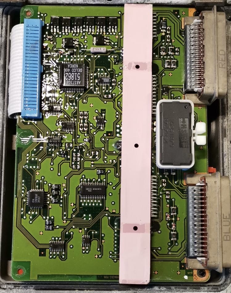

please help identify this ECU and turn VATS off, can't find any info
GMC Yukon 1999 5.7L V8 OHV 16V 4WD Gasoline Automatic 1GKEK13R6XR911458
engine + ecu placed to other old car, bcm doesn't exist
thanks!!

Solitaire, what did you use to read the bin from the black box ECM?

The posted bin is chip dump and needs to be byteswapped, before doing anything to it.

TL866 programmerCincinnatus wrote:Solitaire, what did you use to read the bin from the black box ECM?
yes, because has been read with programmerkur4o wrote:The posted bin is chip dump and needs to be byteswapped, before doing anything to it.
