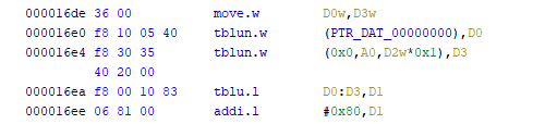

yeah I did add the instructions. it only seems to be an issue whith the Address references. direct references to the tables seem to workRADustin wrote:have you loaded up NSFWs cpu32 instructions?gmtech825 wrote:One issue I've found using ghidra for this is the tblu and tbls instructions don't dissassemble properly, especially when register A2 is involved. instead of referencing A2 for the tbl, It points to address 0x00000002. I'm currently trying to figure out how to fix this.
Anyone else seeing this issue?
EDIT: This seems to be happening for all address registers for tbl instructions

Do you have an example address location for others to look at?gmtech825 wrote: yeah I did add the instructions. it only seems to be an issue with the Address references. direct references to the tables seem to work
Edit: I think I found an example at 0x16E0
I'm not sure if this has to do with the CPU32 Instructions that were fixed by NSFW or not.

yes exactly... 0x000016e0 should be tblun.w (A0),D0. take a look at the first four bytes of the file and you will see a ton of references to that location where functions should be referencing address registers.
