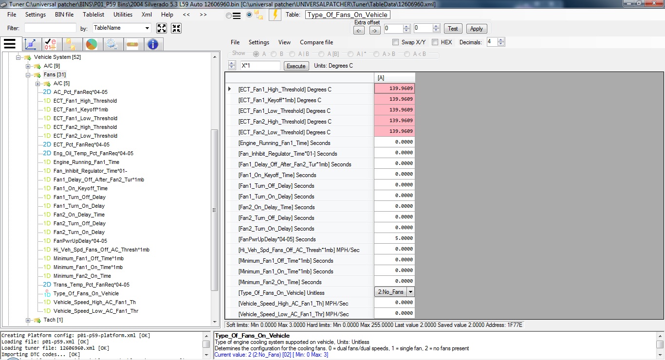

You are headed for a soft bricking the pcm, with possible engine fireworks.
Sps won`t allow fuel segment update only, because fuel segment is tied to newer OS and will likely not work with older OS. Just update the file per vin and than retune with universal patcher.
Look at the screenshot.

Ok, modified the stock 6960 bin with Universal Patcher.
What does it mean when the logs show a patch loaded (flex, lean cruise)? Stock is L59 flex.

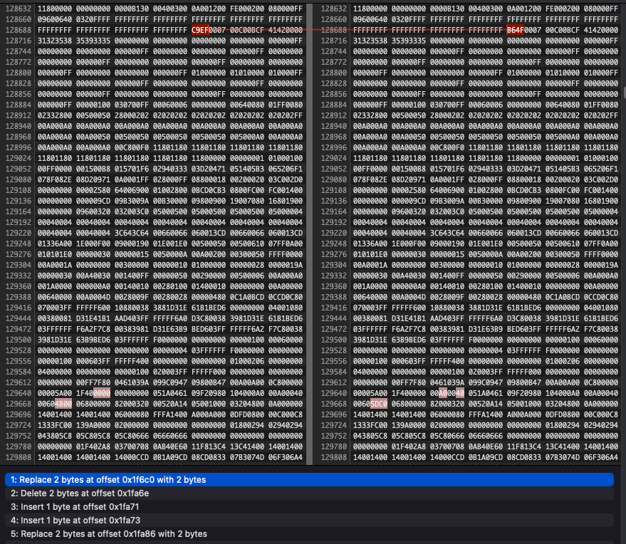

Also, for grins, did a hex compare between the TunerPro with 7603 XDF bin of same OS (6960) and the Universal Patcher. I'm not skilled but the differences could be attributed to something I might have missed in setting parameter values between the two softwares. Seems close, but I am not even a beginner at this point.
