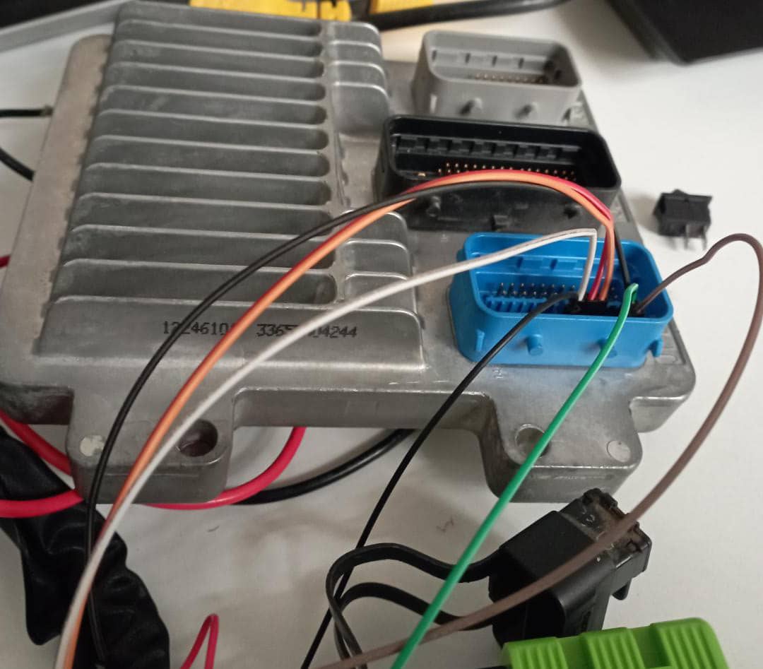

Re: PCM Hammer Release 021
My First attempt to read P12 PCM thru OBDLINK XL
I was able to read properties : [12:45:14:869] VIN: 1GNDU33L76D185590

Not sure why it identifies hardware ID as P01, 059 i`m debating that this could be a tuner locked PCM.

- WhatsApp Image 2023-02-08 at 12.44.39 PM (1).jpeg (74.91 KiB) Viewed 2250 times
