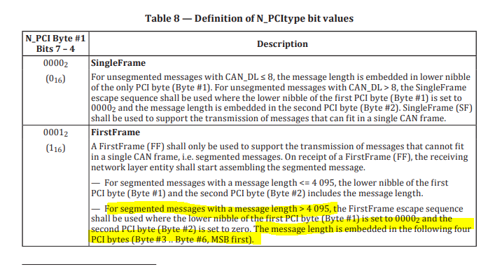

FDCAN is going to be a shitstorm.. at least.. possibly in the future.
I was reading in the official SAE document for J2534 with FD CAN that larger blocks then 4095 is now possible. In my head, I figured it would be maybe.. 8192 bytes... nope... absolutely not... its 32000+ bytes more!!!
As seen in the blurb below, technically its a 4byte value used for the length, so.. theoretically.. the max amount of bytes that could be sent is 0xFFFFFFFF. Thats an integer value of 4,294,967,295bytes. If an ECU had a large enough RAM buffer, technically an entire flash could be uploaded in one chunk
The SAE standard has limited it to a value they deem acceptable, but 32000+ is still MUCH larger then what the OBDX GT/FT can store. Id be surprised if even 1 quarter of scantools have implemented that requirement to be honest. To be 'technically' SAE compliant, we will have to be using a processor with larger ram to fit an entire 32k+ frame. At this time, Im pretty certain none of the current FD CAN GM ECUs are using larger then the standard 4k blocks.
With that all said, it doesnt stop manufactures from using bigger blocks in the future so we will have to be prepared for that.

- Posts: 10112
@tazzi I dont read that the same as you describe. I think the length is the size of the total payload across multiple frames, and it is sent in smaller packets, segmented. So rather than the application layer knowing what each segement is and reassembling it in the application part of the code, it can be done by the can layer, but you still don't need to handle packets 32kb in size (and that piece of doc doesn't specify the maximum segment size, which may still be different between different interfaces similar to what we see on some current gen interfaces and J2534). So it'd be something like first frame says 128Kb payload. Second frame has a 4k payload, third frame has a 4k payload, and so on and so on, until the whole 128Kb is transmitted. Then the can layer in the pcm could reassemble it and provide the payload to the app as a single piece of data.
