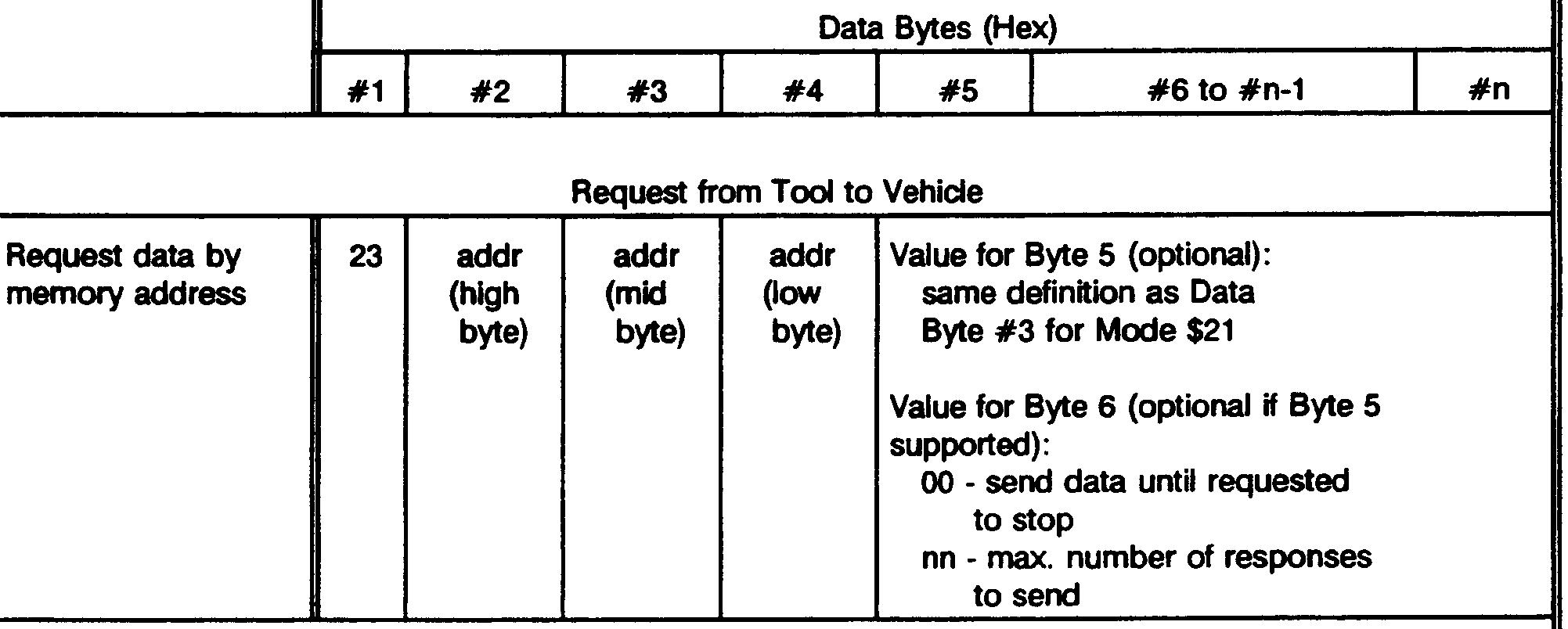

24 10 F5 23 09 FF 14		Mode 23 Request Diagnostic Data by Memory Address (RAM???)
C4 F5 10 63 FF 14 31 52 32 33	Mode 63 Report Diagnostic Data by Memory Address
24 10 F5 23 09 FF 18		Mode 23 Request Diagnostic Data by Memory Address
C4 F5 10 63 FF 18 45 44 20 2A	Mode 63 Report Diagnostic Data by Memory Address

EecV Memory Map
Name	Address		Physical Address	Size
Bank_0	Bank 0		0x02000-0x0FFFE		0xE000
Bank_8	Bank 8		0x82000-0x8FFFE		0xE000
Bank_9	Bank 9		0x92000-0x9FEFE		0xE000
Bank_1	Bank 1		0x12000-0x1DFFE		0xC000
