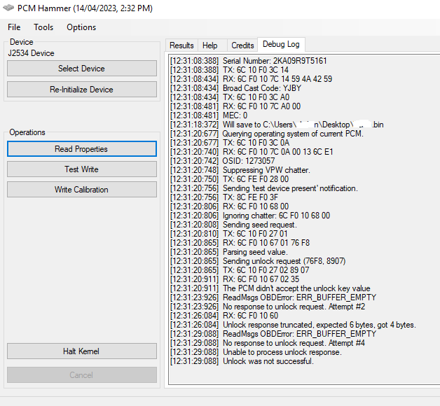

Hello team,
Many thanks for taking the time to read such request. I have decided to attempt to retrieve the binary file from a Holden 2005 VZ SSZ 5.7 gen 3 commodore.
The tool I have been using is the VX NANO/VX diag that supports SAE 2534. I can confirm the unit works as I have used Tech2WIN to read the cars PCM and DTC error codes.
I have updated its firmware to the latest and it seems to read the ECU fine (VIN, voltage ect) but builds a 0 byte bin file when selecting to read entire PCM option.
I have not used an OBD scan tool as i don't have one that is supported within pcm hammer)
I have attached the debug log and user log. (****I have added XXXX to certain areas within the user log )
I have tried variant settings and drivers within the PCM hammer application with the same result, can someone kindly assist where I'm going wrong here? Thanks

Thanks for reporting, its failing because OS ID: 1273057 is not in its database and size is defaulting to 0. If your technical you can get the source code from github and add the osid and try again else one of us can add it and send you a test build. 127... sounds like it might be a proprietry patch on the OS and theyve changed the ID to reflect this.

Many thanks for sharing the beta version, I'm afraid there is an unlock error once i perform a read of the PCM.
I overwrote the current files and executed the application ( pcmhammer-1mbcos.zip).
Is there anything that needs to be done on my end?
FYI, I have received some intel on the car, it seems to have been tuned prior. Would there be a tuner lock causing this? but then counter acts from previous version of which the PCM hammer .021 version allowed to unlock the ECU?

abs351,
You have a few choices,
1. Open the PCM and use the 'Short Trick' to glitch past security.
2. Use Universal Patcher J-Console with the attached script, I'm told it can take up to about 30 minutes, downside, UP is complicated!
3. Use a Brute Force program floating around here that may or may not work and can take as much as 7 days to complete, it's easy to use, downside, time!
You are using J2534 so I highly recommend Universal Patcher!
Here is how,
Download the latest package here: UniversalPatcher-Full.Zip
Unzip, and run UniversalPatcher.exe
. Select Menu: Utilities
. Select: Logger
After Logger opens,
. Select Tab: J-Console
. Select: Device Type
. Check: Timestamps
In group box Protocol 1,
. Select Protocol: J1850VPW
Make sure PCM is powered and ignition is on.
. Select Button: Connect/Disconnect
The Logger should be running and you should see green (received) data flowing ...
. Select Button: Upload script
. Select: Attached script ($10_brute_unlock_var_algo.txt)
You should see it running, it should be showing red (Sent) and green (received) data ...
Watch the lower Console pane for the word 'Done'
Now scroll the log back to the very last red line and you should see something along the lines of (without my comments),
So, close Universal Patcher.
Open PCMHammer
Select device if required.
. Select Menu: Options
. Select: User Defined Key
Enter your key, select OK
. Select Menu: Tools
. Select: Read Entire PCM
See if that gets the read done for ya!
-Enjoy
