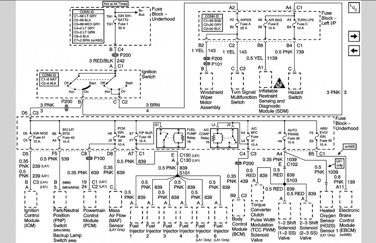

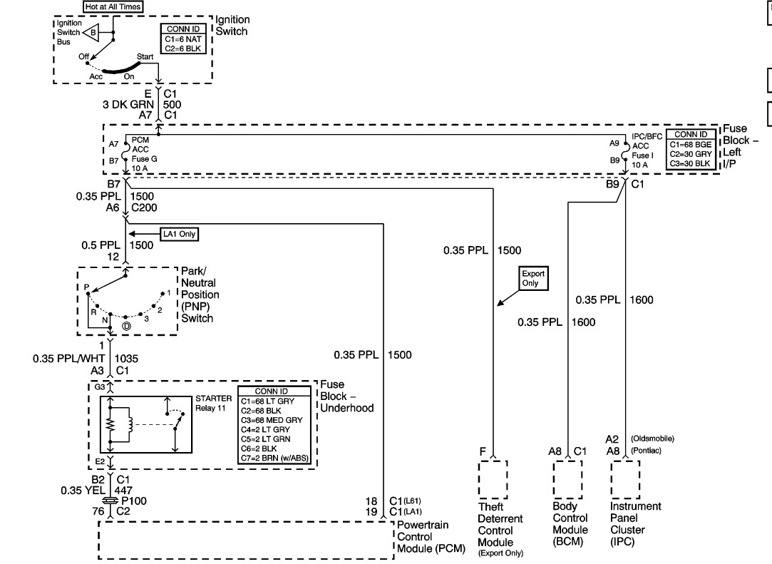

Here's the acc ckt.. Hopefully it's easy enough grabbing power off one of these ckts.
this is ign ckt.. grab off the ckt that doesn't power down during crank so turn lps and airbag in the left ip?? assuming you don't want to go under the hood.. other ckt for the wiper fuse powers down during crank, pita when the radio blanks out like that, lol..

I'm not seeing any rap ckt in the pwr window schematics, do the power windows work with the key turned off until you open a door or 10 minutes have expired?
