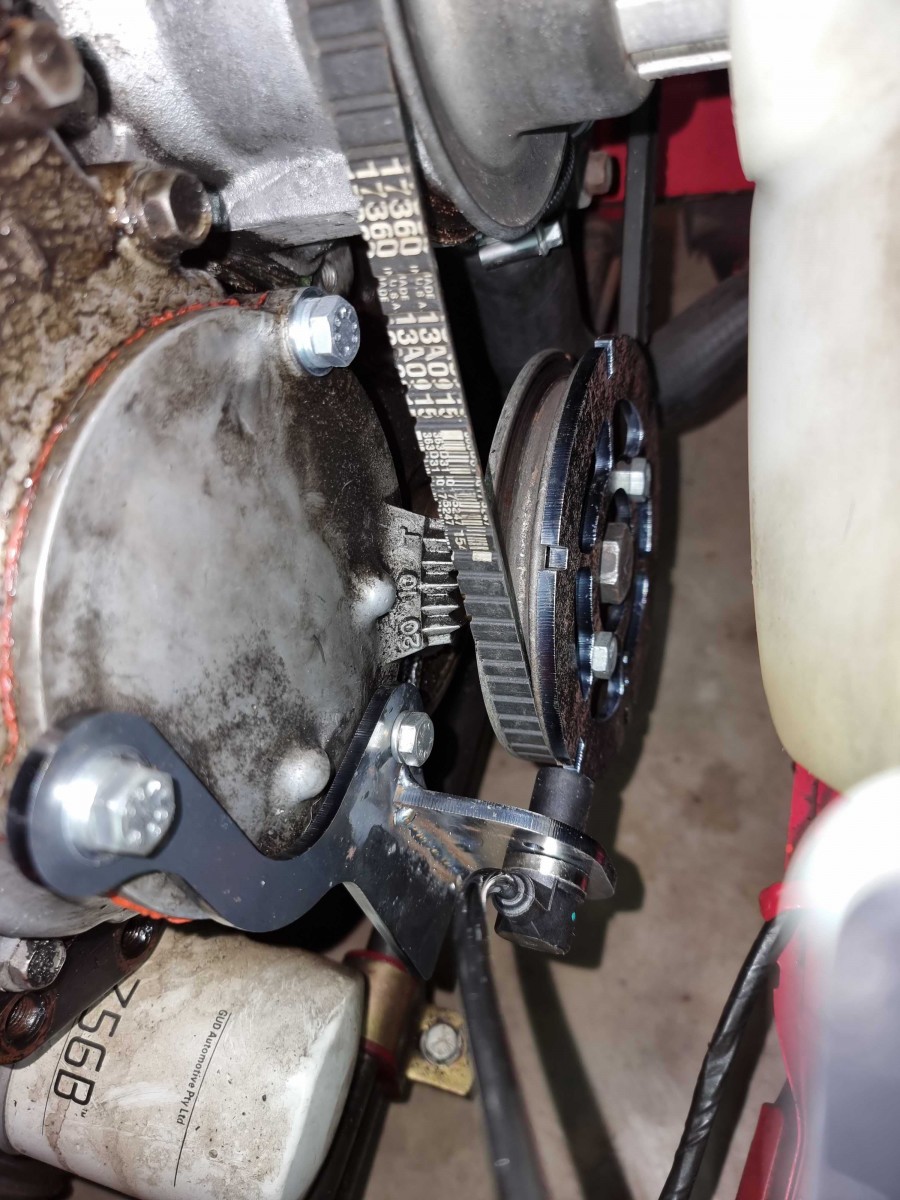

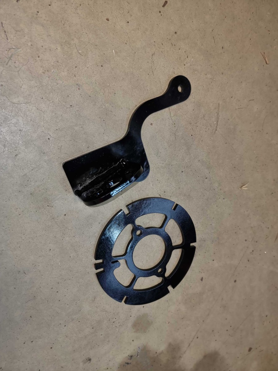

is actual Engine TDC the mark to the right of the 300 ? if it is that should be pretty close with the longer slots you have!
you should be able to crank the engine over with no plugs installed and a timing light on it and see where the static timing is before you even try to fire it .....

The motor in the picture was at TDC when the picture was taken. The longer slots allowed me to slide the wheel to line up as shown. I've recently installed the motor and confirmed oil pressure, next is confirm spark then fuel and hopefully broom broom.

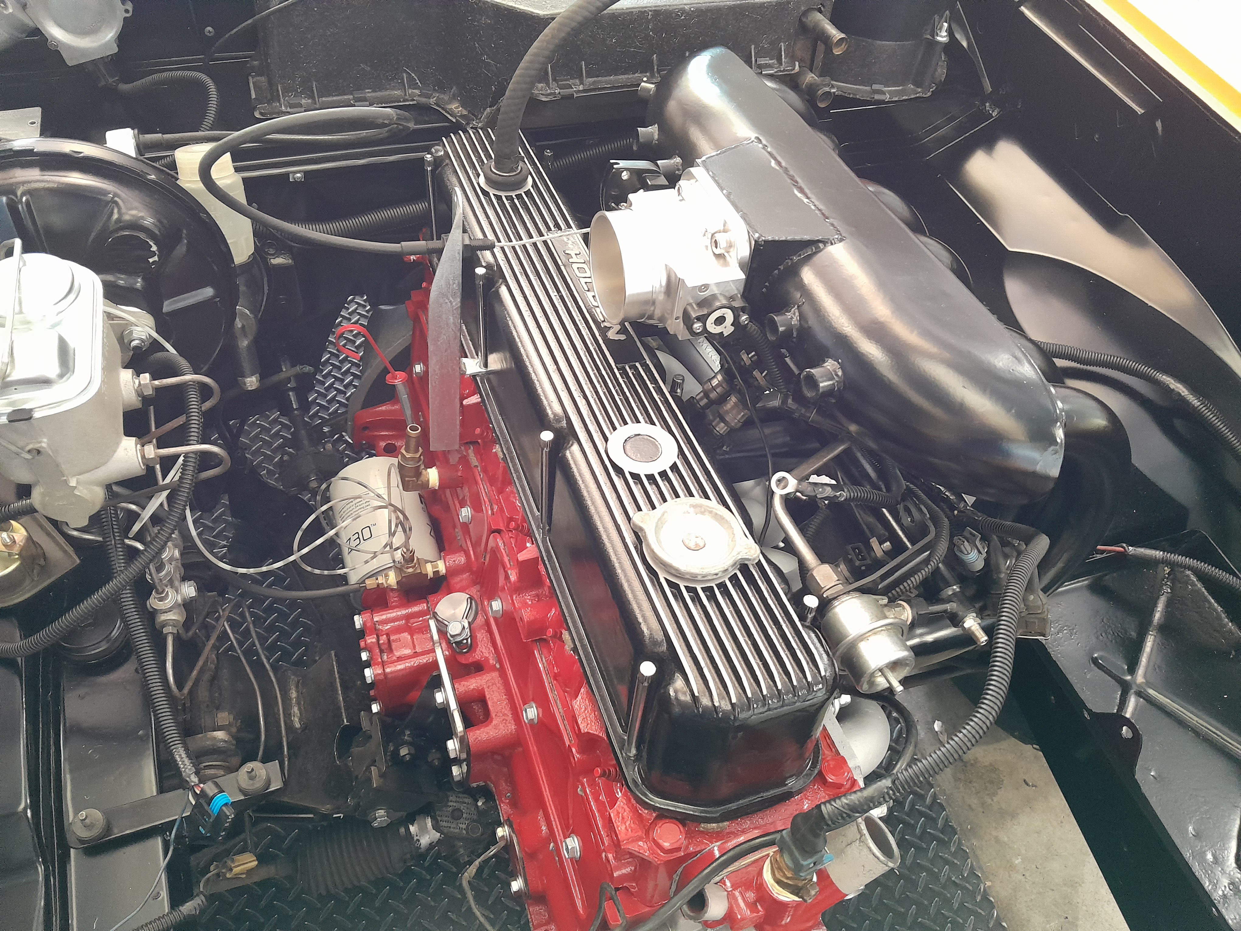

Currently looks like this
