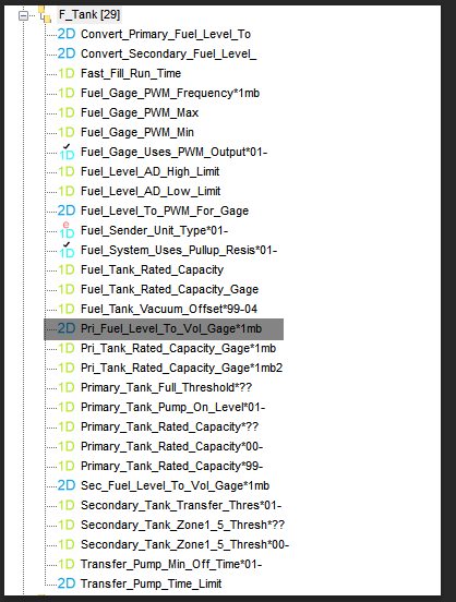

I had the same issue, I swapped from an 0411 to a P59 using the 7603. The solution I found is to go on universal patcher, use an 03 bin file with the right sized tank as your compare, and the copy the table in this parameter, and this should be the only table you have to change.
From what I've read in 04 they got rid of the fuel return line, also in 04 they changed the sending unit to one that reads the AD counts inverted from the from the 99-03.
