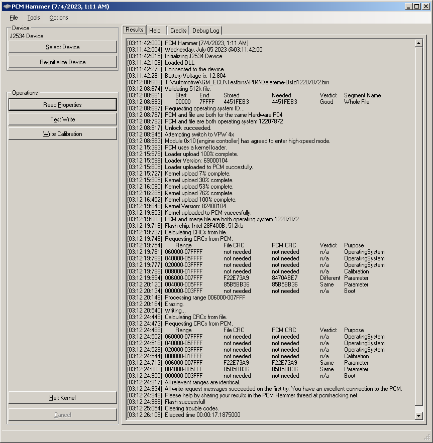

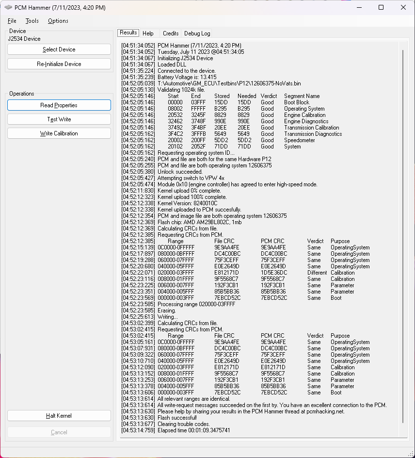

Going to add this here since this thread is about P04 dev which is close enough to P08. So I managed to damage the param block in on my P08 with some develop kernel code. It ended up looking like this:
This was an interesting one to recover. Trying to use regular off the shelf tools, seed = 0000 was returned, which usually means unlocked. I could guess that if the see was coming up as 0000 then probably the key was 0000 as well. But no tool that I had available would attempt to send a custom key if the seed was 0000, they would just proceed to the next step and get the mode 36 rejected.
So, this where the P08 BDM came in to it. Those details are here: viewtopic.php?f=42&t=6215&hilit=p08+bdm ... 00#p123110
All good I thought, I could erase, and write the flash without error. I failed to check exactly if the 0x4000 sector was recovered, because I could see the boot sector was all FF after the erase, and populated after the write. I naively assumed (dangerous!) that is was fully successful and moved on.
Today I hooked up the P08 ready to continue where I left off. Same problem - couldnt unlock. I looked at the debug console still 0x0000 seed, and still skipping the unlock. So I modified PCMHammer to not return if seed=0000 and set a custom key of 0000. Bingo! I was in. The screen shot above shows what was read. There were various retrying on the 0x4000 sector, obviously the chip was still not in a good state. And BDM was not going to get me out of this. I feared damage to the flash chip. So before giving up, I hooked up one of my commercial tools, and pcmhammer at the same time with 2 different interfaces. I put an hour long sleep in pcmhammer so it'd go silent after sending the key. I then let PCMHammer perform the unlock, and then started the write entire in the other tool. This worked! And running through a proper erase process got the flash chip back in to a healthy state. So now, time to break it with alpha quality code again lol. Hope this helps someone if they ever find themselves in a similar position.

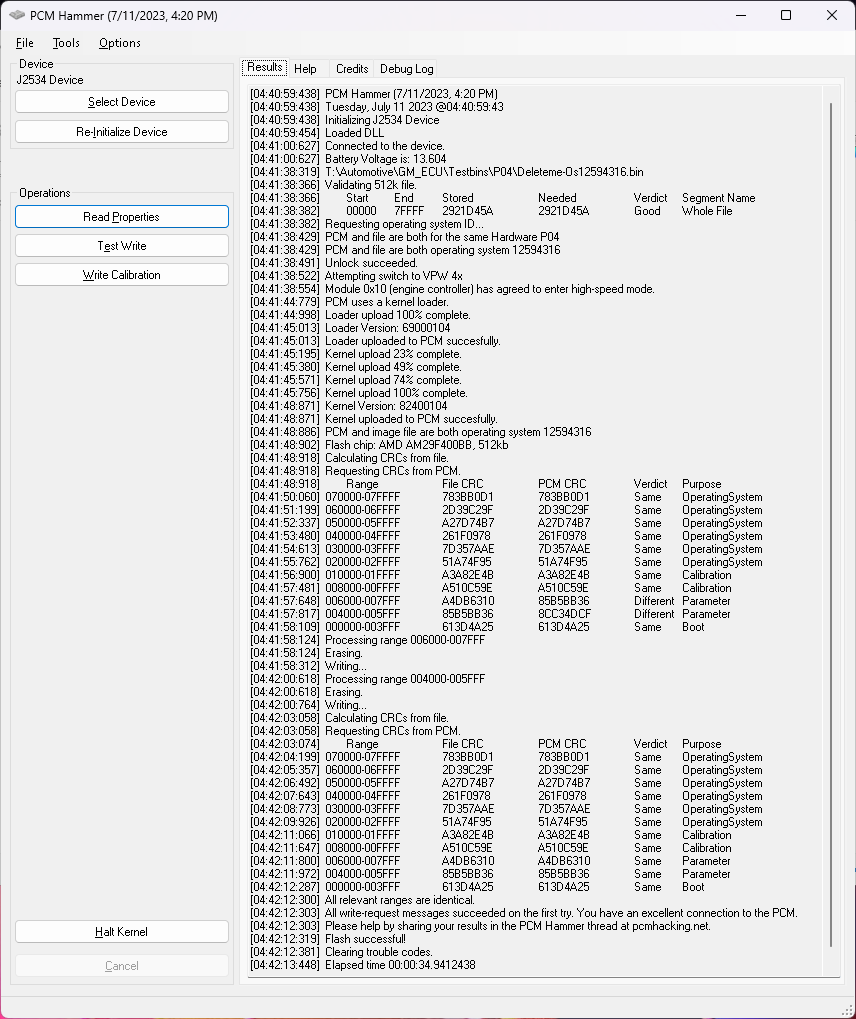

I was able to erase a block and write 2 bytes (more on this later) on my P04.
I'm working from an older version of PCM Hammer that doesn't use a loader for P04. I'm also using my testing/debug kernel.
Parameter Block 0x006000 - 0x007FFF on one of my P04 is empty (0xFF) so I wrote 2 bytes to the beginning of it. Worked perfectly
Reason I can only write 2 bytes is because that's limitation of my kernel at the moment.
I followed that up with a Block Erase for 0x006000 and read the flash. The 2 bytes I changed went back to 0xFF 0xFF.
Next I'll add to my kernel the ability to write more than 2 bytes.

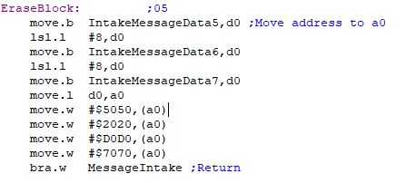

The Erase function from my kernel (Using Easy68k)
Re: PCMHammer P04
Good news from my endeavors. I am able to erase and write to a P04.
Code still has some issues but its enough to fully program the flash and come back to fix any miss writes.
As you can see from the log, it had to rewrite the Last OS sector twice.
It doesn't matter what kind of write I do, its always the last OS sector... Probably another timing issue.

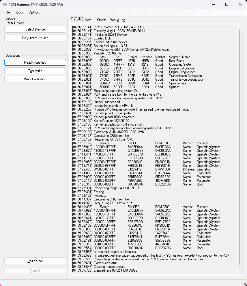

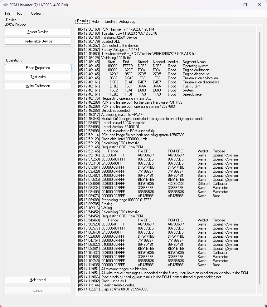

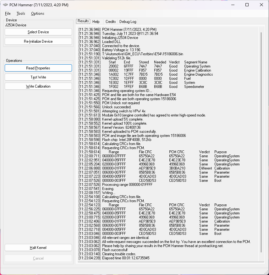

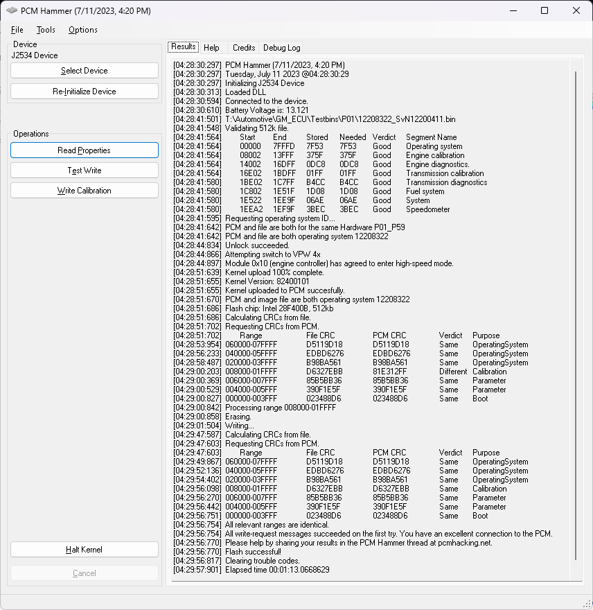

Well done!
