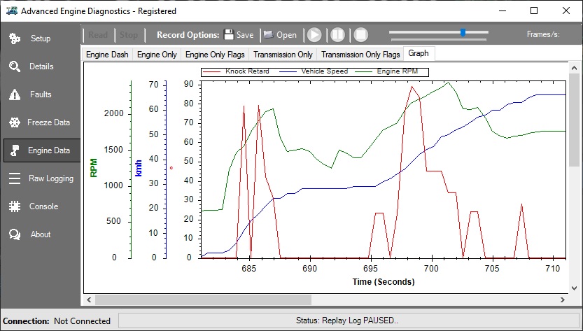

Depending on what you are looking at for the knock, its possible its normal. I am not close familiar with VX but I know it has a high and low octane spark table and uses knock detection to figure out where it needs to be between the two. It'll gradually push the limit to increase spark to get the advantage if you fill up with higher octane fuel, and it'll pull back if it sees knock until it goes away, or it hits the minimum in the low octane spark table. It could be this function happening normally, and it could be real knock and the pcm doing the right thing depending on the quality of fuel. Unless you know for sure you have a problem with the false knock detection, I would not touch that part of it. One day when your tank is low it might be worth putting some premium 98 in it and see if it makes a difference.
Having said that noise in an old engine can trigger false knock. But the knock system in these PCMs is tuned to the frequency of expected knock in that engine, so I do not think transmission vibration would likely cause it as that'd be a very different frequency sound, though it is not impossible.

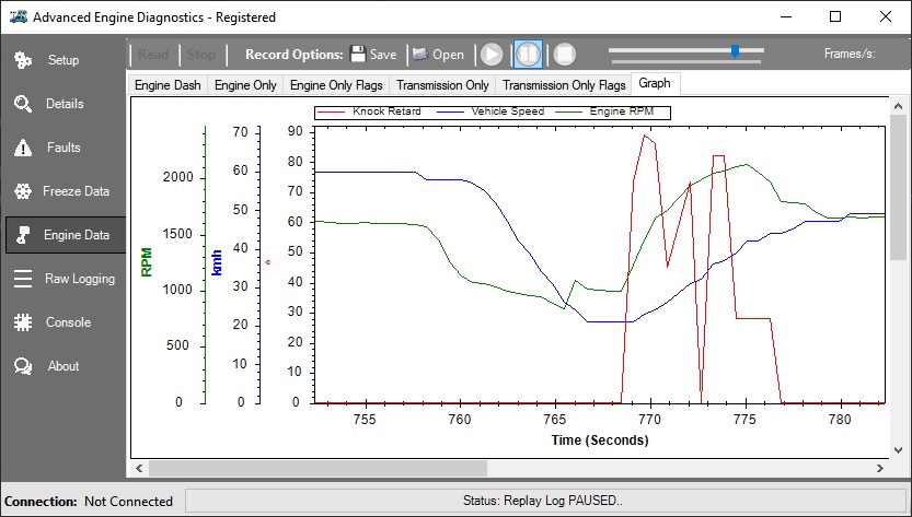

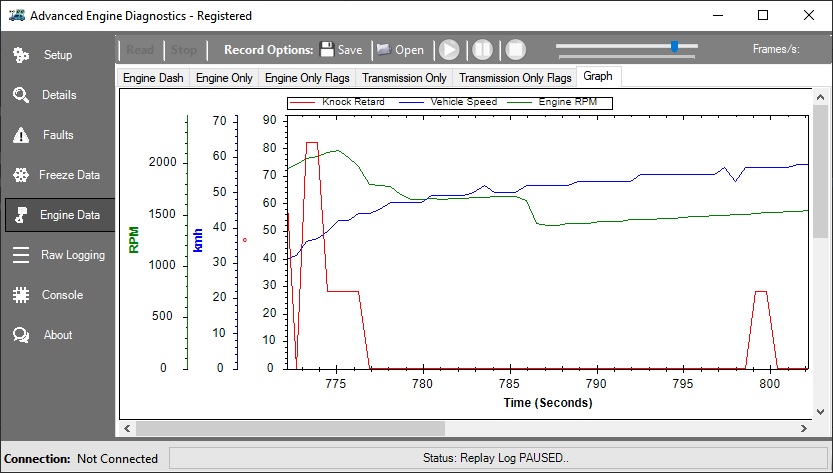

I had forgotten about the knock detection being used for fuel/timing table adjustments. Maybe I am overthinking it, or just hoping to find a fault to resolve the issues.
Keeping in mind I don't hear or feel any knock in the engine. The knock in the log files is only relatively brief and does seem to be on acceleration. I haven't compared the speed/rpm to see if it is at gear changes. Though thinking about it, if it was the transmission causing knock detection. I would also be experiencing it when driving over a pot hole or corrugated dirt roads. Which could pretty much disable a car when driving on some SA roads.
Here is three sections of what I am seeing, is it pretty normal then and should I not worry about it?
I see that in Cruise Control, the car goes in to Open Loop mode, the knock retard is actively changing and the AR is up around the 15-17. is that normal? It seems logical to me to be the case.
Thanks.
