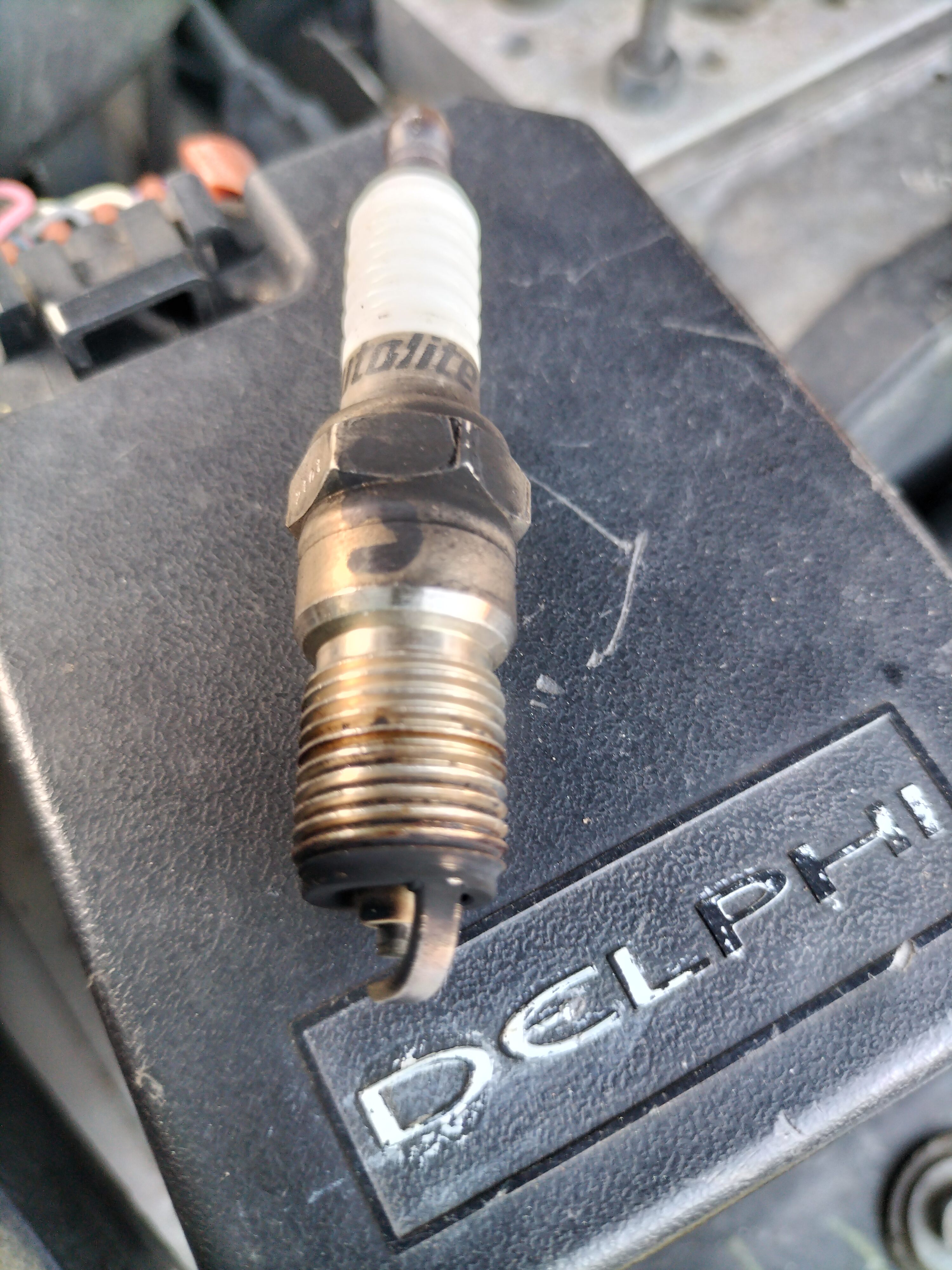

I still had what seemed like miss firing causing a slight roughness at idle. So I went back over the typical things, checking for any obvious issues or signs of failings. On removal of Spark Plug Cyl#5, I noticed some carbon around the outside of the plug.
<IMG20230824162105.jpg>
This turned out to be coming from the exhaust manifold gasket just above the plug. So I obviously checked the manifold bolts again for tightness. Believe it or not, all but one bolt on each of the manifolds were slightly lose. About 90-270 deg turns required to tighten back up. These weren't lose the other time I had checked them just around the time when immortality had his issue of similarity. (Thanks again immortality for mentioning that.) Unbelievable, but I am continuing to monitor these bolts. If they come lose again, I will lock tight them in next time. I am still working on repairing my home made smoker machine to test the system again fully.

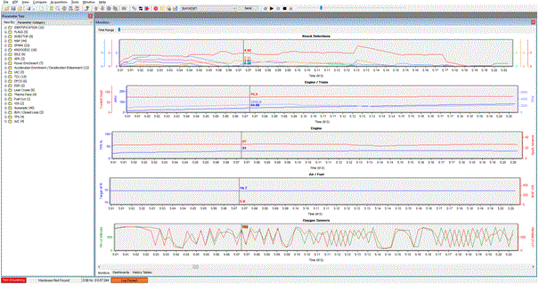

So I have been running further tests as it still had very poor performance when driving. TunerPro seemed to show a spark timing retardation in relation with knock detections. Not knowing if the original sensors are faulty and getting phantom readings, I thought I would disable the knock detection as a diagnosis method. The car had a noticeable feel of improvement in its performance without any audible knock that I could hear anyway. So I started looking at possible causes for the knock detections. I did enable the knock detection again, while also reducing the knock detection severity of spark timing retard. I have come to the conclusion that the knock is only happening when a lean mixture is happening. This occurs (according to TunerPro) under acceleration times mainly. As the car obviously self retards accordingly. I am talking <5 deg retarding before knock stops, so not major, I don't think. I am still unable to confirm if the original knock sensors are faulty, worn out or still working ok. But for now they seem to be adequate. The car seems more responsive and performing a lot better than it has for many years. :D
I have also been running in cruise mode as much as possible to hopefully self clean the cat in the exhaust (thanks again immortality). I cleaned the tailpipe end to help in monitoring its new carbon build ups. It is nowhere near as black, but more towards grey colour. Due to previously bad injectors.
Now to current day, I still have the (slight) knock detection under acceleration which I am trying to tune out. While I am also hoping to rebuild my smoke machine to do vacuum and exhaust leak testing soon. I am yet to do a actual fuel economy check as fuel is just ridiculously expensive her at the moment. But I will give you an update when that happens.

Fit a set of exhaust manifold gaskets, from the factory there are no gaskets and with thermal expansion and contraction without any give the bolts come loose which is why from the factory they have those half moon straps between each set of bolts. Once those are removed they will forever come loose, fit a set of gaskets and there is something that can handle a bit of expansion/compression and should help with the bolts coming loose problem.
