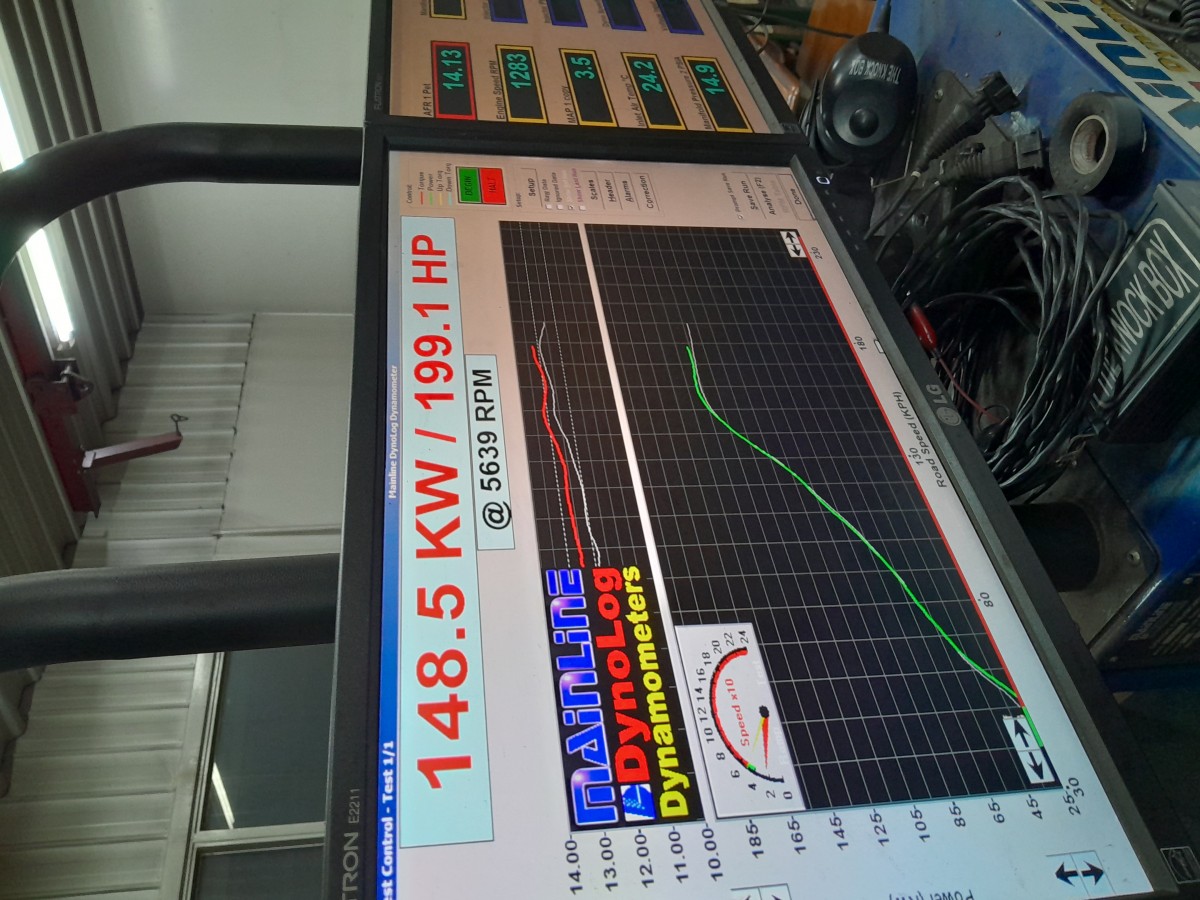

Had the car on the dyno Saturday.
All running sweet but idle still a bit average.
Considering adding an IAC to improve it.
Happy with the results regardless
Posts: 9014
Re: Converting 202 to DIS
Nice one! Yes IAC is worth it, especially for cold start where it can add air so the ecm can add fuel, thus its you're choke.
What cam specs and other engine specs does it have? That's quite a stout result :thumbup:

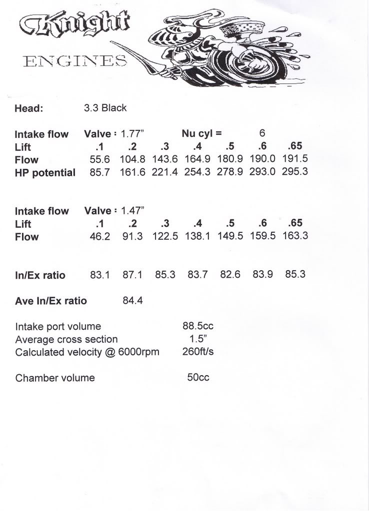

Attached are the Head flow and Cam specs.
The rest of the package is just your standard 202 stuff. Flat tops, Starfire rods, balanced, oil system opened up etc.
That's a pretty decent sized cam. :thumbup:
