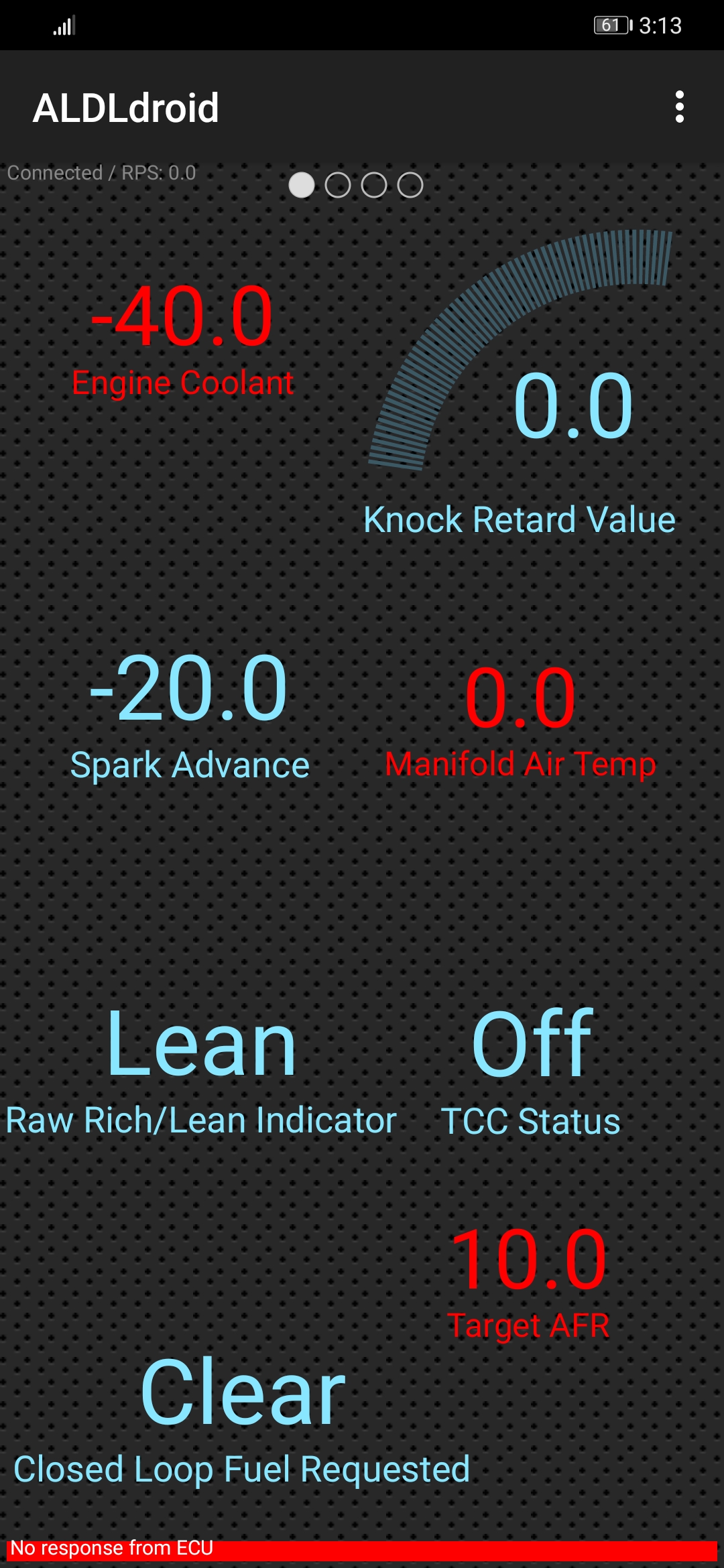

Sometimes when I try connect
It just says connected no responce from ecu and takes me a good 5 or so goes of unplugging the cable shutting down software and retrying to get it to work again.
See picture below of when it happens

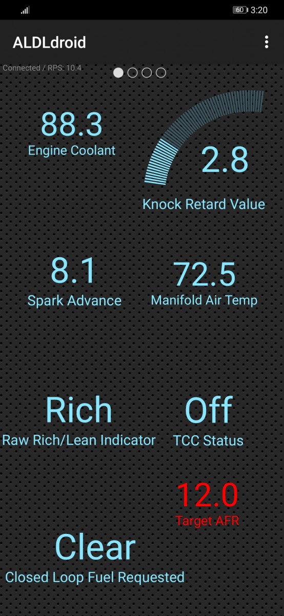

Also I have been watching my knock while driving and using 91 and e10 fuel. Sometimes it shows in red other times in blue. What does it mean when it's in red?

Red is danger to manifold....
But seriously it's when the item is close to or at it's programmed limits, these can be set in tunerpro in the ADX.

I only have the knock control being able to remove Max of 3 deg of timing could that be why I see it going red now?

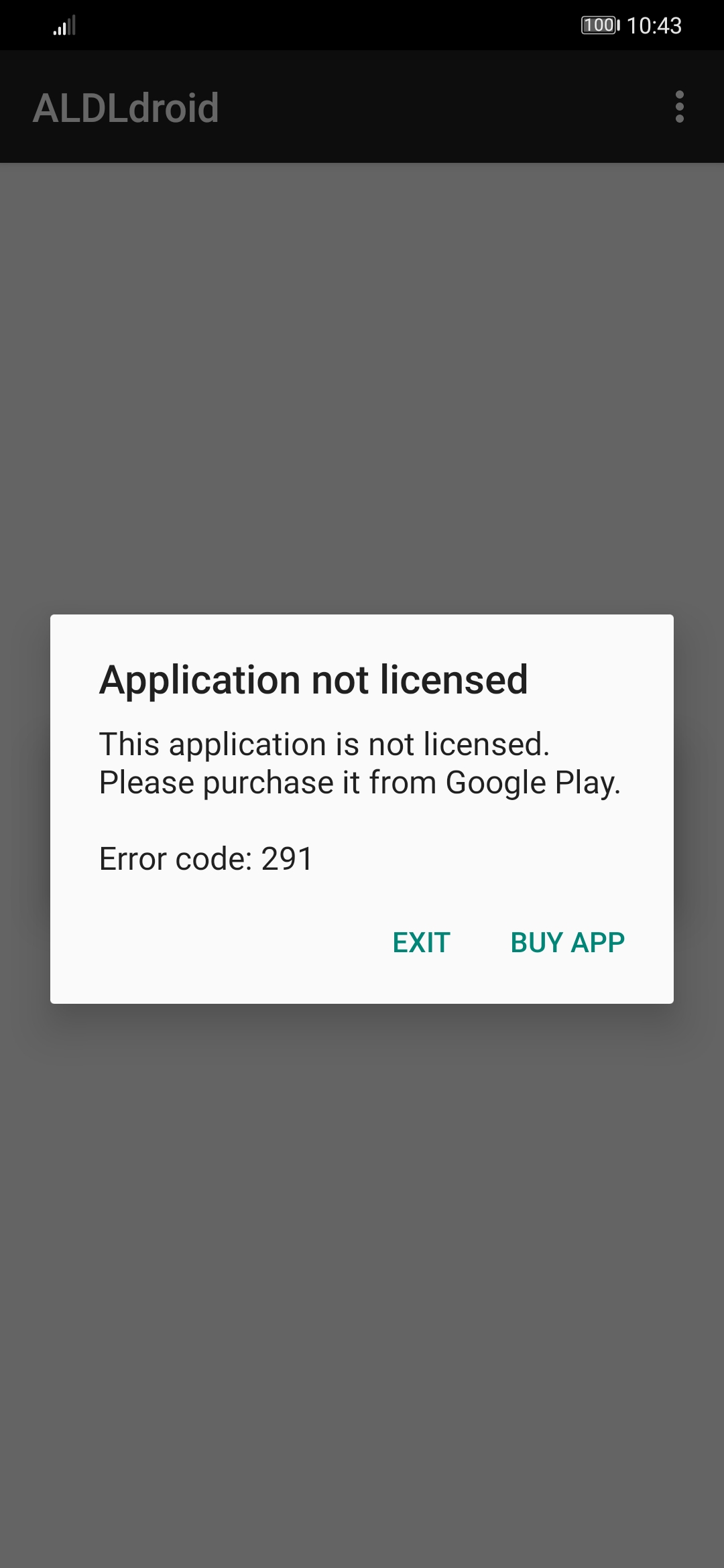

You need to connect to the Internet every once in a while for the app to validate your license. Once you do and restart the app, this message won't be there
Re: ALDLDroid Android App
Dam something so simple just done that and back working again
