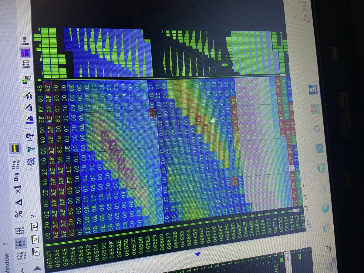

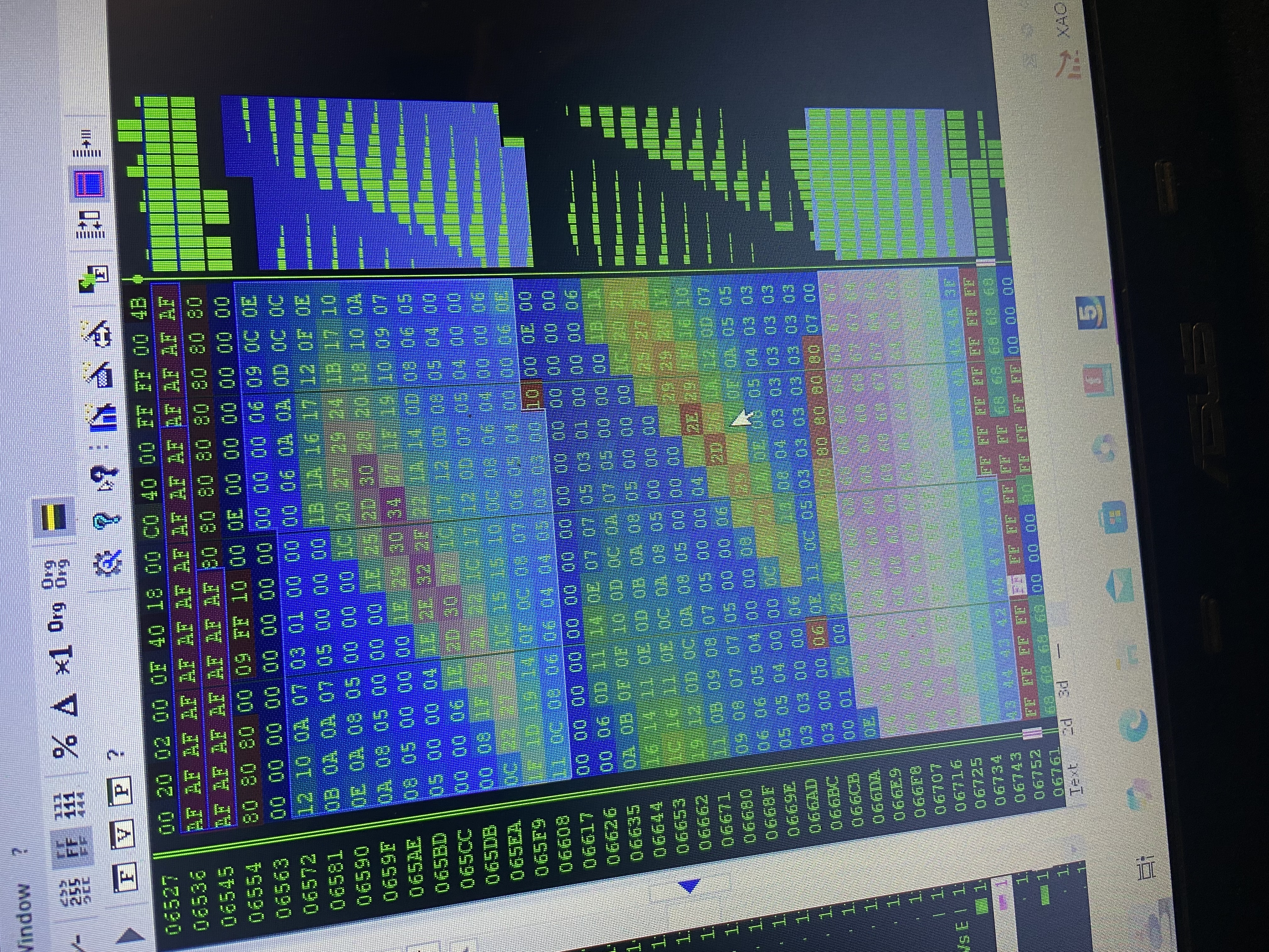

I’ve just noticed in the vy n/an enhanced xdf that there’s a few defined table that overlap at the same hex addresses. Would this cause issues when making changes to the bin? I’ve seen that some of the maf stuff overlaps and closed loop air fuel ratio in blm /closed loop is at the same address as stoic afr table
Wade
Posts: 1106
Re: VS-VY Enhanced Factory Bins

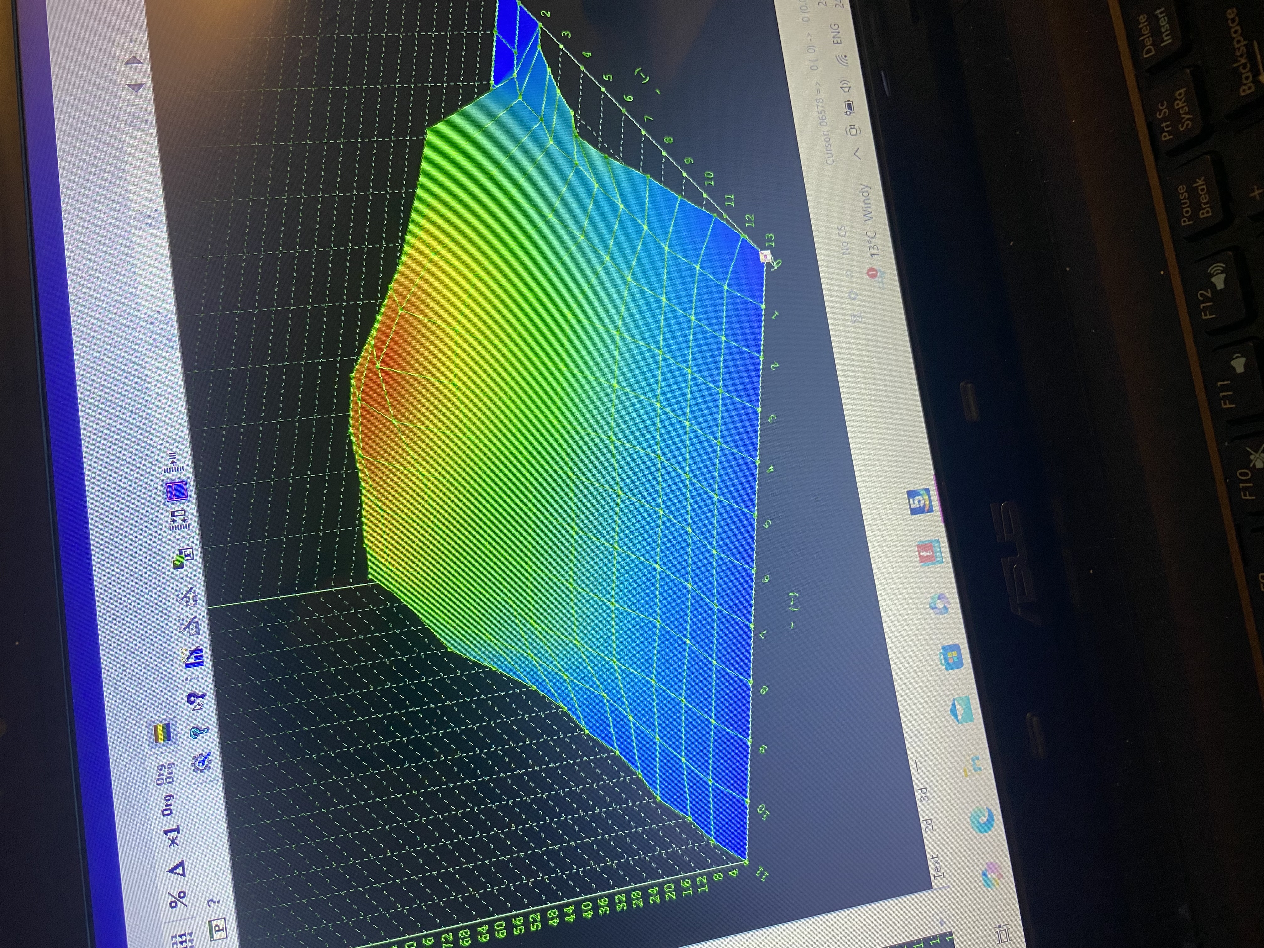

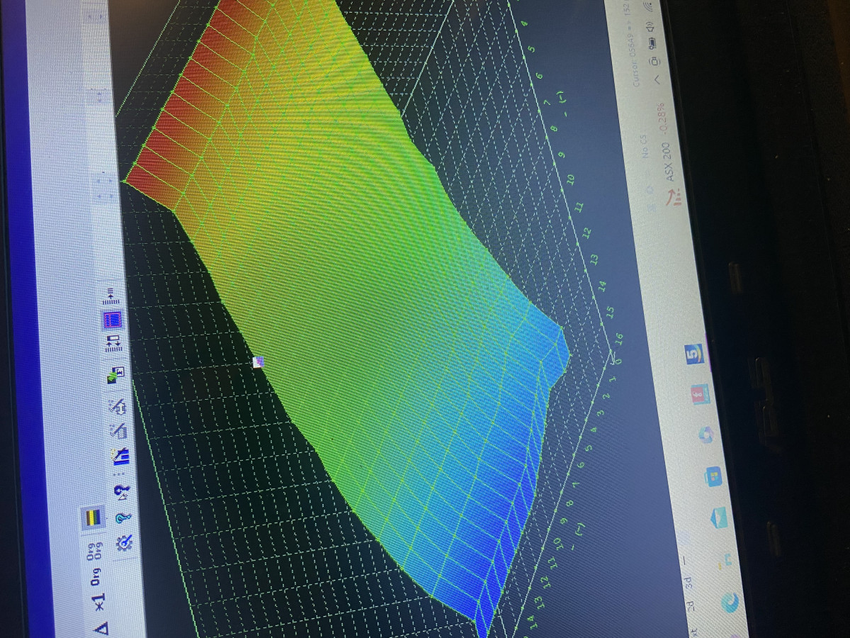

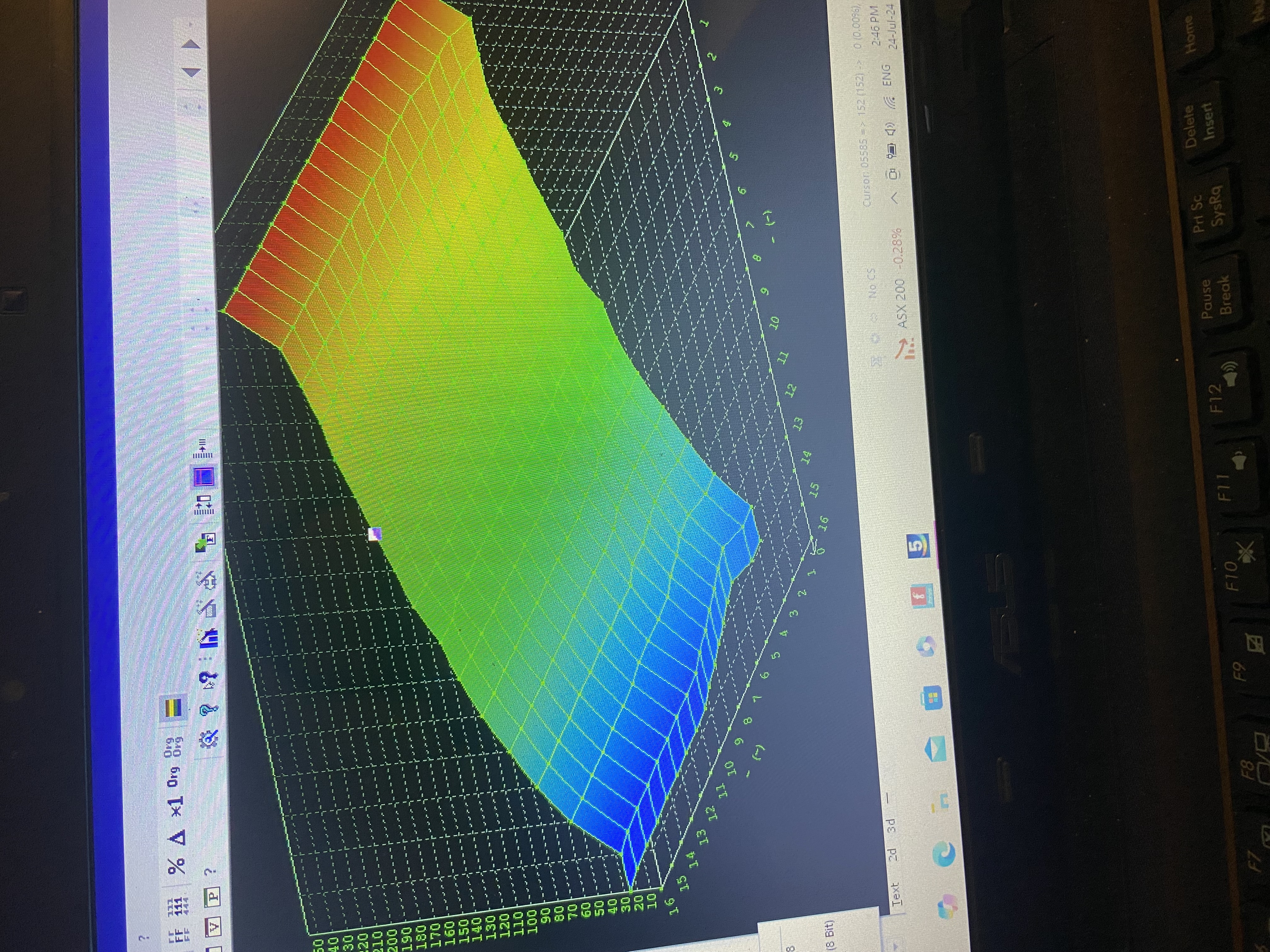

Post by Wade »
I’ve found a few, what look to maps in the enhanced vy flash bin. 2 look like trans pressures. Very similar to the 2 force motor maps already defined? And another 2 that look like ignition timing maps but possibly for idle? Just like in the ls1 bins there 3D can anyone help with some guidance?
Wade
Posts: 1106
Post by Wade »
ive chucked some of the things ive found into this xdf ill keep working on it later. if anyone wants to have a look and or help
new maps VY_V6_$060A_Enhanced_v0.9i.xdf
