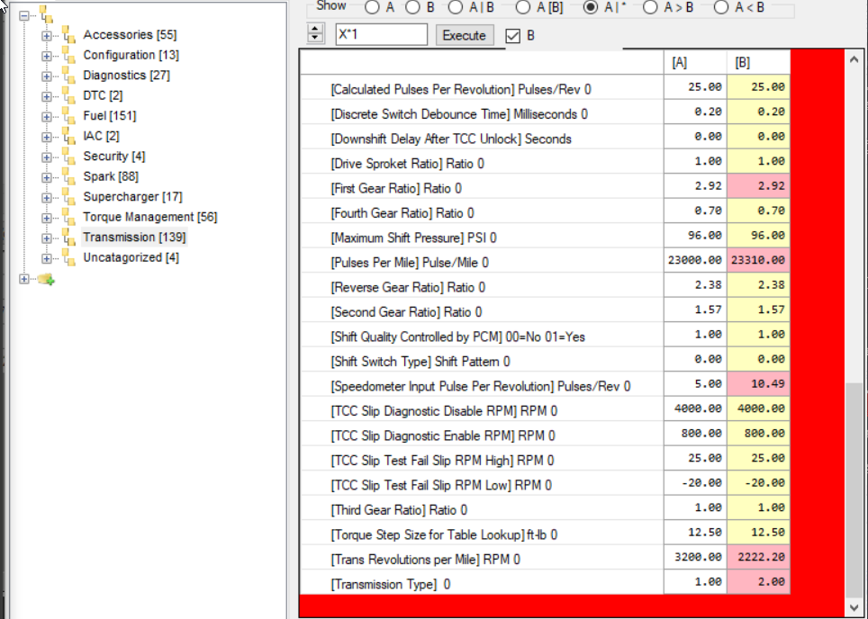

Mustangsix wrote:What should the VSS ppm be?
I compared the closest bin I have to yours, its the same OS and the VINs in both show that they came from 04 Impalas, here's what it shows as the ppm. A is yours, B is stock as far as I'm aware.
It strikes me as a little odd that in the stock bin, trans revolutions per mile * speedometer input pulse per revolution = pulses per mile as expected, but in your bin they're off.

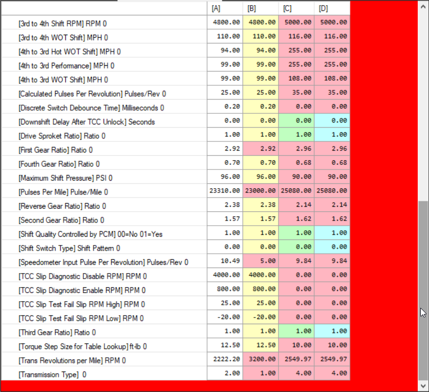

Probably not in this specific case because I don't think Mustangsix's bin is actually from an Alero - the vin number in that bin is for an 04 impala, and its the same OSID as another 04 impala that I have. the file is almost identical to the stock 04 Impala file I've got, and there are far more differences between the posted bin and the stock 03 and 04 Alero files I compared to.
For reference, here are those same transmission tables from my last comment again but now including a couple Alero bins- this time A is a stock 04 impala, B is Mustangsix's bin, C is a stock 03 Alero, D is stock 04 Alero.

Post by MudDuck514 »
Thank you for showing this.
Most definately can see the major differences between the two trans types!
Some of HIS are WAY different than either stock trans type settting.
