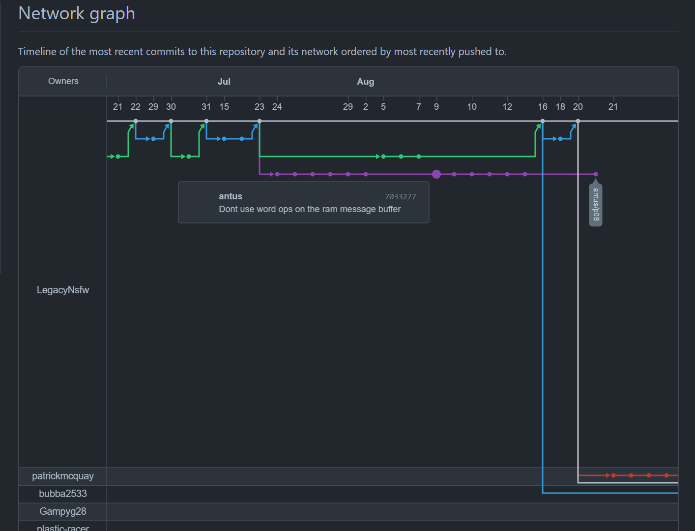

ProfessWRX wrote:Ah I thought there was a record of breaks and builds you guys kept.
There are notes about what changed and why in the commits on the branch, but in general we're tracking what works, not what does not.
For example you can see a single commit with some P04 fixes here https://github.com/LegacyNsfw/PcmHacks/ ... 1ea08ab8db
If you go to the network view in gitlab you can mouse over the commits on a branch and see the notes, then click the commit and see what changed in that commit.
