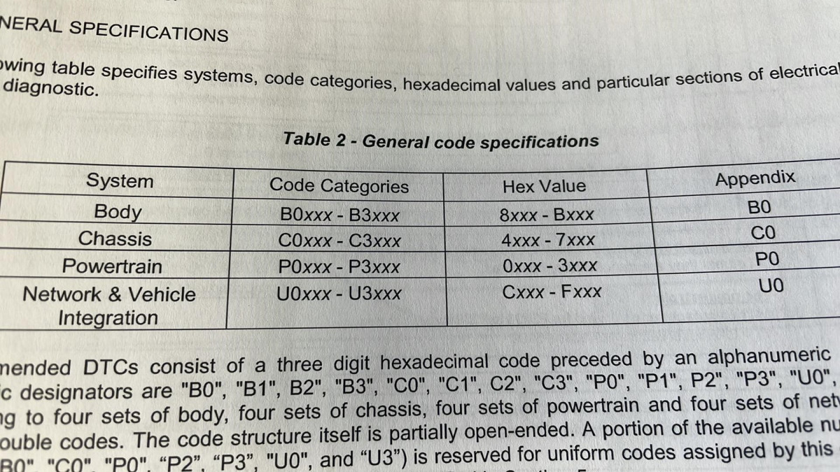

i found the MAF table its split Low and High i used a GM scale factor and looked reasonable on the data. I also found the dtcs which are like some of the Big truck Isuzu stuff ive seen as in not in order. The dtc right next the the hex code. I didnt go though and convert the whole hex to SAE but you get the idea.. found this stuff in Winols and exported to an xdf
