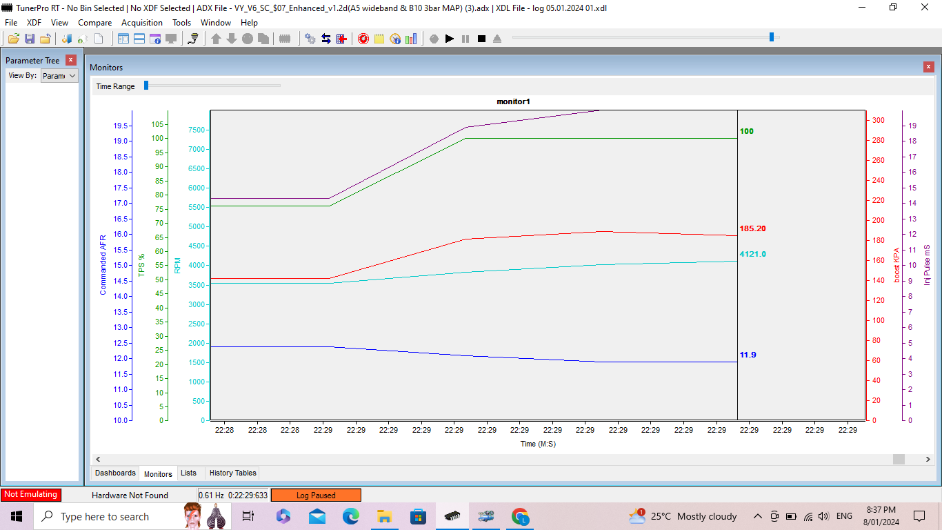

It is very odd though that the PCM is commanding 11.9:1 and you are seeing 10:1. When you are at WOT the tune goes into open loop mode and runs straight off the fuel tables (VE? Assuming Kalmaker is MAP based) in the tune with compensation for things like MAT and coolant.
I'm really not familiar with the changes Kalmaker has made for the VY tune to it's a bit of a guessing game from my end. What .bin .xdf and .adx are you using to log this?

this is a screenshot of the adx. ill sen a link to what i did to make it read boost... well what Kojab did lol

What wideband are you running? Are you able to verify it's reading accurate?

You should have got back to me in 2022, was not sure how you got on. There is bound to be more than the Map sensor settings in your ADX which needs to be changed.
Kalmaker often makes changes which are not compatible with Holden bins and ADX settings making it very difficult and impossible to diagnose.
