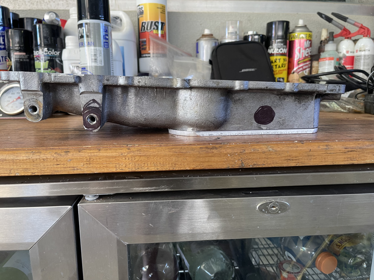

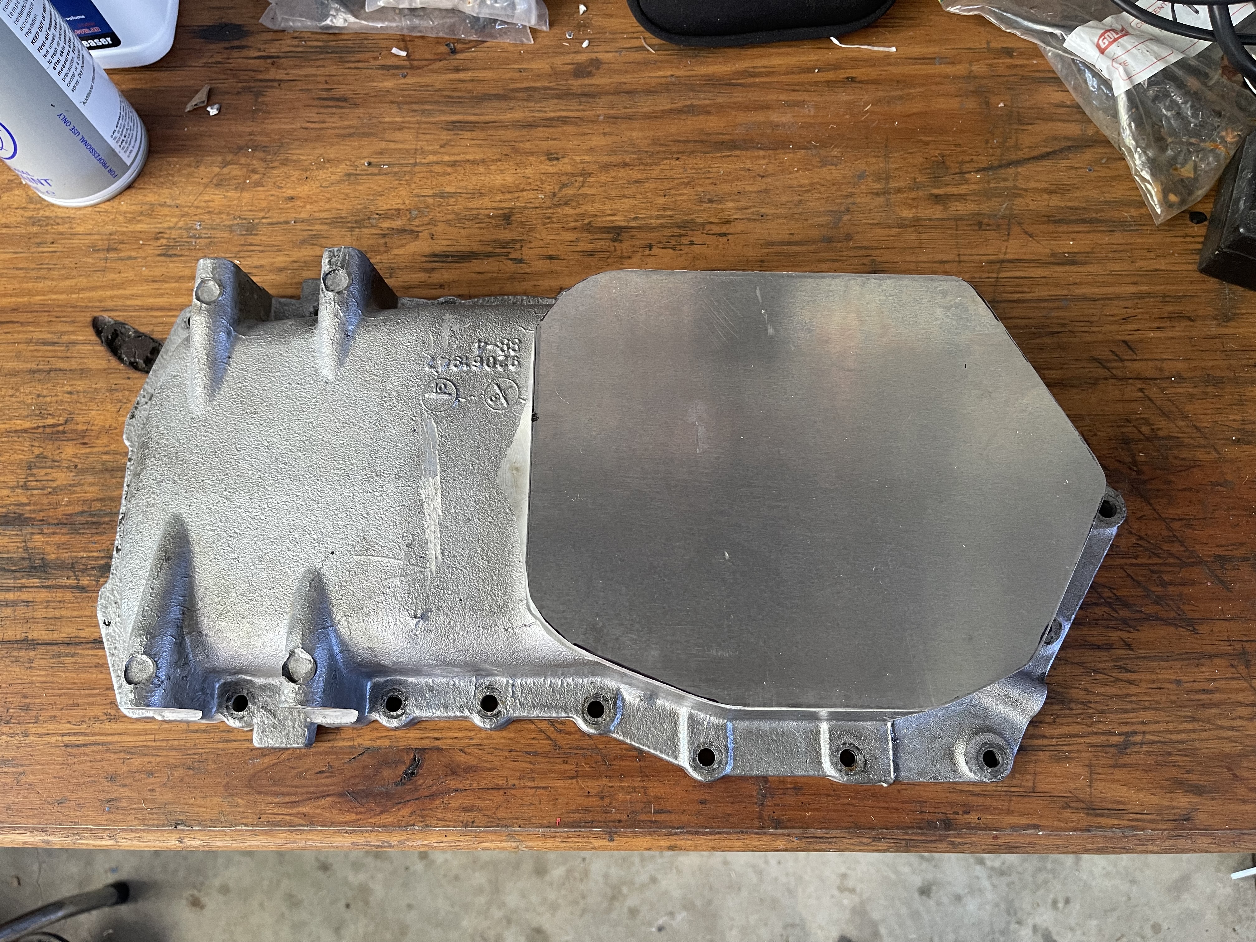

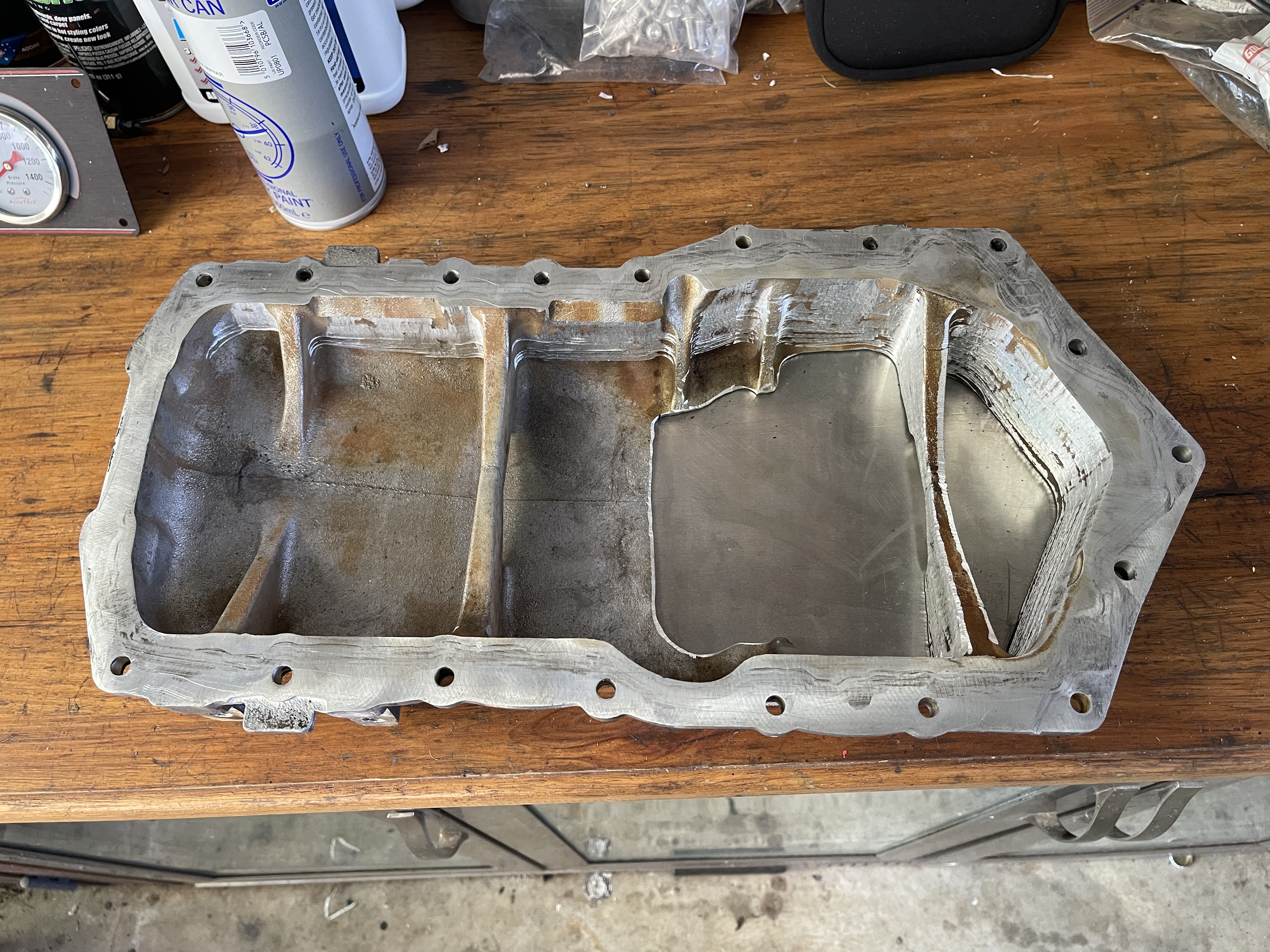

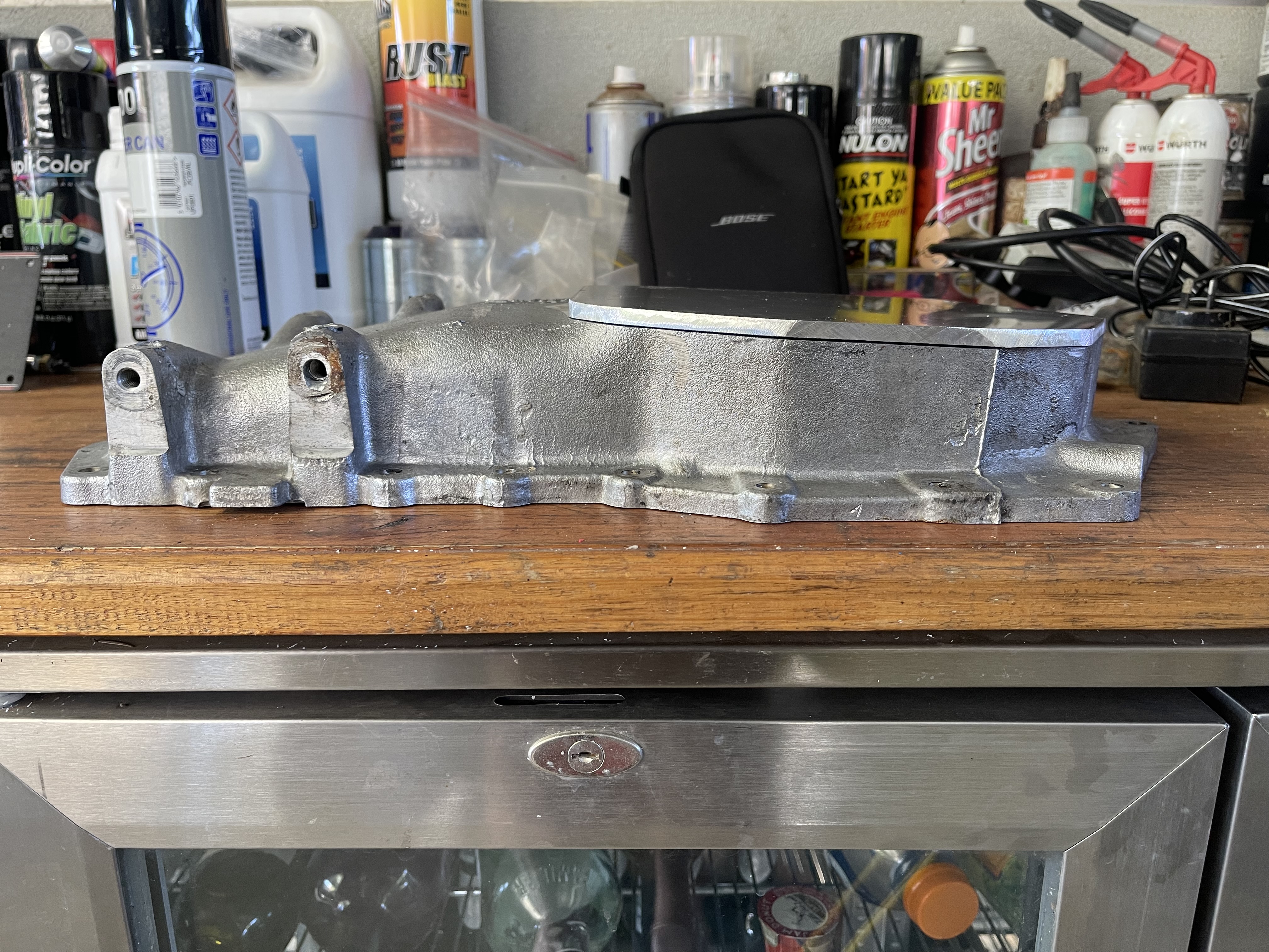

And I’ll add suction outlets here and here
Any thoughts?

[/quote]
Do you not use the rear sump to transmission brace?
[/quote]
Yeah, I do but that one is going to get moved.
[/quote]

I only use one brace on my eco to Buick sump, was in the way of the headers so I have the driver side bosses milled off the sump. They hold up fine. Some VRs didn't even have provisions for those braces for the T5 and ran without just as FYI.

I was thinking the same. There are lots of engines that only have the 6 bellhousing bolts and they all seem fine, I use the brace on the auto because I guess it can't hurt.
