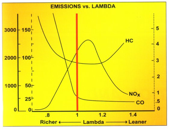

What parameters would I be looking at changing in an L67 tune to reduce emissions, mostly keeping it on the lean side?

I think that by trying to reduce emissions by leaning it out is a double edged sword.
If you lower CO2 output then oxides of nitrogen levels increase.

Re: Reducing Emissions
Yes, indeed. This is the typical the relationship.
