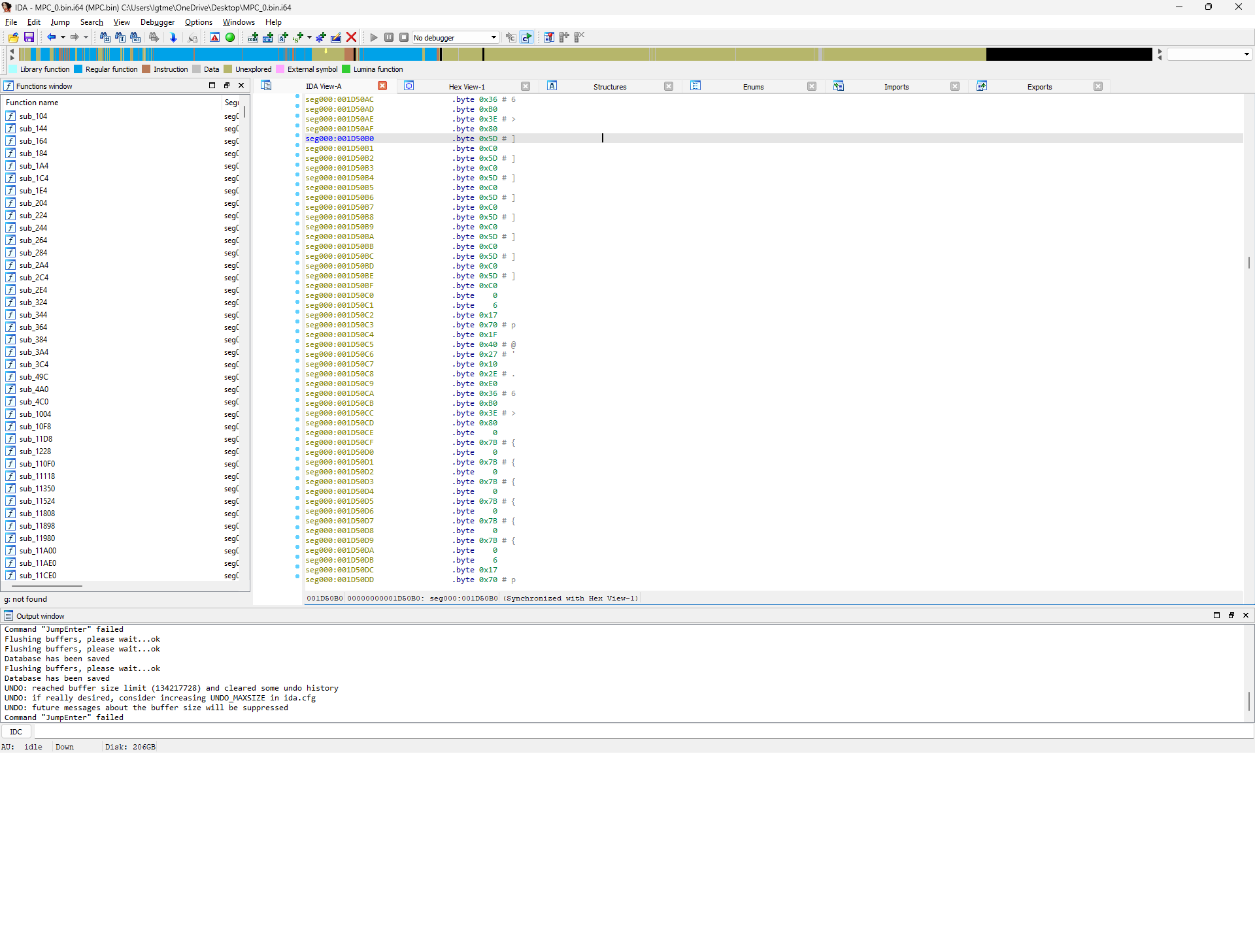

so after doing it all I went to options -> general -> reanalyze program. it ran through the whole thing and made a lot more of the top bar into blue area (regular function). then i did the reanalyze program thing again, and it turned even more area into blue. after this, it wouldnt change anymore by reanalyzing.
so i went and got some map addresses from IDA, for instance:
KLPROV is at 1D50B0. i subtract the offset 1c2000, which gives me 130B0. considering i loaded it at 5c2000, after adding it, it results in 5D50B0. but this is what i get (im now in a whole unexplored portion): any tips to proceed?
- Posts: 10013
Re: Bosch MED9.1.1
Just from eyeballing it, those repeated patterns @ 16 bit values make me think that's calibration data, not code. Also because the arrow in the map at the top shows no code around it. If you have an XDF see if that area or data around it in the non-code section is defined as calibration data.
The red bits are probably vector entry points and the landing point at the start of each one can be converted to subroutine, then they'll go from red to blue. Its also possible they're unused code that was linked in and left behind but because nothing is using it IDA didn't have a reason to call them functions. I've seen that in some of the GM operating systems when looking at flash code (just one possible example) where I can see flash chips that don't exist in the PCM have string references in unused code in the bin, and whole lot of them one after the other in the same area.
If you can find the code that is referencing that location, you'll probably be able to confirm they're 16bit words, and you can convert them to data words, if you want it to look nicer.
For pro level disassembling - and this is beyond most people including myself - it should be possible to write python or IDC code that can search for calibration segment references, figure it all out from logic you write, and update the data types programmatically. This is the type of thing pro reverse engineering shops would have written and keep private and use over and over again. Having said that a lot of reverse engineers share their idc / python. But this is not a road I have travelled for this purpose.

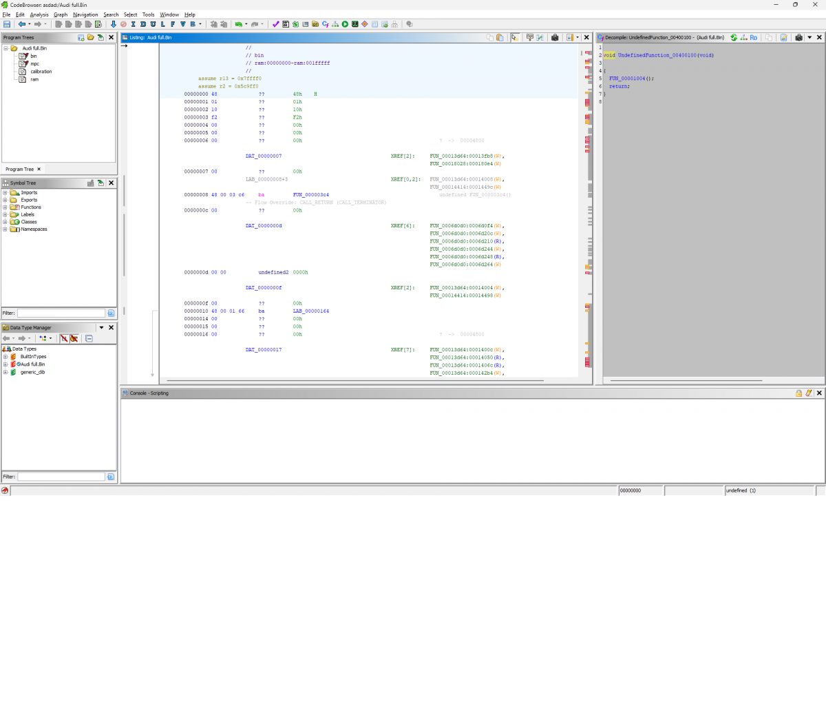

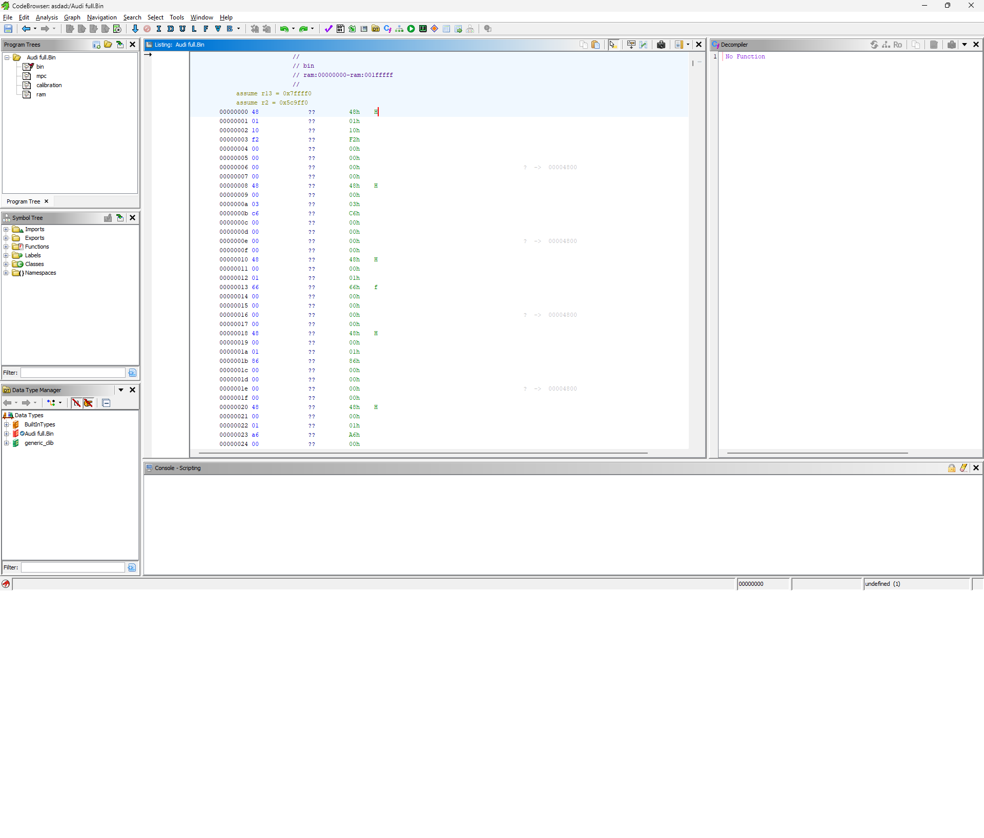

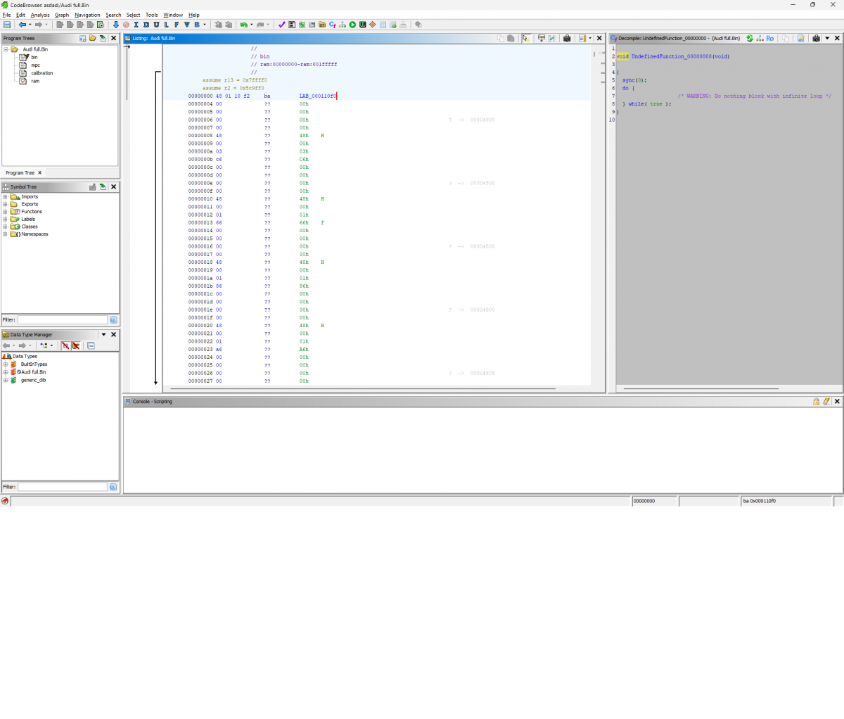

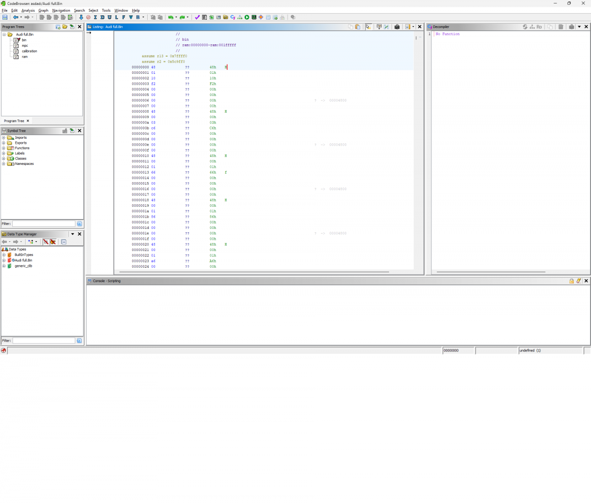

6-now everything is set to begin decompiling. before doing the automatic stuff we will help ghidra by manually setting some stuff. go to 0 and manually decompile vectors using D button. usually vectors starts with 48 00 at 0x0 address and at 400000 address (go there by typing G button).
this just means you'll go to a line such as
and observe that the next line is
so you can go to the first one that has the 48, and type D. this will turn it into LAB_address, an auto-generated label (usually a jump target within a function). you can also type D in the first lines of these sectors that show as 48 01 (this is how i did by mistake and it worked out. again, not a pro here).

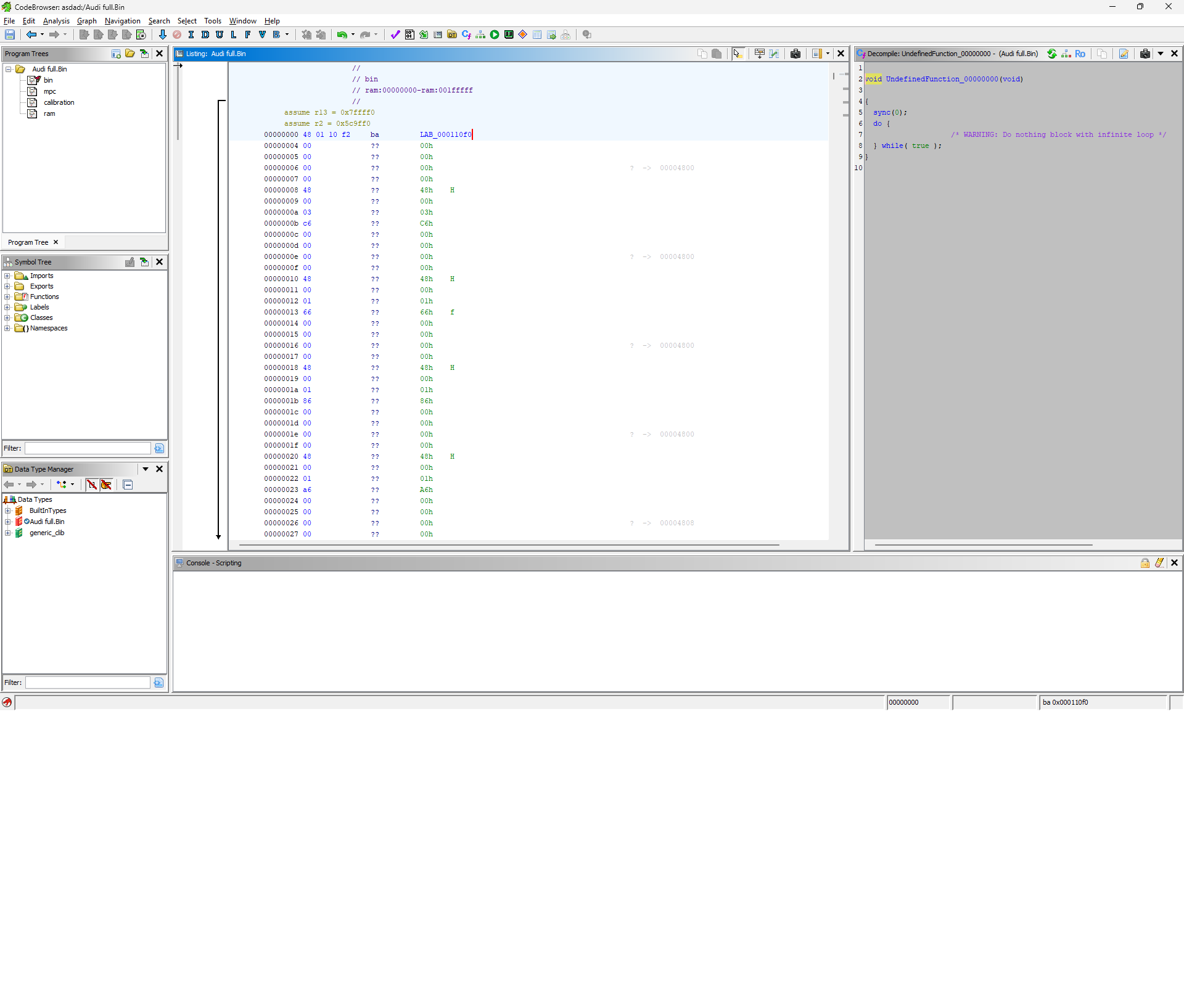

now it should look like the screenshot below, so you can go to analysis -> auto analyze, or simply type A.

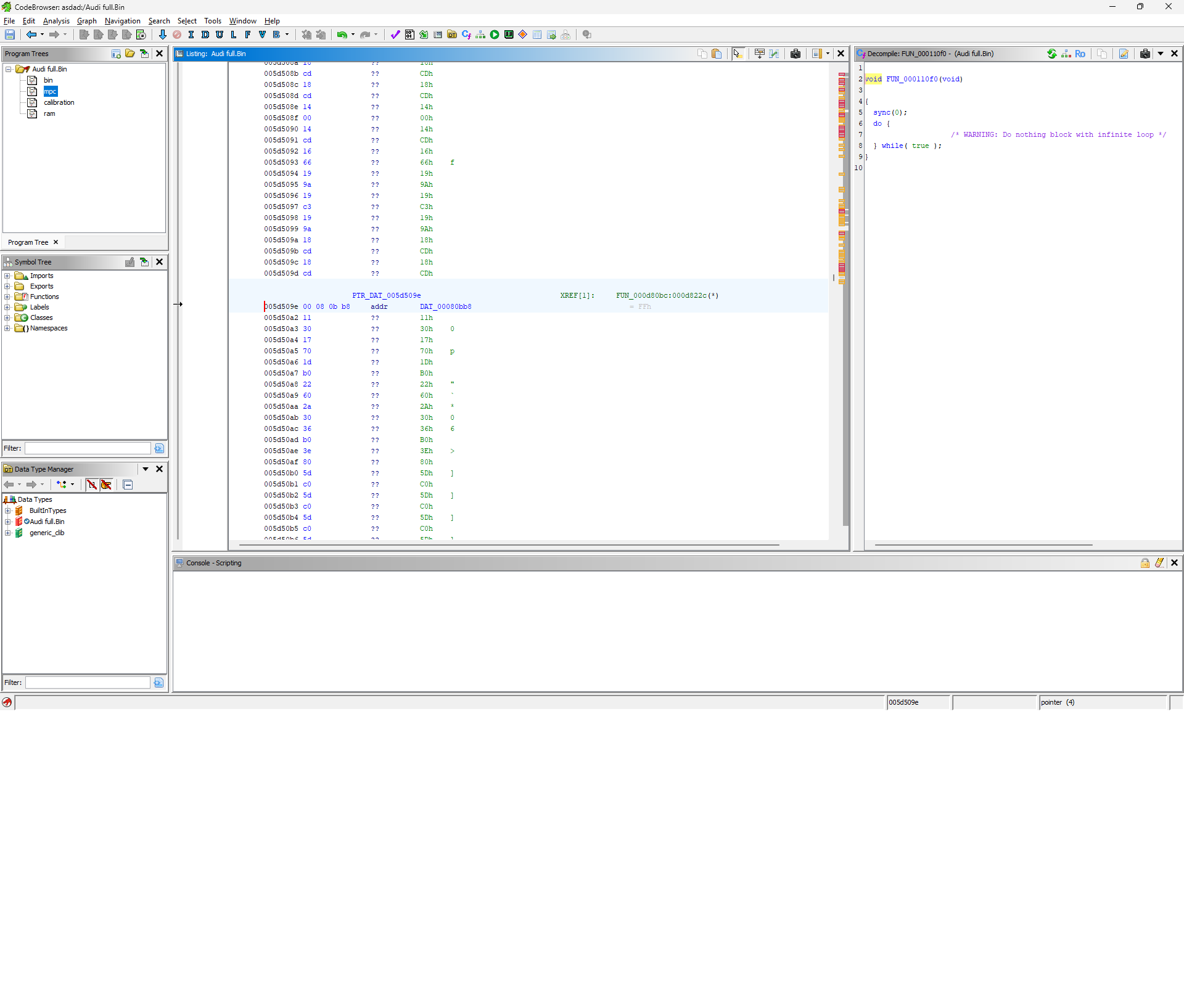

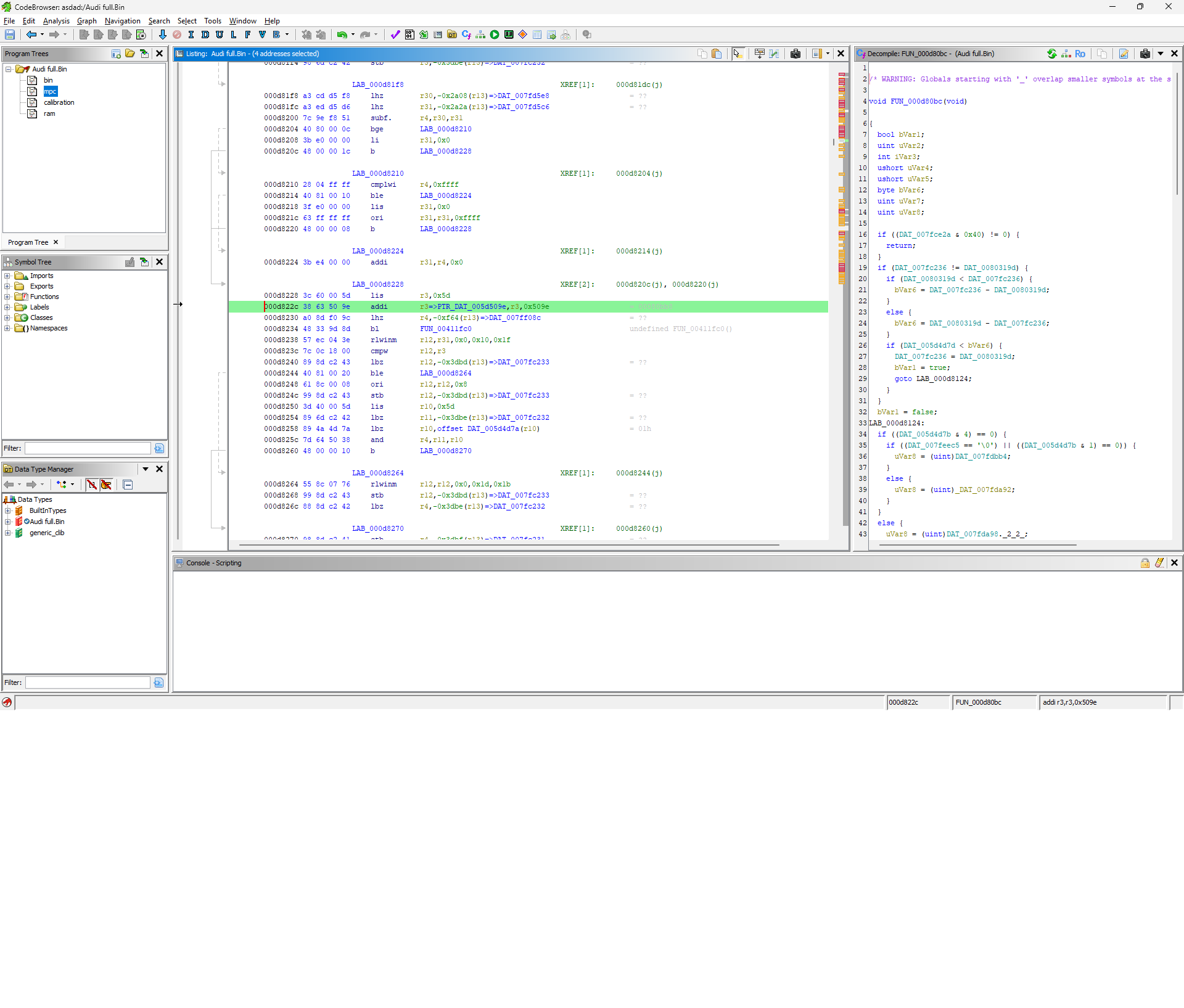

from this on, we can find the maps by comparing the addresses we have in WINOLS. for example, KLPROV (from the axis, not the actual map) is at 1D50A0. to find it in ghidra, i subtract the offset 1c2000, which gives me 130A0. then, considering i loaded it at 5c2000, we sum it, resulting in 5D50A0. type G to go to 5D50A0, which is where the actual map is (so you'll see some raw data that we dont care). by the right side, theres XREF[amount of references to this address]: FUN_function that calls it:line that contains it. double click it, and it will take you to the actual function which is what we are looking for.
00000008 48 ?? 48h HCode: Select all
00000009 00 ?? 00hYou do not have the required permissions to view the files attached to this post.
