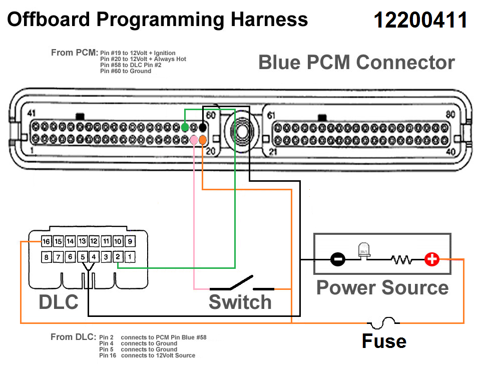

Finally had a chance to look again. Have tested the bench harness and all ok. Have tested the datalogging as you suggested and seemed to connect ok. As soon as i try to read pcm it doesn't read it. Have got OBDX Pro GT adaptor. Downloaded and installed everything again but nothing fixed it. Have tried this on another pcm and same thing. The power light on the OBDx is on red. The OBD light is flashing green and the middle one is off. I have a benchtop 20 amp power supply set at 12.8 volts and pulling 410ma with pcm on. I have it wired as per attachment
