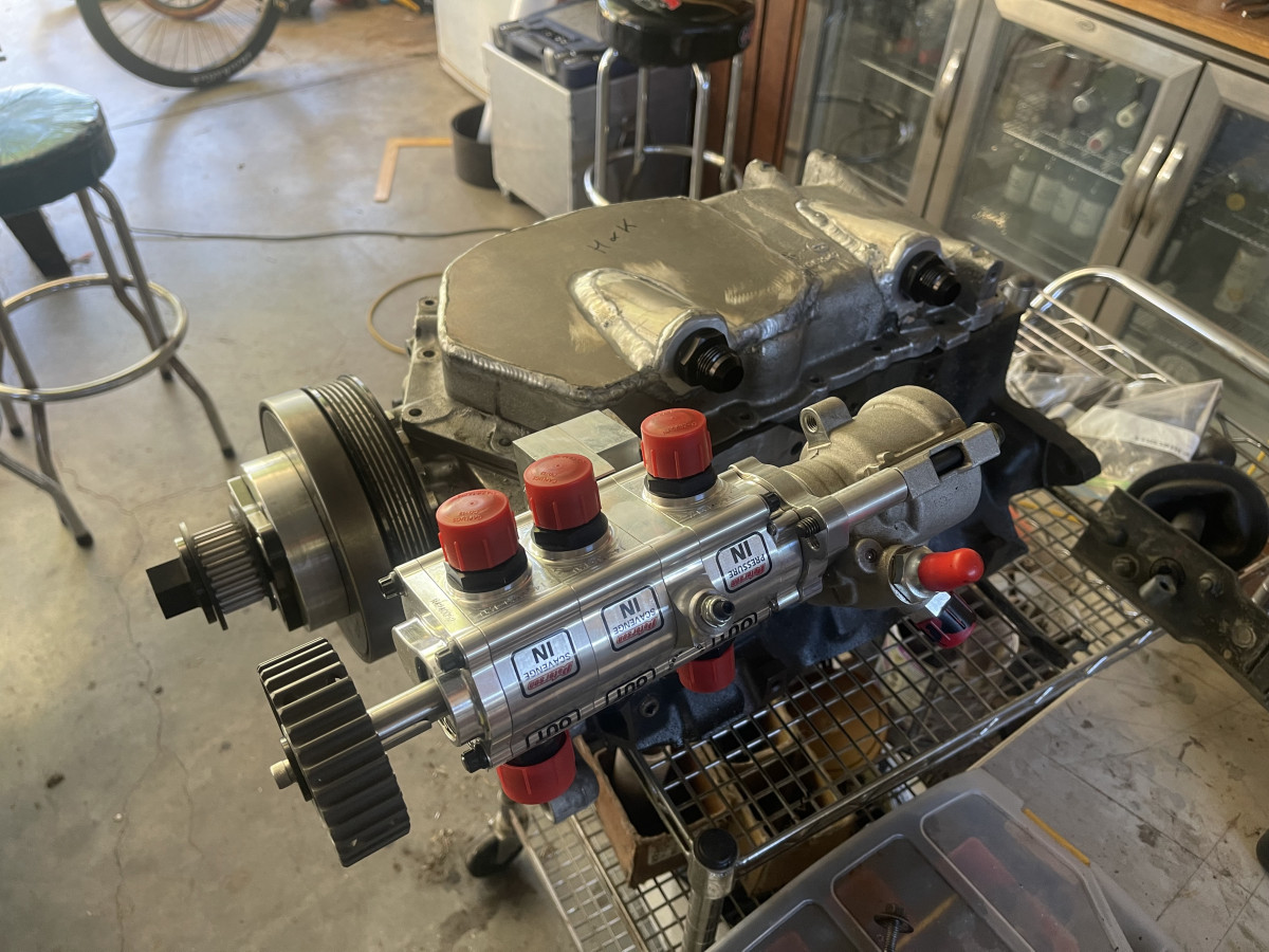

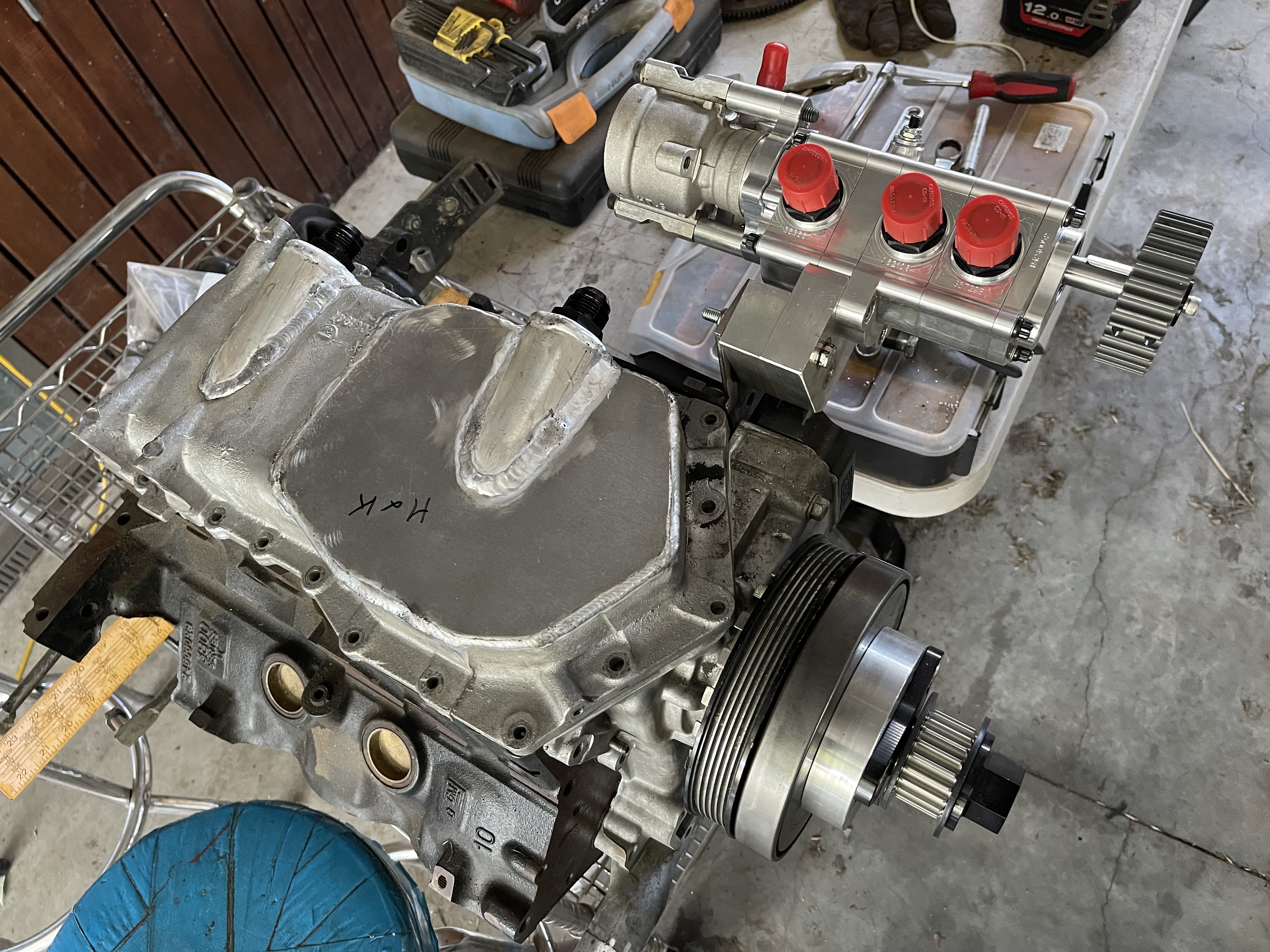

Re: Ecotec V6 Dry sump
Some more progress, now to start the plumbing.
