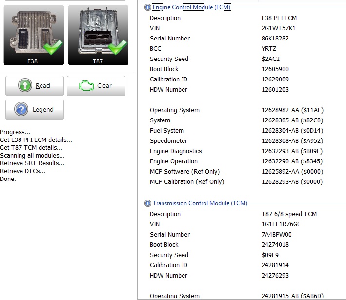

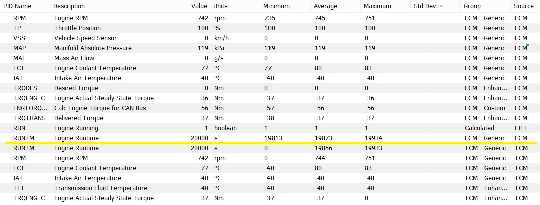

Solved this issue last fall, and tested it against an E38 on the bench, and in a vehicle.
Currently two possible ways of doing it. Both requires fudging some CANbus data. The main issue is, GM added a few more ID's to the HS GMLAN protocol over the years. And the T87 /T87A have a "Required Message List" in the firmware that it must see or it sets a U0100 hard code, and goes into a limp mode. So if we just fabricate the missing messages, inject them into the bus, all is well. Almost...
Above I said GM added ID's to the HS GMLAN protocol over the years, well they also added some byte length to some existing messages, and our new TCM's not only wants to see the ID's, they also check the Byte Length in each ID. And one of our main Engine Data ID's, 0xOC9 has grown from a 6 Byte length message on the E38 to a 8 Byte length message on the E92. They added Boost data..
So now for those of you who enjoy playing with CANbus, you'll understand the retro issue GM created into the new new hardware. It's easy to fudge some data and inject it onto a bus, but ya can't intercept and change what's already sent by another node.. Unless you put a gateway in the middle. Then your need to RX every packet, on the main bus, and filter, rebuild, and TX the required packets on the second bus that the TCM is looking for. And then do the same going back the other direction. Not something super difficult to code, just takes a lot of time, and testing to make sure it's 100% accurate handling message timing, and matches ISO and GM standards. If not, ya might have a brick fist time you go to load a tune thru a gateway and it fails. Or ceases to talk while programing the ECM.
Which bring me to the first way I did it, down and dirty hack a bin, and avoided using a full gateway. While you couldn't just write out all the "missing" required ID's from the T87 code, because some are torque related messages and rolling counters to verify everyone is in time. I was able to replicate all required messages from existing ECM CANbus data, using some captured E92 data as a guide. However the TCM still wasn't happy, and couldn't clear the U0100 code while connected to the E38. That's when I noticed some message lengths were shorter in the E38 stream than the E92. Sure enough, the TCM was counting...
Next I hit up a buddy who's pretty handy in the bin department, and ask if he though we could "Add" some bytes to an exiting CANbus ID message length for the E38. He did a little digging, sent me a couple bin's and on the second try we had it. T87 cleared the U0100 code, and runs happy on the bench with a Crank/Cam emulator firing the E38 ECM feeding all the throttle, torque, and rpm data over CANbus. So if this approach work for the E38, it should work the same for the E67. And the only hardware required was a teensy with a CANbus transceiver..
So now that we know it can be done by modifying the ECM bin, next we are going to try it by modifying the TCM bin. Couple simple tweaks there and it should work just the same, but requiring a customer TCM bin rather than the ECM bin. And for the CANbus hardware, believe we need to add some extras like P/N output signal, VSS output signal, reverse light, and probably a mode and tap-shift input channels. Think that should cover the stand alone builds. And the same hardware should work with T87A on a 10L90. Actually that's what I tested the CANbus code on..

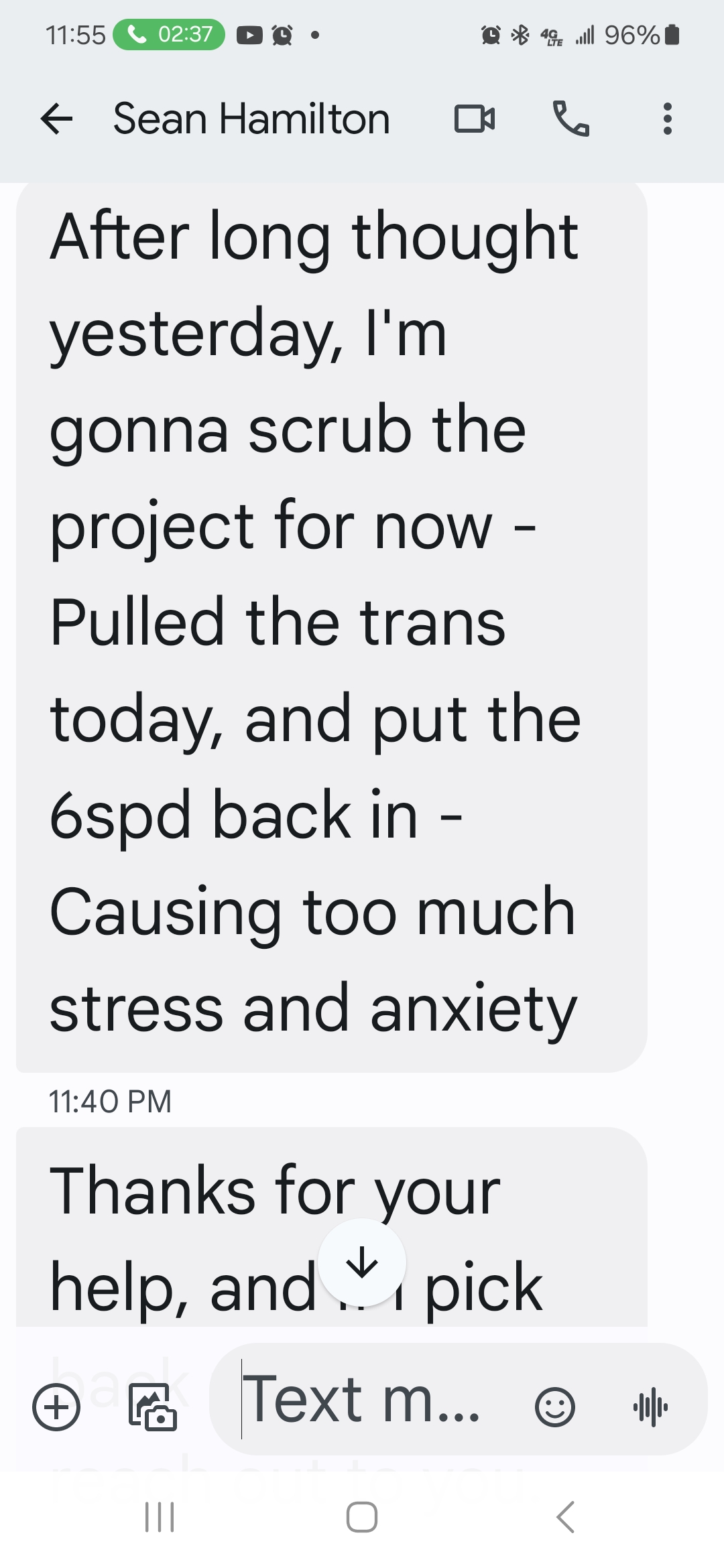

That's actually the same guy I tested this with live last November. Same one I supplied the custom Teensy board with the running code, test drove his truck with the 10L80, then suddenly claimed he wasn't interested perusing this project any further.. Didn't even offer to kiss me...Tre-Cool wrote: ↑Tue Apr 23, 2024 12:59 am very interesting stuff about the can byte counts needing to be longer.

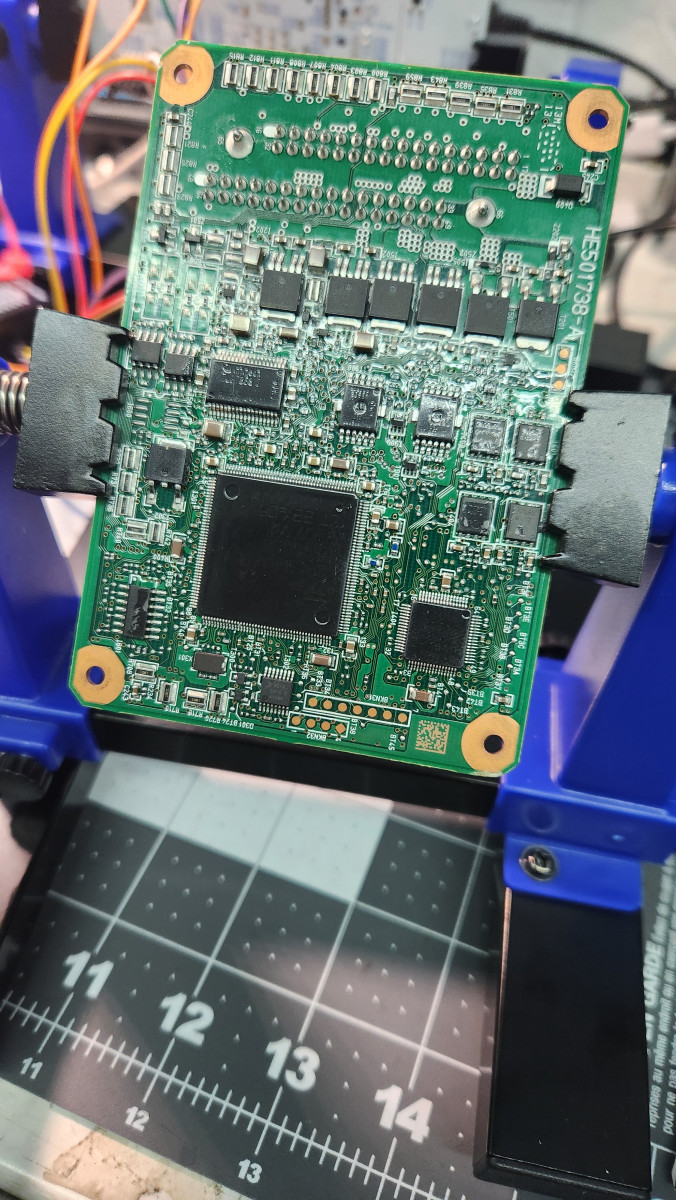

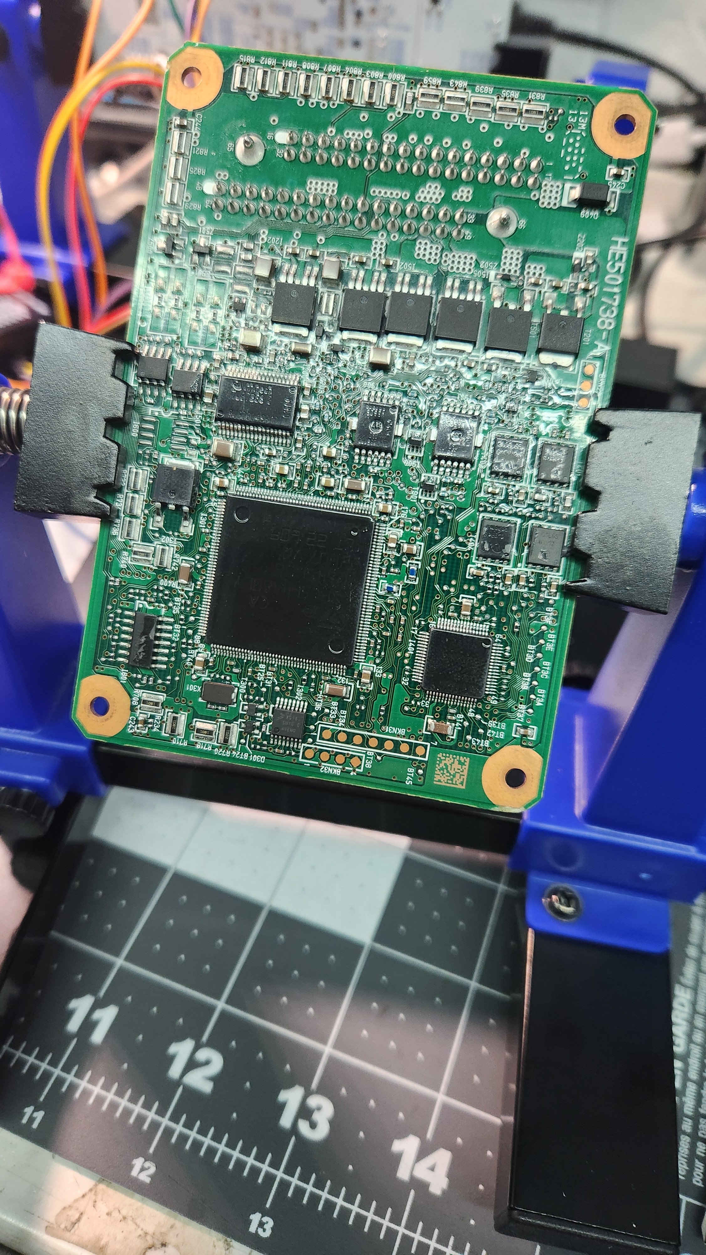

I haven't cracked open a 87A yet, but have a 87 in front of me now that I've been getting mid-evil on for a few months, and just busted it free from it's enclosure. Pretty rugged little board, with a good STM processor. The hardest thing to hack has been the new style shaft speed and VSS parts. But I got it going now where I can run a old VR sensor against the new Square wave pulse the T87's require.. And that wasn't the 20 minute converter chip fix anyone who knows hall sensors would have guessed. So be keeping that one as my secret for now.. LOl..

Seriously?kidturbo wrote: ↑Tue Apr 23, 2024 11:34 am That's actually the same guy I tested this with live last November. Same one I supplied the custom Teensy board with the running code, test drove his truck with the 10L80, then suddenly claimed he wasn't interested perusing this project any further.. Didn't even offer to kiss me...![]()
So.. monitored what you were doing then just took off ?
