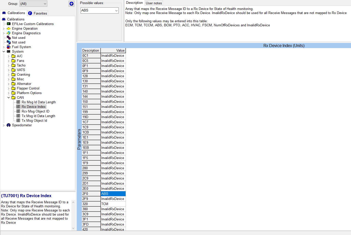

Ah too funny.. Looked like they added actual additional new table list at first glance.. :wall:
You are on the correct track, however working on the wrong device I feel... As mentioned those seem to be the separated list I fond in that early OS, and are the switches between the Corvette and Standard OS versions. Would allow you to disable or enable the current list of broadcasted ID's. But this is can also be accomplished by switching to a Corvette OS release, which flips those switches for ya. But year related Issue is we need to Add to that existing list if we want to run against newer TCM OS versions.. Or we tell the TCM to not require our E38 missing ID's. Easier.. But you have the proper approach going on.
For those of us who play nicely with others and don't plagiarize, might have a complete Global A dbc, and thus the ability to regenerate all these networked messages on the bench. While knowing exactly what each bit is for and does. Then ya take recorded CAN data from XXXX year / model vehicle, hack it up to build a short msg file, then we play that back against our target ECM, TCM, BCM of choice. If ya do it right, the node will tell you happy or not per msg back over CANbus, and actually give you the exact reason if it isn't under some other ID's. If ya have the matching A2l, one can take said response and go digging for that exact line where it's unhappy. Easy...
So that's our basic approach required to matching up nodes across 25 years. GM didn't delete much, they just added to the stack. Replicating the missing data is easy, modifying existing data packets requires a different approach.

Eventually I'll shoot some of my cax files over to Paul @ efilive to include in the standard calz files as i've added a bunch of parameters for e38 & t42/43, at least for the oses we got for in our holden calibrations.
I think there might be some guys in the states that already have some of what i have in their own cax files who specialize in doing conversions etc, so hopefully they don't get too upset once the update goes out, but i think a majority of tuners there appear to use HPT. I have it also, but it's more a last resort thing.
I'll happily confess to say that im no code guru, people share stuff with me to help me on a path & then I start looking for similar patterns of data in other files.
Those can tx/rx stuff i added as something to experiment with, i'm happy to play Guinee pig on my stuff, im certainly capable of self funding my experimentation & willing to share my testing etc.

so as a point that im continually learning.. all those can message id stuff i did line by line into a cax file, so lots of copy/paste with their own ID.
30 minutes ago i just worked out how to do it in 1 & feel like an clever fucker & an idiot at the same time.
Eventually i'll get my shit together & just do them in the V8 editor, but i still like to use 7.5

Bump these off that list. :D
0x0F9 Trans_General_Status_1
0x199 Trans_Torque_Request_HS
0x1F5 Trans_General_Status_2
0x4C9 Trans_General_Status_3
Have any good CANbus captures off a Holden car?

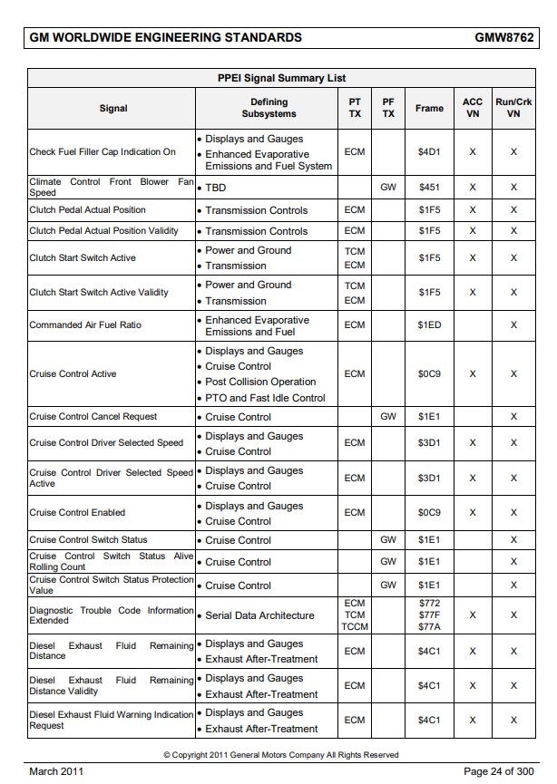

before i purchase a bunch of other pdf's does anyone have a copy of the GMW8763-8781 doc's?
hjtrbo
Posts: 227
Joined: Tue Jul 06, 2021 6:57 pm
cars: VF2 R8 LSA
FG XR6T
HJ Ute w/RB25DET
Re: E67 to T87/T87A TCM interface needed
Post by hjtrbo »
I've got 8777 if you need it.
